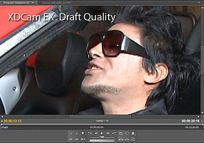

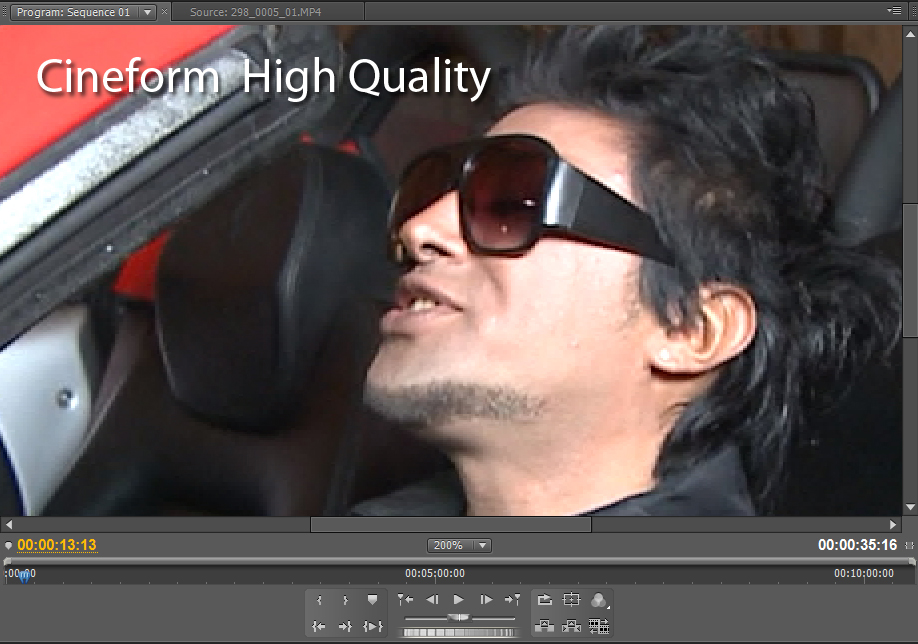

There are modes? I converted the files using HDLink, was given no options to any modes. If you are talking about Highest Quality vs Draft Quality in the PPro playback, the XDCam files play realtime no rendering in HQ. Cineform Files barelly manage to keep all frames in Draft Mode. Here are some screenshots to show what I see when the timeline is paused.
While Cineform provides better transitions from the red color, basically everything else suffers.

The has nothing to do with the codec. That is simply Premiere preview scaling, has no baring on anything really. Load both clips in VirtualDub, or AfterEffects some you can control the scaling on (as XDCAM does work in VirtualDub export to uncompressed.) Many >100% scales in NLE preview windows are terrible, designed for speed not quality -- that is one of many reasons why pros use HDSDI cards for monitoring, the program window is neither color or resolution accurate. If you don't have HDSDI, and want to see up close with Premiere preview, set 100% then set the motion filter to 200% (at least the interpolation filter is better in motion.) If you still think there is something gone wrong with the codec, you are most likely making an error elsewhere, many have tried and failed to make such a case -- this is battle tested all the way to the best picture Oscar in 2009. Now I will admit CS4 support is poor, CS3 is fast (Prospect HD) and CS5 is fast (with the Neo v5 line), CS4 is what it is with Premiere desktop playback mode (never ported the accelerator.) CS4 does XDCAM well, so stick with it is you don't need higher finishing quality.
