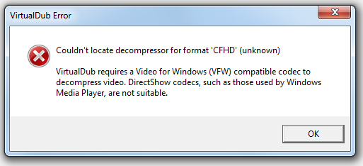

Posts: 136
this is what I get when loading cineform files
Nik Skjoth is offline   Reply With Quote

You clearly you don't have a working CineForm install as VirtualDub works with the simpliest install from the free decoder all way to Neo3D. Contact support.

Yeah.. obviously the thing that happened was that I uninstalled Cineform before installing Visualdub. When opening Media player suddently I got a "Medialooks" Icon embedded in the videos???. I was ready to throw in the towel, so after reinstalling Cineform and visualdub again, it worked.. But what kind of realization am I supposed to get from this.. Yeah the vid looks fine in visualdub.. so? I cant edit there.

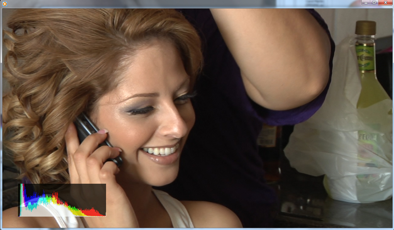

I played around with First Light, and I liked what I saw. But the program was a little too glitchy, so I uninstalled it and reinstalled NeoScene. But now I'm getting that color histogram thingy showing up on all my video clips, no matter where I open them (Vegas, Media Player, etc). I thought that would go away when uninstalling NeoHD?
D.R. Gates is offline   Reply With Quote
Old April 22nd, 2010, 05:49 AM   #45
Location: Bakersfield, CA
Posts: 111
Wow, that histogram is really getting on my nerves. I removed every single Cineform file on my computer and did a system restore. That dumb thing is still showing up on any video I watch.
