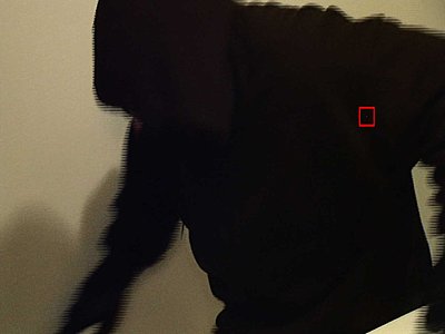

Here's an example of where mine shows up. It's not nearly as bright, but it's rather persistent once it appears.

Cheers for that David. Looks like you caught a burglar trying to make a getaway in that shot.
The example of my white dot is, I admit, the worst its ever been. Sometimes it's only about as bright as yours. BUT, if there was a chance it would reappear as bright as that, then obviously I had to do something about it.
The weird thing was, that in assembling a range of clips to put on DVD to send to JVC with the camera, I noticed that when this particular clip faded in from black, it was only a second or so afterwards when the white dot 'pinged' into view. Very odd.
The chap in the shop said, "oh it'll be a dead pixel" but if there's 3 CCDs, then it would have to be the same on all three surely? and then it would also be evident ALL the time, not just when the camera got hot.
That's my bogus theory anyway. We'll wait and see what JVC say about it, if anything.
