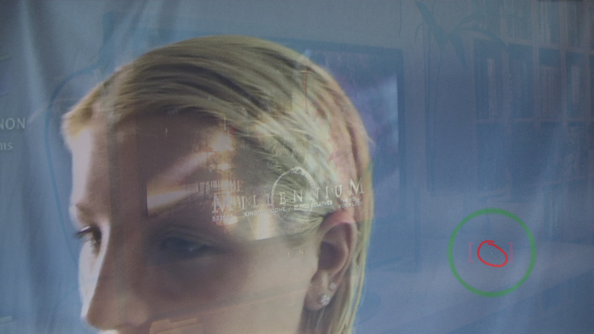

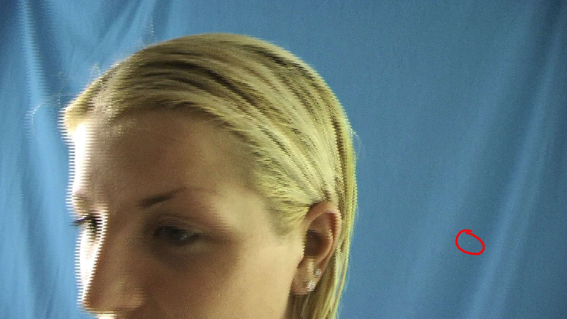

Old August 16th, 2008, 10:12 PM   #57
Location: Utrecht, The Netherlands
Posts: 15
*sigh*... Was just reviewing some shots from 2 weeks ago, and guess what... A white dot in the bottom right corner!
Demo screenshot is from some testing stuff and unedited, hence the awful color and interlacing. The second picture is three screenshots overlayed showing the location of the white dot is exactly the same as before.
