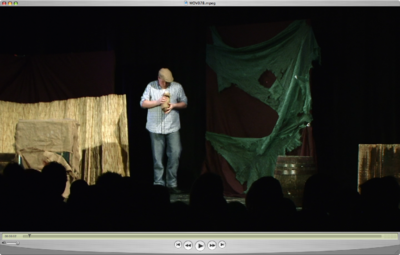

Glad I found this forum and this post! I just got the GZ HD7 camera a week ago and noticed the white dot in some of my test shots. The heat thing could be it, because the dot only showed up after while (it wasn't there in the first few shots I made).
Here's a screenshot I took with VLC. Is the dot at the same location as with your cameras?
Same happened with video also? I am afraid I am using it since last more than one year but never noticed!

Mine is a little more to the right, but about the same distance from the top.
I'll post an example later when I figure out how to do it.
