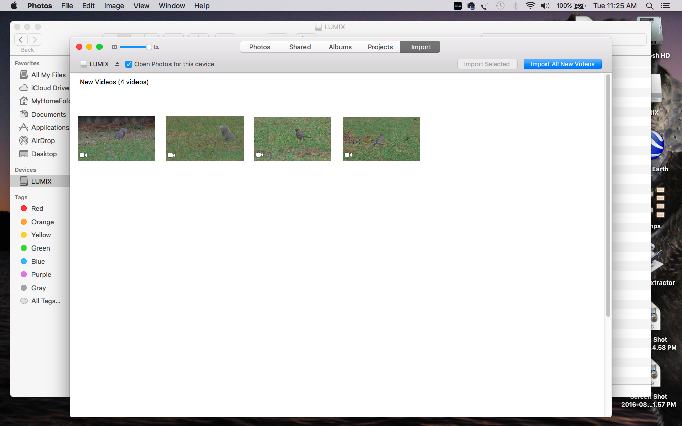

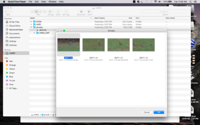

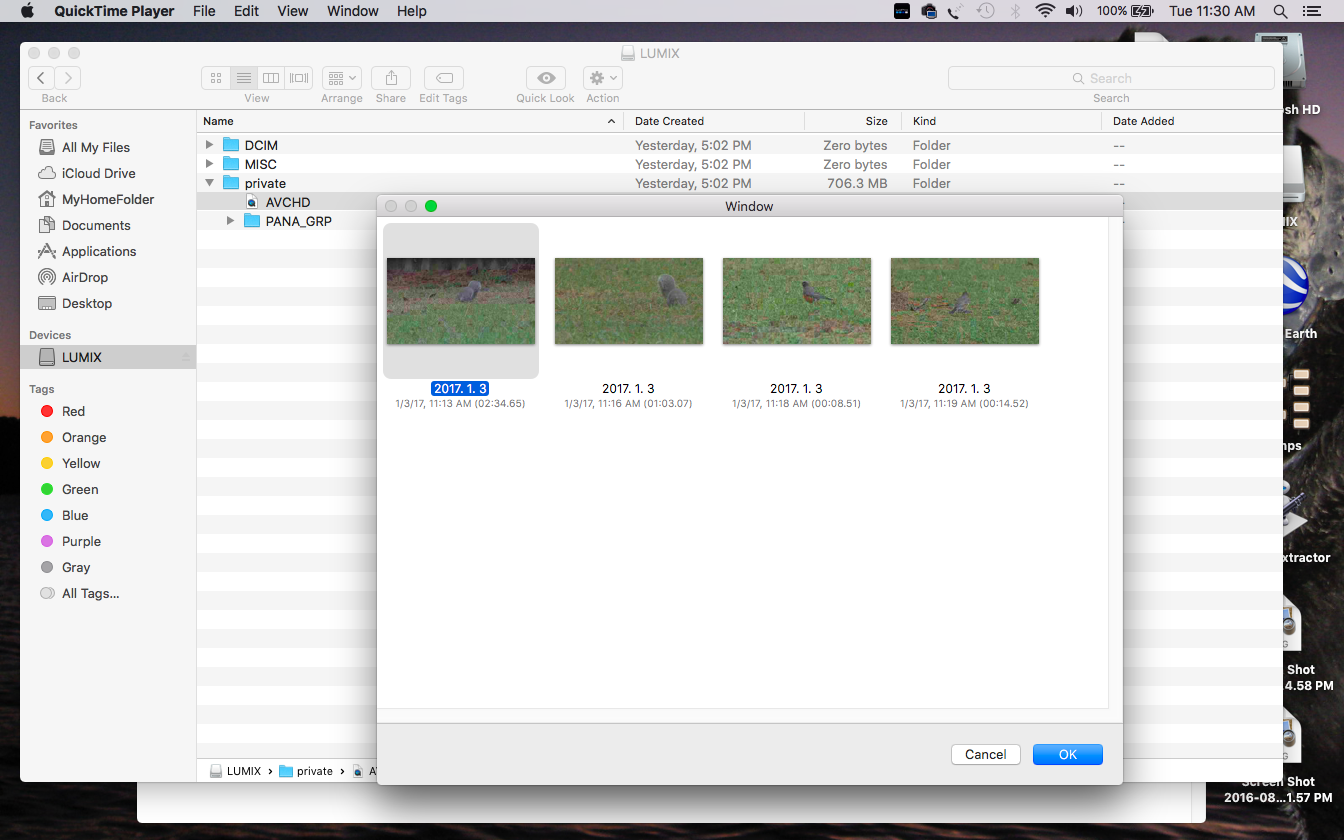

Thanks for the info about bitrates. That helps. Recorded a clip this morning in AVCHD 24m/30p just to get familiar with the camera. Great quality, with VFR. Files don't download like they do with my canon. Anyone with a mac that can assist? When downloading MP4 recordings from my canon I get files, with names, that I can easily import into Lightroom. When downloading from the Lumix all I get are movie icons that can apparently only be imported into Apple's Movie software. These screenshots may help explain it better:

I don't use Macs apart from the iPad, so am probably missing something here, but it looks like you are opening the files as photos rather than video. Are you not using a Mac video editing programme to view your files? For example I wouldn't be viewing my Panasonic video files in Photoshop on my PC.
