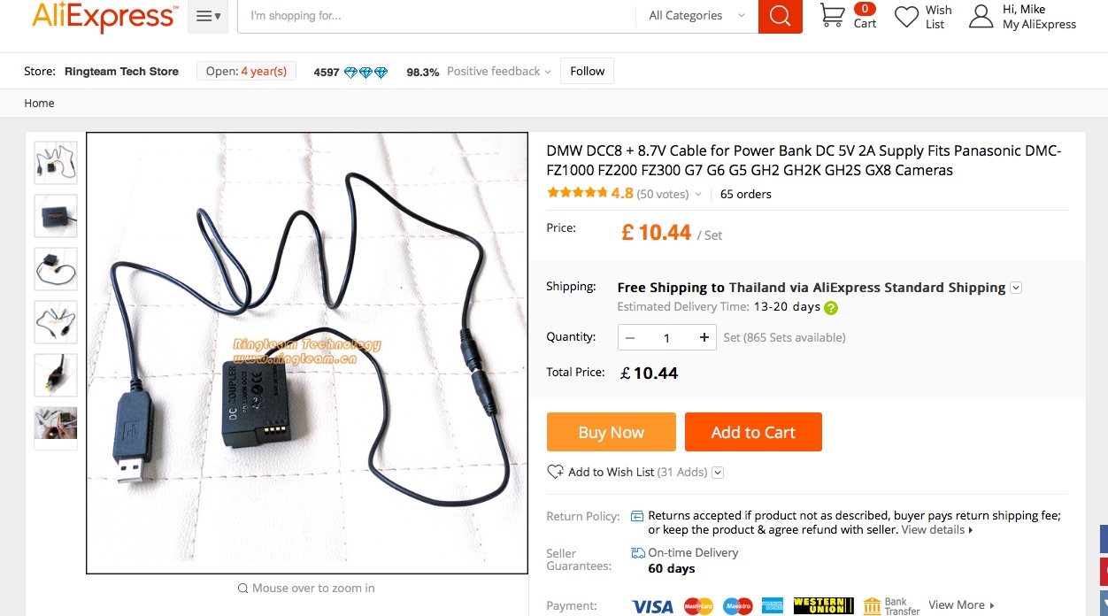

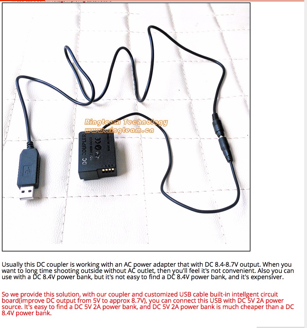

I've ordered one of these from aliexpress. It claims that if you attach a 5V 2A battery ( the sort used to power phones) it will output 8.4V and with the dummy battery fool the FZ into thinking it's attached to the main supply. Just choose a suitable battery and it should all work. I'll let you know ( Chris, a friend of mine is making up your version, your insturctions are great he says) ( I'm not sure if the files are attaching)

Thanks Mike
According to specs the battery must have an onload voltage of 8.2v so it will be interesting to see how they manage to get a 5v spec battery to deliver over 8v ...if it drops below 7.2 the camera will reject it that's why I made mine using a 12v pack and then the voltage regulator to set it between 8.2 and 8.4
Do they also supply a charger with this one?

TheDC coupler provides 8.4-8.7 V output. It ends in a USB connection which is plugged into a powerbank

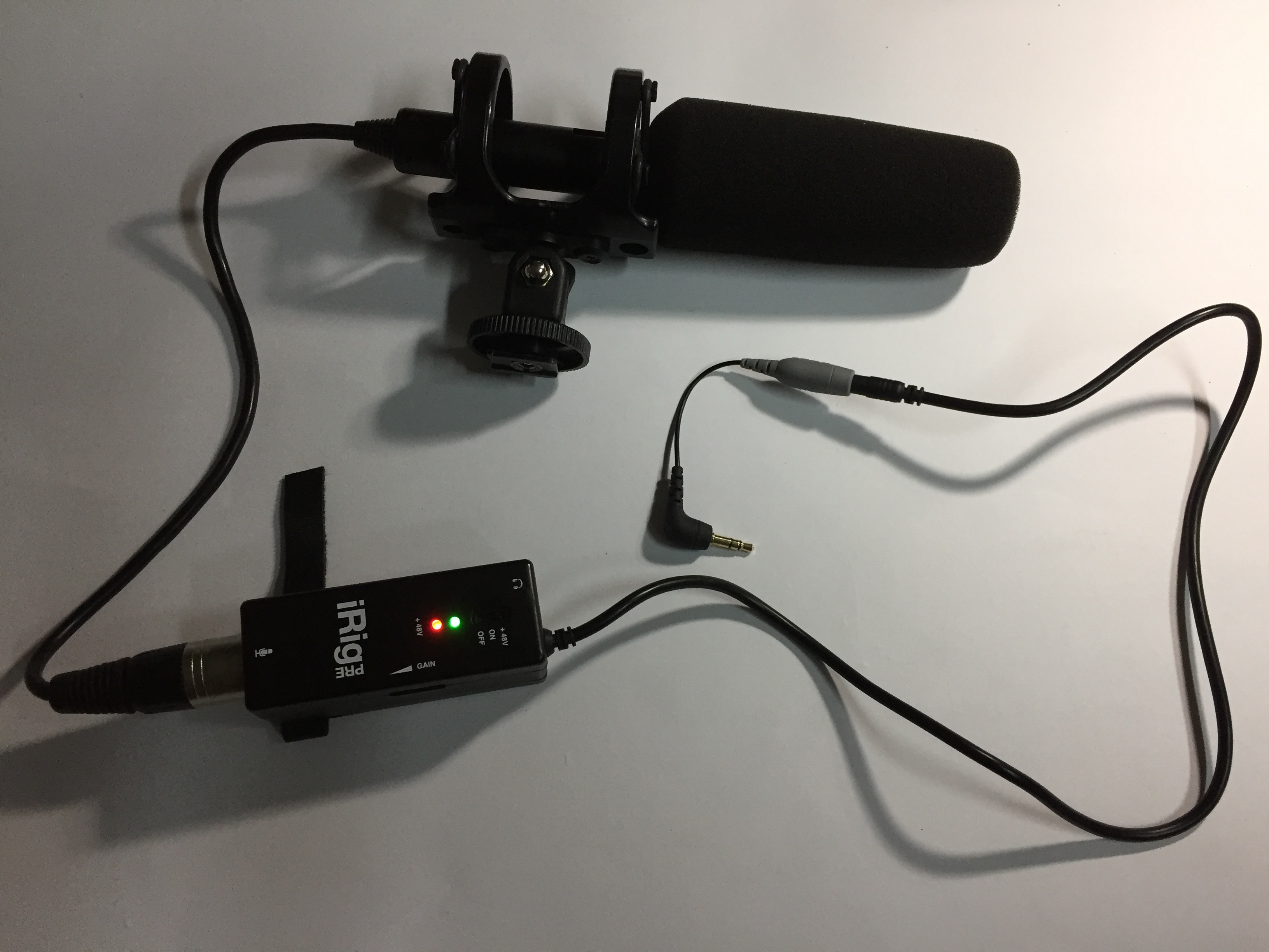

And another. If you want to use an XLR mic on the FZ you can quite cheaply.
The photo shows an XLR mic in a suspension sytem attached to an iRig Pre and then a Rode LC3 TRRS to TRS adaptor.
The iRig has a gain control and 48V phantom power.
This should mean that you can run an XLR cable some distance and still connect to the FZ. It's cheap, the iRig is around £40, the LC3 about £6 and the rest is up to you. The preamp in the iRig seems OK but I m no expert, but listening to the sound on my Mac it sounds great

Thanks Mike
Ok I see what they are doing ..so taking the 5v from any powerbank unit boosting it to 8.7 and sending that into the DC coupler ....I assume you have ordered it? If so, let me know how it works??

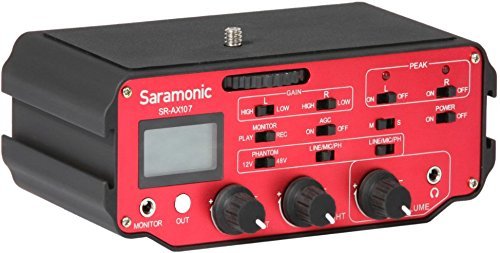

The Phantom unit is neat too ..I have a Saramonic AX107 XLR adapter under my main camera which gives me dual channel, audio peaking, mic or line inputs and of course phantom power too.

Well the adaptor finally arrived from Aliexpress. Unfortunately the powerbank I bought ,although claiming to be 2.1 amp. does not provide enough current, the lens tries to open and fails. But plugging the USB into the ouptut on a USB hub attached to my iMac and yippee! it works. The trick seems to be to find a powerbank with enough current. I'll keep trying
