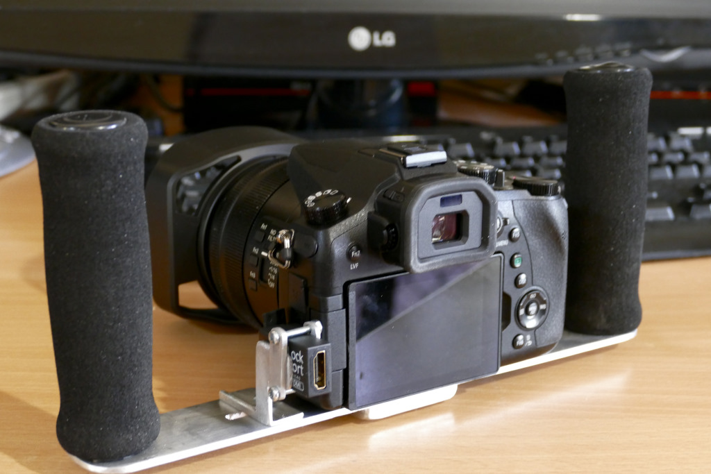

I did have an issue with the micro HDMI ports on my FZ1000's which became damaged when a bad cable bent the tiny pins so on the FZ2500 I have a much better device called a Lock Port which makes the micro port into a full sized one and you can anchor it securely to the base ... LockPort have the hardware to suit a GH4 if you don't use a rig of any sort but all our cameras have an aluminium flat bar under the camera with two foam grips either side so I make a simple clamp for the Lock Port so I can be as rough as I like with the cable and the tiny micro port won't get damaged.
