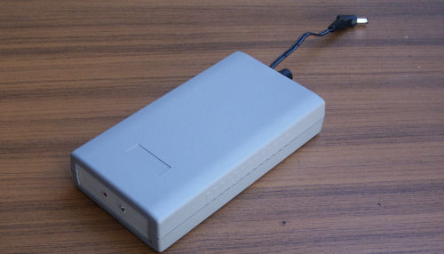

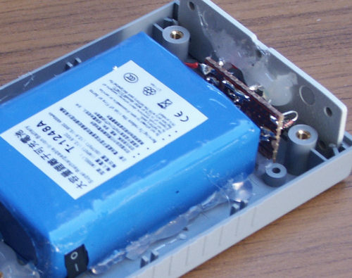

Thanks for that ..I get an hour continuous quite easily on my FZ1000's which have the same battery. Did you know that you can also use a DC Coupler (no mains supply) and connect that to a biiger Li-Ion pack?? As long as the input voltage is 8.2 or higher the camera won't reject the battery as "non genuine" as it thinks it's getting mains power. You can get 12V Li_ion CCTV battery packs up to 9000mah on eBay but of course you would need a simple voltage regulator circuit to keep the output at 8.2 not 12 ....Cameras will run all night on that!!!

Just remember it MUST be 8.2volt output otherwise the came will come up with the "This Battery Cannot be Used" error ....that's why you cannot use a normal 7.2 volt battery as it expects a decoded battery ...if the camera "sees" 8.2 or more then it assumes mains is being used and will run fine. I put my battery into a neat plastic box from Jaycar electronics and wired in the voltage regulator kit inside too.

If it helps at all, I also made a little tutorial on the battery pack ..it also has a built-in led level meter which can be ignored ...my local guys never had any voltage regulator kits so I made my own on a piece of veroboard.
