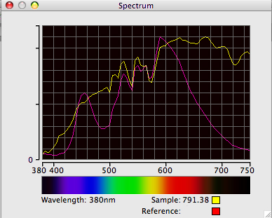

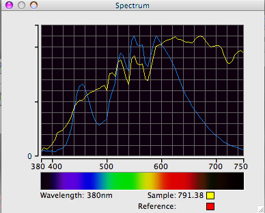

Here's a spectral analysis of the Cool Lights LED compared to daylight.
The yellow line on both graphs is daylight. Full sun.
One graph has a blue line. That's the Cool Lights LED without any filtration. Note that it doesn't have a green spike that's common to a lot of fluorescent lights from 540 to 560 nanometers. From 515 to 585 nm the characteristics are pretty close to daylight.
Note how the longer wavelengths beyond 600 nanometers start to drop off. That's the red part of the spectrum.
If it's noticable in the footage (I haven't shot with it yet so can't say if it matters), white balancing a camera might compensate for the reduction of red in the light source. It might also be accomplished by increasing the red saturation in post. Video tends to saturate red quickly, so this probably won't be much of a problem for most cameras.
The other graph has a magenta line. This what the Cool Lights LED looks like with a 1/2 minus green filter in place (Lee 248). The range from 515 to 585 nm is a lot closer to daylight with a better match in the middle of that range. It also helps extend the lower end of the spectrum, beyond 600 nm, just a tiny bit.
Overall, the "look" of the light is cool, a bit cooler than the FloLight LED. But in terms of spectral qualities, both lights are very similar.

All that's about what I'd expect. Good work Dean. Like we've been saying LEDs aren't full spectrum. Another way to put what Dean said, to make the LEDs mix more with other light sources and simulate full spectrum a bit more, they need a bit of minus green to do that. Pretty much all daylight 5mm LEDs will at this point.
