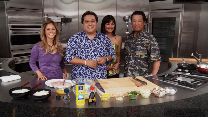

Here's a frame grab from the cooking demo.
The room had a fair amount of daylight coming in through huge picture windows behind the camera. All indirect sunlight.
The Cool Lights were used to provide some "direction" to the lighting, placed on either side of the camera with 1/2 minus green gel.
This shot was color-corrected with Apple's Color. Some slight gradient added to the top and side margins to draw attention toward the center of the shot.
BTW: even though the LED lights are missing a lot of the spectrum with wavelengths longer than 600 nm, they still looked good to me. No weird highlights or shadows. And after we worked this site for four hours, we could pack up the lights right away without having to wait for them to cool off!

Are you in front of the camera or behind it Dean?
