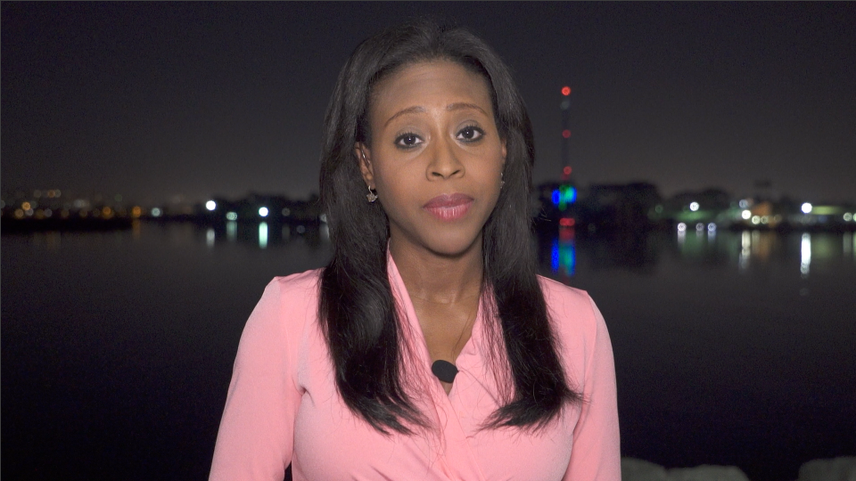

Just did my first A7s broadcast live shot with a reporter last night. Hooked up my little Sennheiser AVX, so convenient, and dimmed down my large LED to just about nothingness.......I was at something like 20000 ISO? The reporter said that she needed more light, she was used to being hit with illumination necessary for a crappy JVC ProHD camera. One issue I ran into was trying to white balance my reporter.......have to go into still photo mode, really?
Anyway, when I figure out how to edit a Windows .wtc (media center) file in FCPX, I will post the live shot, but for now, what it looked like below.

Thank you Handbrake! Here it is.

Nice job. So it can be used as a ENG camera with no problem.

Looks great Paul. Is that REC709?

PP5 Cine 1, with a little in camera saturation bump and -2 on the master black. The REC709 PP4 looks a bit too cartoonish to me, too colorful.
