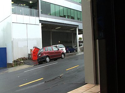

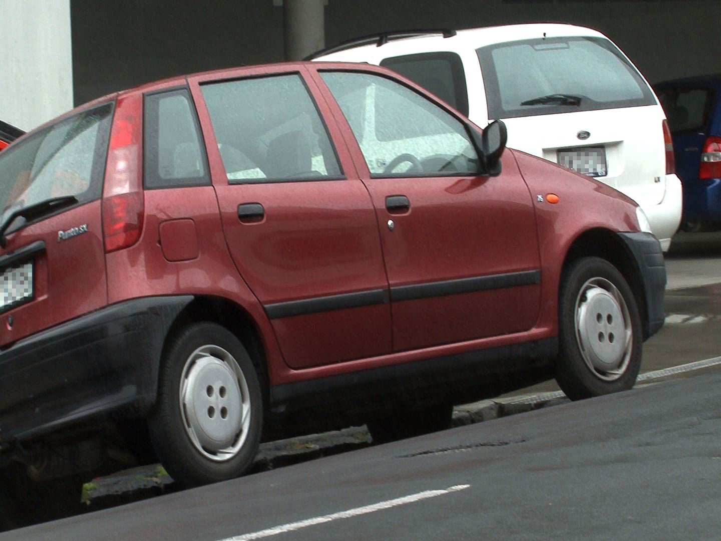

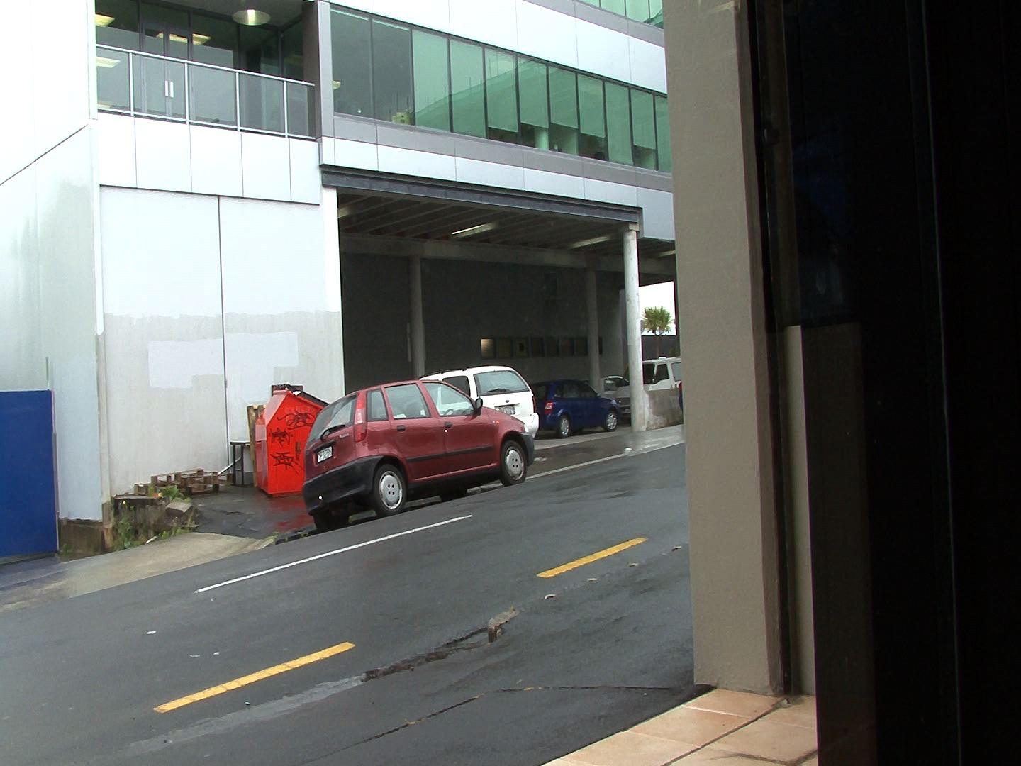

V1P HDV capture into final cut pro.
Handheld - Not the best cinematography in the world. Don't flame me. I only work here.
Sequence setting is HDV 1080 50i - CAPTURE is only able to be set to HDV, so footage can only be brought in 1080 50i...which is how the camera records anyway, so no worries. When set to HDV 1080 25p footage requires rendering...not good so not done*
On playback it looks okay to me.
*NOTE - CAMERA SET TO 25P RECORDING*
