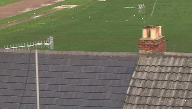

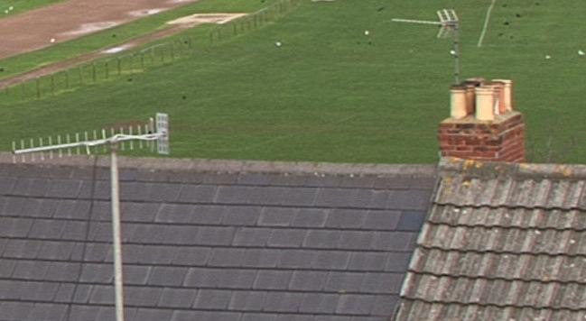

Okay, okay I submit.
Exported from FCP as 1440x1080 BMP resized in GIMPshop to 1920x1080.
I have done nothing else to the files.
Detail is washed from the grass and destroyed around the aerials. Is that or is that not the "oil paint" effect you saw Simon???
Sorry it is such a mundane image but it absolutely shows the problem.
TT
Cut out a section from each picture.
V1 25p issues (combined threads)-section_int.jpg   V1 25p issues (combined threads)-section_prog.jpg
