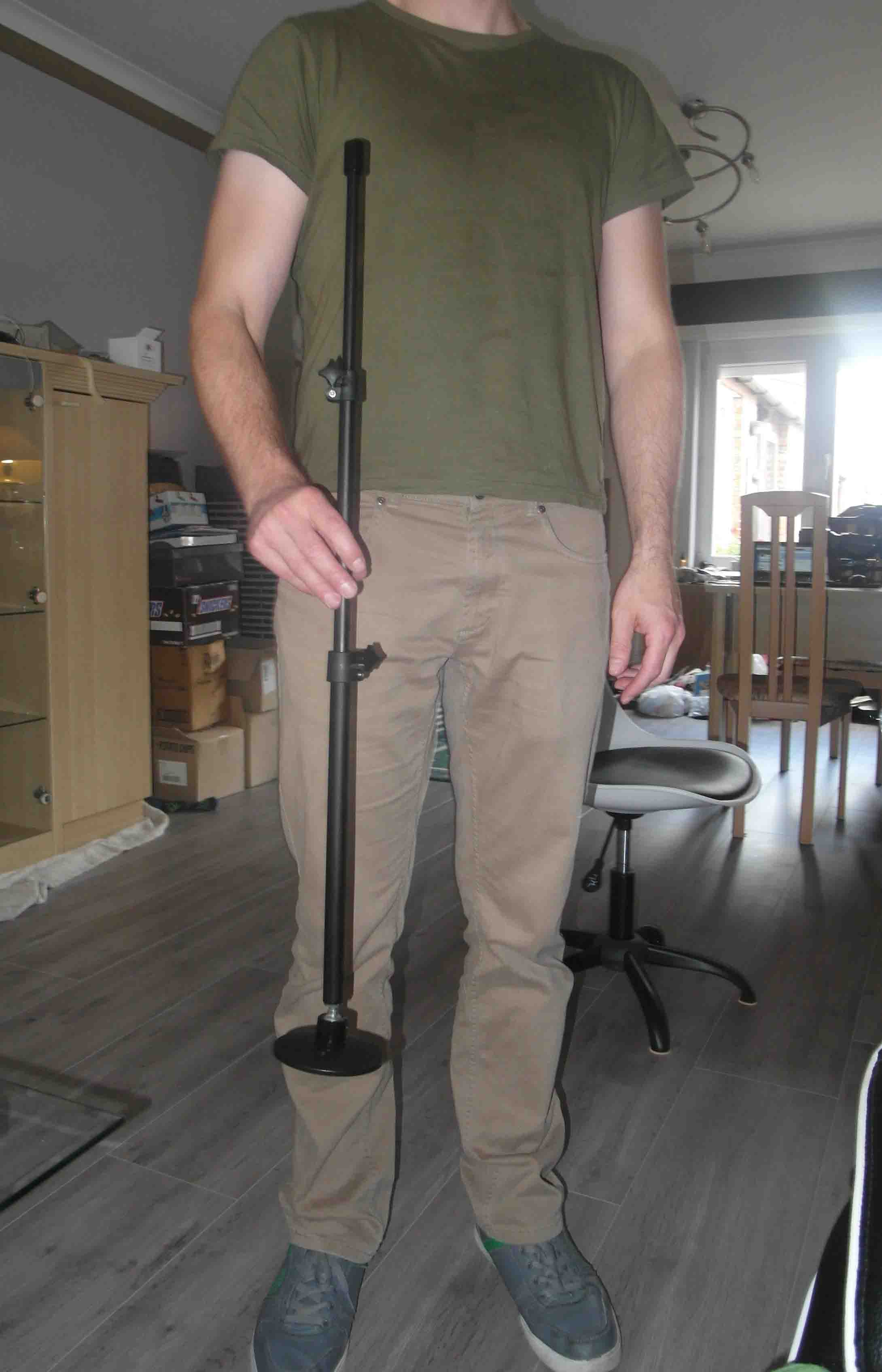

hey Chris,
look what I got! Yes, the camtree rod. looks very good to me but like you said it's too long.
Can you tell me with a picture where to cut off please?
thx!
Tom Van den Berghe is offline   Reply With Quote

Old August 31st, 2014, 06:26 PM   #30
Posts: 8,441
Re: Saved by the Rod!
Hi Tom
Ok here is the routine to make that piece shorter.
(1) Unscrew the flexi-joint so you have just the plastic fitting attached to the rod.
(2) look at the top few millimetres of the rod and you will see a pin securing it to the top tube. Use a nail and a light hammer to simply drive it out (the hole goes right thru)
(3) Pull out the plastic fitting and you will see the top is the fat bit and the end piece is the thinner piece that went inside the top tube.
(4) Drill a 5mm hole right thru from top to bottom ...it's already drilled 3/4 way so just continue the hole so it exits out the skinny bit at the bottom.
(5) Use a 1/4"BSW tap (cheap at the hardware store) and cut a thread starting at the thin end where your drill bit came out and turn the tap in until a thread has been cut the length of the thin section only.
(6) Use a hacksaw to cut off just the thin section and wack it back into the top tube and because you have a thread going thru the middle now ..screw the flexi-joint into that and discard the fat section of plastic
Voila ..your rod is now around 3" shorter!! and is great to use!!
Also remember that I actually have scrapped the bottom plastic plate and it's ball joint too! My rod has nothing on the end at all (except for the thread where the ball threaded piece went in) Instead on the belt part I have a cheap "L" shaped shelf bracket that also drops everything lower down ...I have a standard mini ball head bolted to the piece of the bracket that sticks out and on top of the mini ball head is a piece of plastic PVC pipe that acts as a receiver for the rod. There is a pic on post #6 of this very thread so you can see how I have done it.
