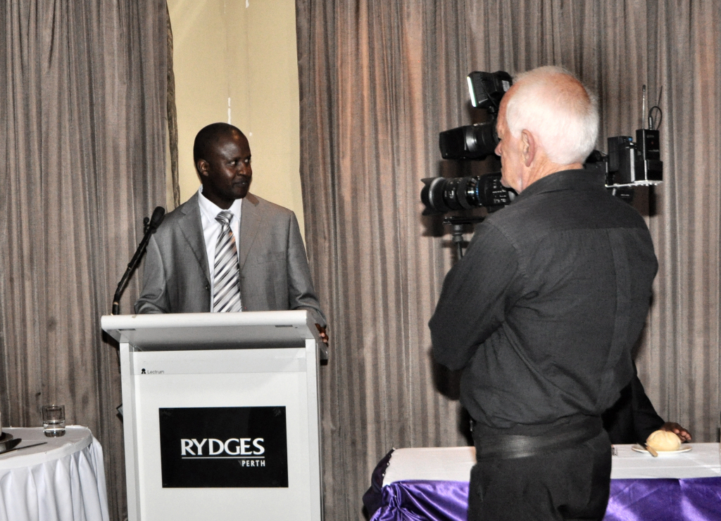

Hi Guys
We had a wedding yesterday and when the speeches were wrapped up I packed away all the lighting and continued on just the B-Cam. The MC an hour later announced they they were going to do a quick vote of thanks from the lectern in a few minutes and, of course ALL my gear including lighting and tripods were already packed away so I had to do it handheld which I figured was no issue for a few minutes.
Bear in mind my B-Cam EA-50 had the basic camera PLUS the big Sigma 18-35 F1.8 plus a video light plus a second Sony battery for the light on it so the lens alone is over 800 grams then there is the heavy battery and the LED light so one can add a good 1.5 - 2.0kg to the outfit.
The so-called short speech ran for 8 minutes and 48 seconds so all I can say is thank goodness I was using the support rod and belt otherwise I doubt whether I could have held the very front heavy front end up that long. It really did take ALL the front end weight off the camera, and I could actually easily take my right hand right off to adjust focus if required .... certainly saved my bacon and amazingly stable footage too!!
Chris

Nice one Chris - Quite a few years ago I got caught out when the speeches started early - before they had even cleared the desserts! I was just about to start placing my equipment so had no choice but to grab my old Z1 and film the lot hand held with onboard mic!!!
Fortunately the B&G loved their video but needless to say it's not one I ever show (well not the speeches bit anyway) to prospective clients!
20 minutes hand held - killed my back!
Pete

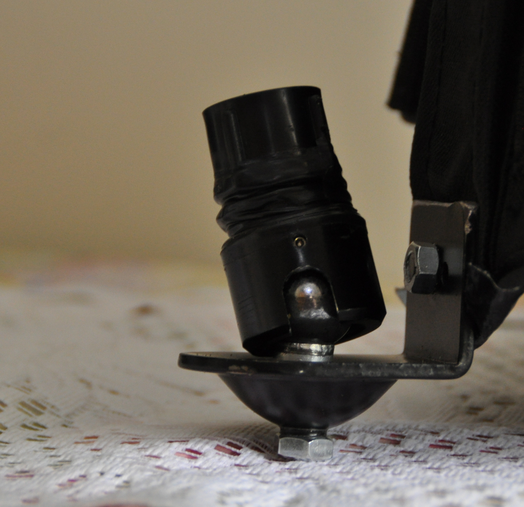

I have actually tossed out the plastic plate with the crappy ball joint out now and just use a nicer mini ball head fastened onto the "L" bracket below the belt and it has really smooth movement too!!
Chris

I said it before...using my ENG rig from DVTec on my full sized cameras including my trusty old GY-5000/5100 with Canon 19X and an Anton Bauer Hytron 120 NiMH battery (5.5 pounds just for the battery) and a wireless receiver hanging off the back end for a total of about 22 to 23 pounds of gear, that ENG rig saved my back everytime I picked up the rig. I has times doing weddings where the introductions, cake cutting and toasts (speeches) ran upwards of 40 minutes. Was the footage as good as if it was shot on a tripod? No. Was it better than just having the camera on my shoulder? Yep. Did I zoom in to the long end of the lens? Nope. Did it save my bacon (my back) from being totally destroyed. You bet.
The ENG rig on my FS and the Multirig on my small form factor cameras were the best investments I made, bar none.
Don
Chris
Don't suppose you have a pic of that Chris? :)

Hi Pete
No problem at all. My bracket was one I salvaged from a light stand ... I just cut it to size but any "L" bracket will work. The "cup" that the rod goes into is part of an old sprinkler but it does work fine. If you look in your hardware store they have irrigation fittings that are used to block off the end of a pipe and those would actually be better!! It's just bolted onto one end of the ball head. Being horizontal as the bracket makes it horizontal now it works really well and also the bracket drops the rod by a few more inches as it's just bolted to the bottom of the waist belt.
Chris

Well either today or tomorrow I'm going to try and shorten mine as per your tips - wish me luck!
Old April 29th, 2014, 02:26 AM   #8
Posts: 8,441
Re: Saved by the Rod!
Hi Pete
No luck needed just common sense!
Don't cut the tubes or springs!! I had two rods so I could experiment and you need the decent length to get a nice soft support.
Do it in two stages First cut off the big plastic fitting at the top and try the whole thing using the pouch only.
That might be OK for you without the ball head at the bottom ...Don's one just had a pouch! If you are worried about destroying the plastic fitting at the top you can also just knock out the pin and remove it and then find even something like a piece of plastic or aluminium rod that will fit snugly in the top tube and tap a 1/4" thread through it ... That way you can always return to the plastic fitting. If you feel a ball head at the bottom is a good idea then do the bottom section.
If you need any help just yell or email me.
Chris
