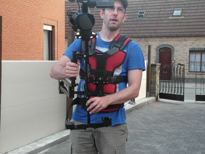

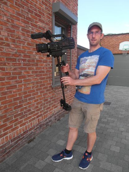

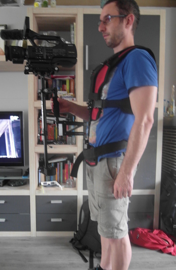

and the pictures
Saved by the Rod!-image-2015-08-29-1-.jpg   Saved by the Rod!-image-2015-08-29-2-.jpg

There is no specific side to use the rig. Most can work on the left or the right... Yours is a centre mount so all you need to do is swing the solid arm over to the left or the right. Try both sides and see what feels more comfortable ...I have my arm on my right ..but that's my preference.
Sounds like you have everything set up well and you weight looks about right ...If you hold the arm gently the top of the spring frame should be horizontal ..that way you have maximum boom up and boom down distances.

Hi Tom! I see you are still using the ea50, just a quick question, the way you hold teh steadicam with your left hand on the photo's, is that the way you hold it while you are flying?

Noa, I hold the handle with my right hand because I'm right handed.
I use my left hand to gently guide the flycam. And that's so diificult in the beginning. When I start to walk I loose the control.

But do you hold the vertical rod as low down as shown in the pictures?

Yes Noa, I think I walk like that. Still learning how to hold it and walk.
With my right hand i can hold the handle lower and closer to me. otherwise the spring bump the handle all the way up.

Your left hand that controlls the direction your camera is facing is positioned way to low, you should use that hand only to gently touch the vertical bar just below the position of the handle and with gently touching I mean like pinching/tapping it with 2 or 3 fingers just to give it direction and if it's going to the right direction don't touch it anymore. Nver grab that bar with your full hand. Your balance seems to be off as well and it looks bottom heavy, if you would test it I would do that inside where there is no wind beause that can trow it off balance. Just google on steadicam balancing and you will find many video how to balance and use a steadiam properly.

Hi Tom
The correct left hand position should be your thumb and 3 fingers very gently touching the post just below the gimbal ..it's only for control and rotation. If you take your left hand away the sled should just sit there as long as you stand still ... also in the normal straight ahead position your right hand only needs to also lightly tough the foam handle ..nothing harder! If you have to fight the arm to keep the camera in position then it's not set up right at all. If you stand still and let both hands go what happens?? The camera and sled should remain directly in front of you hands free and the arm bones top and bottom should be horizontal ... If any effort is needed to control the camera and sled then you need to redo your setup, balance and dynamic balance!! I honestly think that a single spring arm is not tough enough on that rig for a 3kg camera ...you may need to get a bigger spring if it bottoms out???

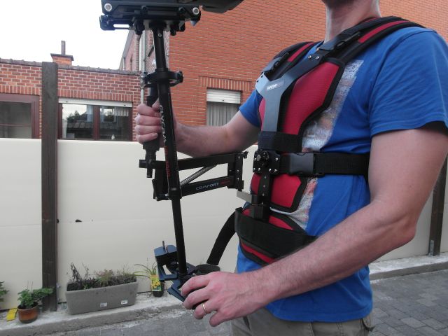

Tom Van den Berghe is offline   Reply With Quote

Much better Tom
I bet that's a lot more comfortable too!! Your camera is now at the correct height and the spring tension looks pretty much perfect too!! You will find that it will be much easier to fly too and your elbow will be clear of the spring arm.
Also get your drop time closer to 3 seconds ..(proper 3 seconds so count 1001, 1002, 1003) You will find that most 2 second drops are more like 1.5 seconds ...when you let the sled go from horizontal the sled should appear to almost float before dropping and needs to swing thru the centre just before you say the "1003" ... a bottom heavy sled will give you annoying sway which you don't want especially with a single spring arm!!
