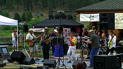

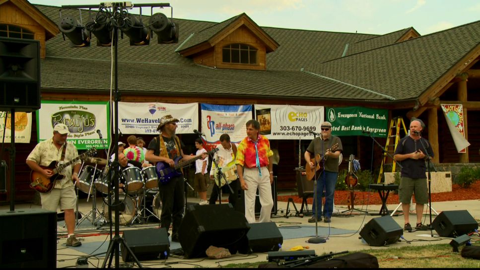

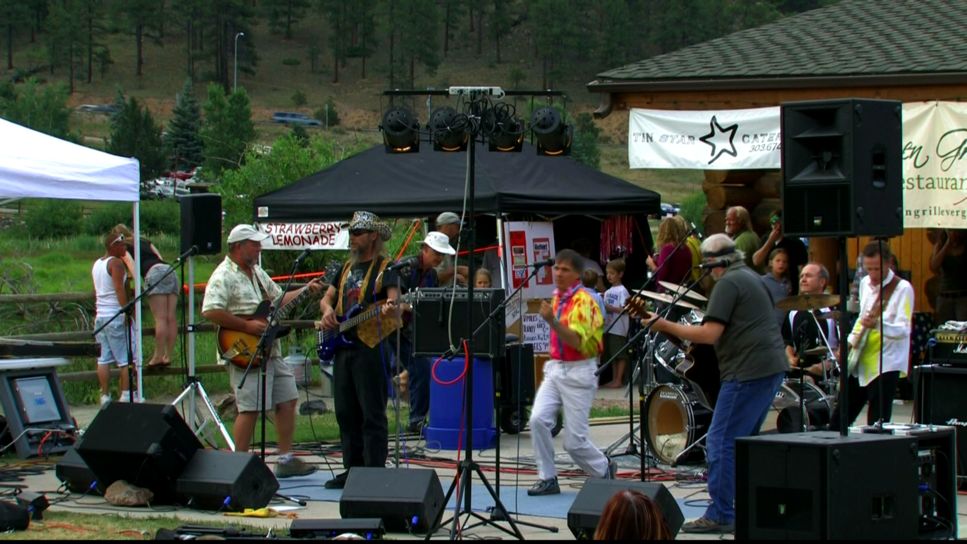

And so have I. Last July we did a two camera shoot of an outdoor concert in late afternoon light to twilight. Both cameras are mine, the EX1 and XH-A1. The blacks from the EX1 are brown, the blacks from the XH-A1 are black. You can really see that when the footage is intercut.
Old October 10th, 2008, 04:32 PM   #239
Join Date: Jun 2004
Location: Denver, Colorado
Posts: 1,893
Note the color of the loudspeakers, roof, and the shirt on the guy wearing the headband.

Tom, I dare say the colour differences between the two pictures are much more than one of the 2 cameras having the IR contamination problem; I'm sure you're aware of that :)
