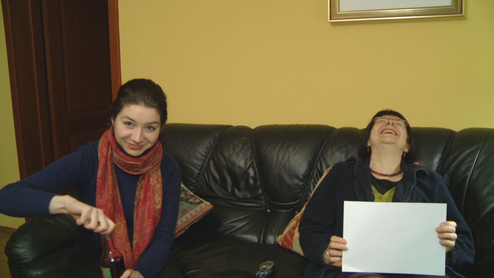

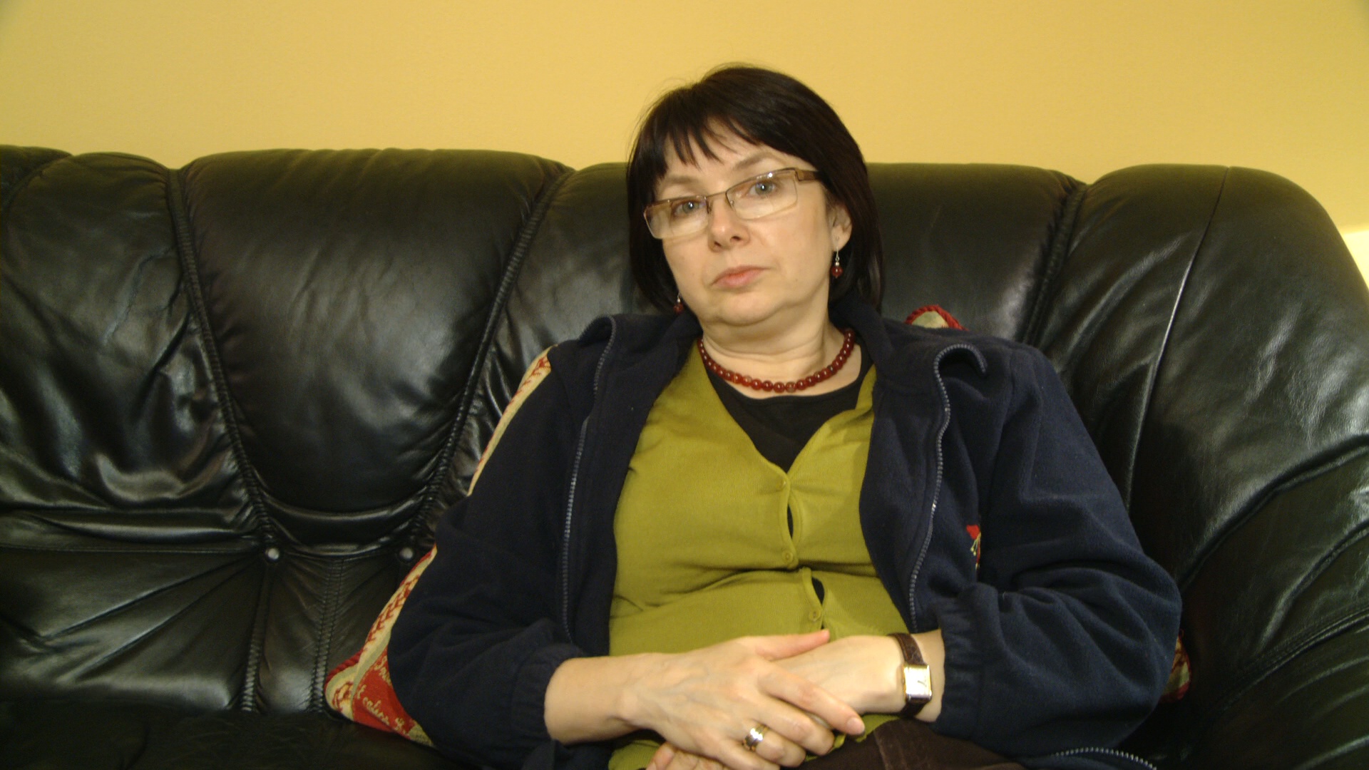

I'd like to update you that after several tests, I have found the new settings best suited for the 486 filter. I'm getting a very good colour reproduction now - even indoors with tungsten light, which was most difficult before the filter...
The blacks are properly black, also the reds are not lacking any more after I simply dialed all matrix pairs settings beck to zero, and carefully calibrated the WB.

Thats really good news - when you say dialled all the matrix pairs back to zero - do you mean on Bill's PP settings (i.e.R-G used to be -75). Also are you finding the green hue around the edges to be a problem? I am about to buy the filter - but think that I would prefer the colour mis-registration to a green hue problem if it is too obvious.

Yes Graeme - Bill's modification need revising with the filter, that's for sure! Therefore, rather than use ungrounded values, I reverted to the factory settings in all my PP's, which now only differ with the gamma curves, matrices, and black gamma settings.
Regarding the greenish cast at the corners: unfortunately it is there, you cannot avoid it at full wide - just the laws of physics, I guess. But it's only visible at full wide and with tungsten light (see the grabs in my previous post here - what starts like the infamous vignetting, is the green cast in the corners actually; when you go fully wide - as seen in the right grab - it becomes apparent everywhere along the edges; the remaining colours are 100% accurate).
Personally, I prefer the colours I'm getting now with some green hue at the corners in specific circumstaces (usually possible to be avoided), to what I was getting before the filter - but of course this is a matter of personal choice.

Looking now at the pic you posted of the 2 women on the couch, the green looks completely unacceptable to me. I could never get that by a client.
How far do you have to zoom in to get rid of it completely?
Do you also see this on a 35mm adapter when using a wide angle?
I'm bummed.
Any pictures of just a flat wall at various zoom lengths would be nice.
I wonder why you only see it under tungstun.
Perhaps its not a function of tungstun so much as a wide open f stop as would be more likely indoors? That's when the light would bend more.

I do agree with you that just looking at stills, this may appear unacceptable - but it's not that bad when actually watching video; in uneven lighting from many weak (tungsten or incandescent) sources, large areas of same colour (like walls) tend to be recorded with all hues of it (depending on the viewing angle and the distance from those light sources) - even without the filter, and it's only natural.
However, you are right it can look very ugly. This is why I stated before that the necessity to use any additional filter in order to just achieve unpolluted blacks is a major EX1 flaw in the first place...
