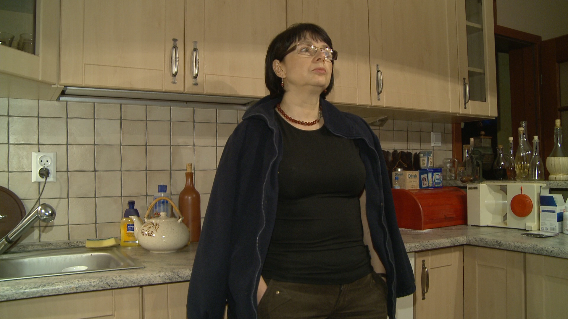

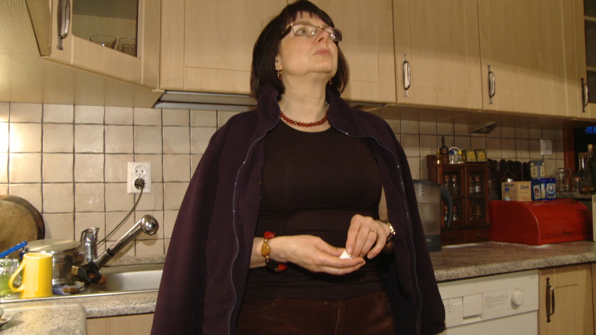

I have just received my B+W 486 filter and put it on my EX1. I have shot some test stuff in daylight; no greenish cast in the corners at full wide, as some have reported. Also, while - without the filter - the picture (using absolutely neutral matrix settings) tends to have some bias toward reds (especially with Hisat matrix), it's completely natural now.
But the real tests I will be doing this evening inside, with some tungsten lighting. I'll try to post some grabs of my girls' black and deep blue garment, which - without the filter - was notoriously recorded as brown or magenta, respectively. With the filter (which has been quite an expensive investment - with duty and VAT paid on top of the B&H price + shipment), I certainly do hope to be getting the right colours...
Peter, my Letus kit being away at the moment - how do you fit LEX on the EX1, with the 486 filter in place of the Letus EX1 thread ring?
Old April 17th, 2008, 01:19 PM   #113
Location: Poland
Posts: 4,086

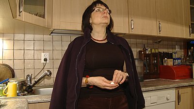

Just a quick update:
Yes, the black clothes look really black, and deep blue are not magenta anymore, with the 486 filter attached in tungsten light (2600-3200K).
However, with all matrix settings being default (for both Hisat and Cinema matrices), red is not properly red anymore; will have to play with the settings and try to correct this.
Also, in tungsten light the corners indeed get greenish tint at fully wide.
All in all, the colours on my V1E looked much better, and without any filtering or the myriad of tweaks needed - this IR problem is something Sony should definitely be made to admit, and treat as a serious flaw on the EX1!
Edit: You can see the clothes looking right with the 486, but the greenish tint also visible (at the furniture, in the corners of the right image). Of course, both pictures are not otherwise identical in their parameters as they were not taken the same day; the WB was not re-adjusted to compensate, etc. - but the tendency is obvious and I picked them on purpose, to show how the filter improves black and deep blue, but introduces other problems instead.

Could someone post pics of the greenish cast. How bad is it?
This is disturbing to me. i was about to buy a 486 but am worried now.
i talked t a Tiffen rep at NAB about this and he should me new IR filters that were quite expensive (hadn't come up with a price necc yet.) and were made with a very elaborate process.

Lenny,
See my grabs in the previous message.

Hi Piotr,
Those two grabs are very telling. I have just re-read Adam Wilts' very informative shoot-out (albeit rushed and 'unfair', by his own admission) between an EX1, RED One and F23 - as has already been mentioned he notices the very same IR-heavy color response exhibited by the EX1 (and to a lesser extent the F23)
I hesitate to post grabs linked directly from his article but the effect appears so obviously that I think its noteworthy enough to justify this quote...
"Aside from the progression in shallowness of depth of field, what’s striking is the difference in colorimetry. Both Sonys show Tim’s black shirt as a reddish-purple... "
(from page 5 of his article which can be found here: http://www.provideocoalition.com/ind...s_ex1_f23_red/ )
Hopefully Sony are taking note and will act sooner rather than later. I would also suggest that you pester you're supplier for _atleast_ a reply from Sony on this issue.
