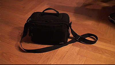

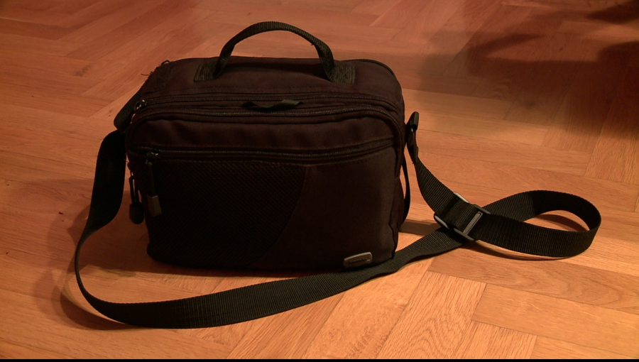

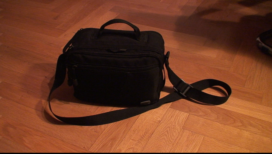

My still
first is from HC3, colour OK, WB OK
second starts from EX1, pp off, bag has two colour
third, pp on, TC1 profile from Bill (Thank you Bill), black on bag is i dont know why in two colour too..
I have some problem with TC2 profile from Bill.
PD170 dont see two colour on this bag too, my eyes see some as HC3 and PD170 :D
