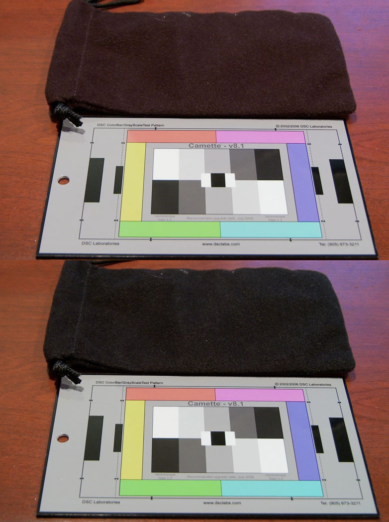

IR Filter in action!!
Here you go....a before and after shot using the IR 486 Filter.
Top is with no filter...bottom is with the 486 IR Filter.
Here is the link to the filter that I bought: http://www.bhphotovideo.com/c/produc...=805&KBID=1062

So Paul, is this a kind of filter that you can leave on the camera permanently, and put the stock lens hood over it?
Old March 23rd, 2008, 06:51 AM   #64
Location: Asheville, North Carolina
Posts: 89
YES....the lens hood fits over it just fine.
I plan on just leaving it on all the time.
I haven't noticed any problems with it so far.

Good... I've just shot some indoor scenes where my daughter was wearing a dark-blue shirt; on the monitor it's magenta!
One thing still worries me, though: when using a 35mm adapter with different lenses, can it stay on the camera? Or will its reflecting IR rather than absorbing it be a problem?
Thanks Paul.
Granted this is one shot and resized for the web, are you seeing a difference?
Old March 23rd, 2008, 06:26 PM   #72
Posts: 89
Originally Posted by Steven Thomas View Post
Thanks Paul.
YES....so far, it seams to solve the IR contamination problem without creating other problems in the process.

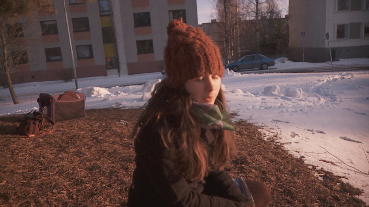

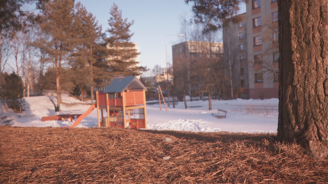

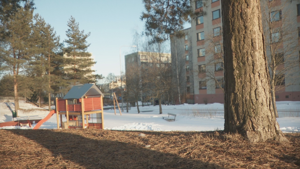

Hi
Im using a Cokin ND P154 (ND8 - 0.9) in front of my Canon FD lens and Letus EX. I can see a weird brown/magenta tint on the picture.
First pic is with the Cokin ND and the 2nd is without. Notice the color of my portabrace bag in the third pic. It looks magenta/pink instead of dark blue that it is. And the little camera bag besides the portabrace is supposed to look pink.
I dont see any change in colour when I put the Cokin ND it in front of my eye. Is this the same IR problem discussed in this thread?
Sami
Sami Sanpakkila is offline   Reply With Quote
