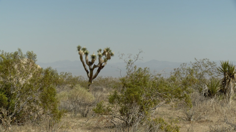

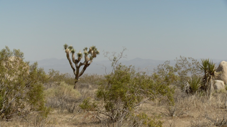

Posts: 75

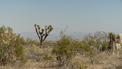

A lot said about the 486 but screenshot comparisons so here is desert landscape taken on a moderatly hot day with and without the 486. Camera setting of course were exactly the same for both shots. The "greener" snapshot is with the 496.
Mike Stevens is offline   Reply With Quote

Mike,
Do you see a radical difference between the desert shots? Aside from the minor color balance issue, to me the 486 has more contrast but nothing I couldn't fix with a minor tweak in post. Am I missing something?
