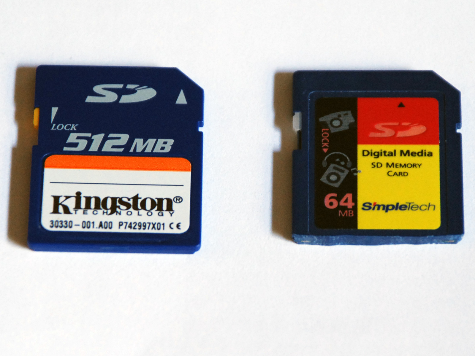

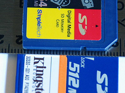

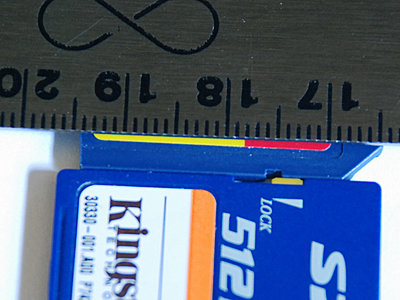

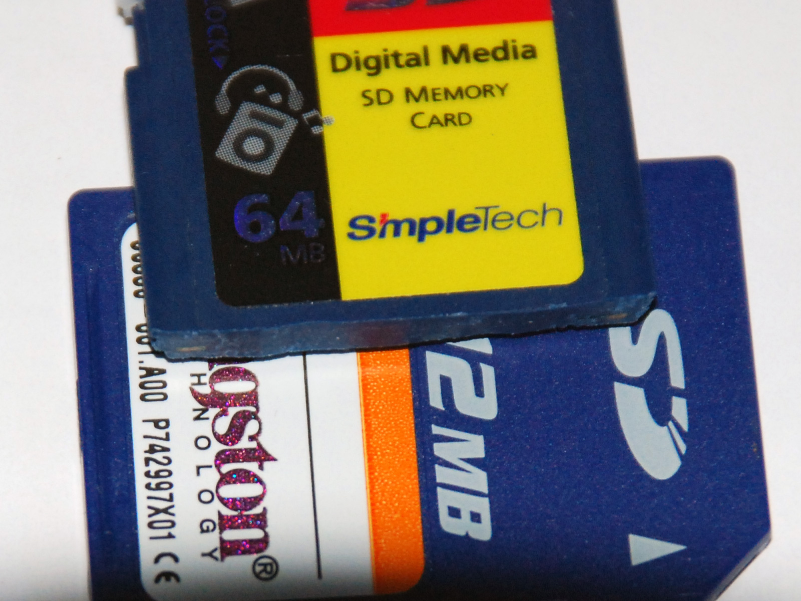

I don't have an EX1. But, for the sake of my compadres with doors that don't close, I did some tests on a 64MB card (tiny!) that I had. There is a metal frame (EDIT - I was seeing the edges of the circuit board) that prevents additional shaving, but I did this with a small x-acto blade. Here are the results. I appears to gain about 1.5mm-2mm - how much do you need?
Once again, I find myself in need of an EX1 for testing. I'm working on designing a shoulder/tripod mount for one of those as well, but without one in my hands, I'm kinda stuck. Would someone like to give me one?

Looks like what you shaved off there would be enough I think. Maybe someone else will test it. I have no need to close the door and I have no spare cards to try it with anyway.
-P

Who in FL (Tampa?) has an EX1 to test this card?
