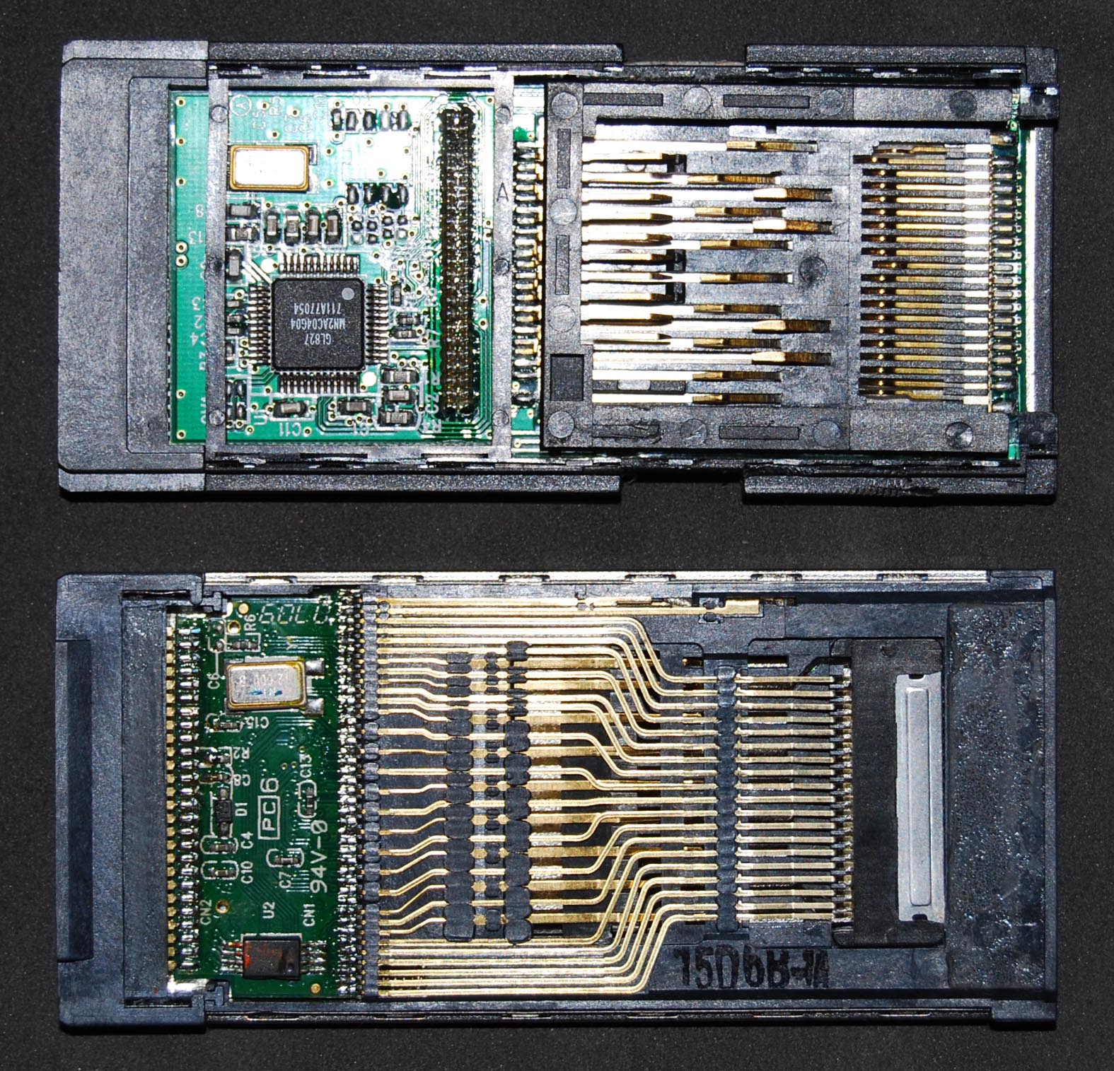

I've opened up an AFT Express adapter, in which the SDHC fits snuggly and the door of the EX1 closes - next I'm gonna trash a Kensington and see if I can marry them - not sure I have the tiny soldering gear needed!!

This is an image of the two cards private parts! The Kensington is above and the AFT below. It is simple to see why the Kensington cannot accept the SDHC fully in, it has more sophisticated electronics than the AFT.
Whilst the AFT accepts the card, it doesn't work - even giving errors when copying files from a card to my laptop through the express card slot.
For those who are concerned: No cards where subject to cruelty during these tests and both cards still function as normal.

So based on your internal image of the Kensington, it uses a Genesys Logic USB 2.0 Flash Card Reader Controller GL827
Genesys Logic
So if we can find an expresscard card that offers this controller and has a push/push media connector, this may be the "magic" combo.
