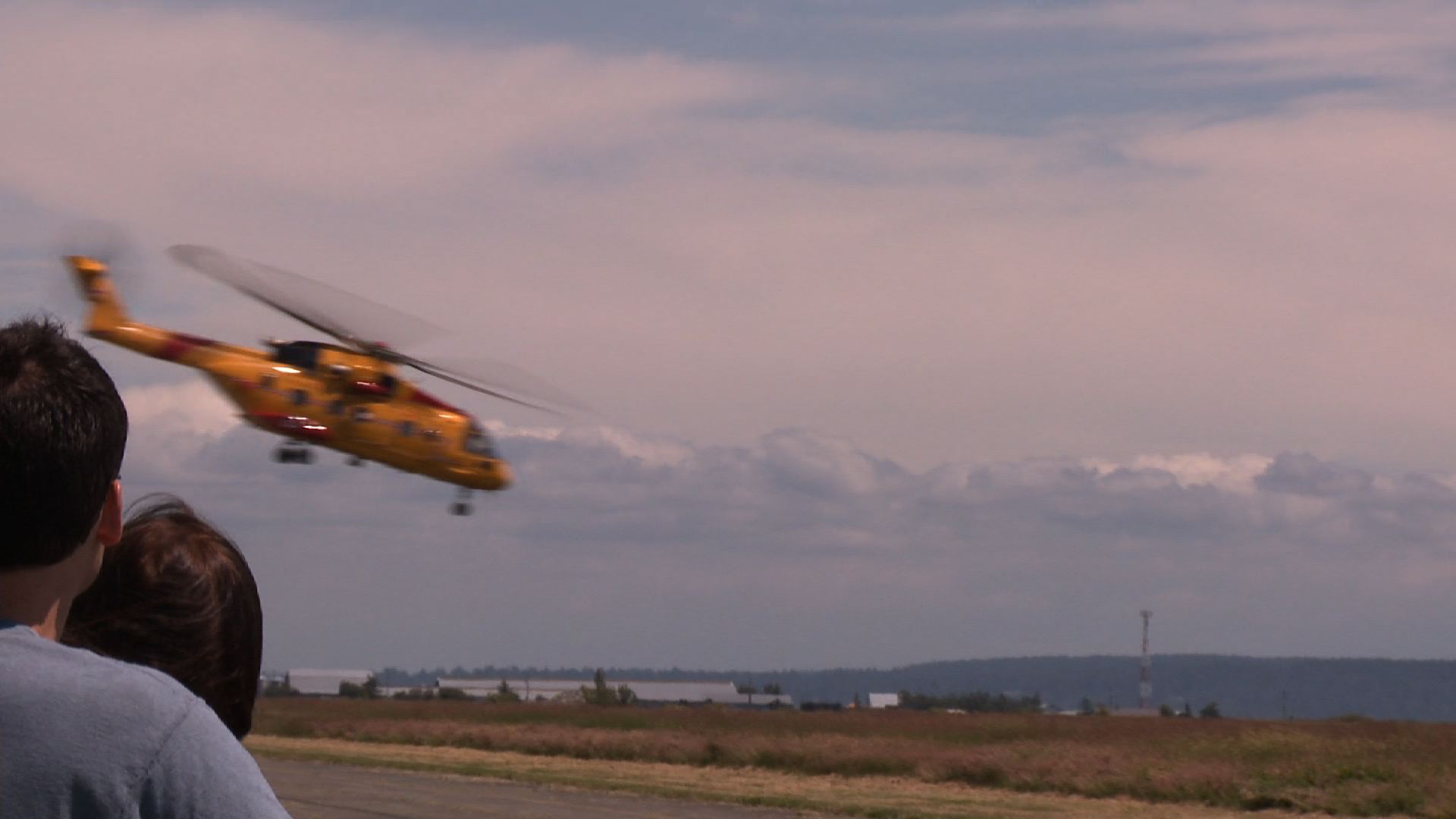

I've only just learned about the IR issue with the EX3. In a shoot I did last weekend I noticed excessive red, particularly in the clouds (see image). I was using built-in ND as well as a linear polarizer in a Cavision matte box.
Am I correct in assuming that this IS INDEED the EX's IR issue? I'm just about to order the Tiffen T1 77 mm which (from what I've been reading) is as close to the fix as I'll get. Right call?
Anthony
PS. It's already been suggested that it appears more like it needs a white balance adjustment but I had done one within the hour and it looked fine in the viewfinder.

To me, it just looks like the rosy hues of sunset.

It was about 2:30 pm on a bright sunny day.
