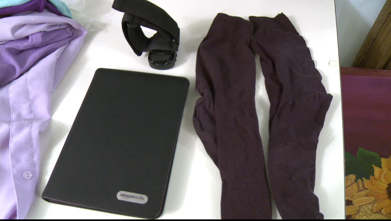

I removed the IR-cut filter from an old DSLR and I put on a Infrared only lens... I know based on the images I've taken with the camera that some of my black socks reflect large amounts of infrared (in the pics I've taken they appear solid white while everything else is exposed properly).
This is a frame grab from an EX3 with the sock present.
I'll see if I can reproduce this with the T1 filter later today and my IR DSLR.
P.S. Lighting makes a big difference, these socks show up as pink under infrared heating lamps (some restaurants have them).

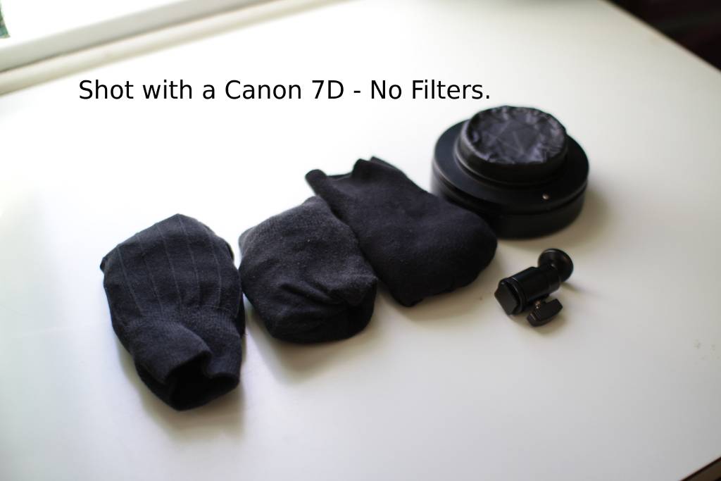

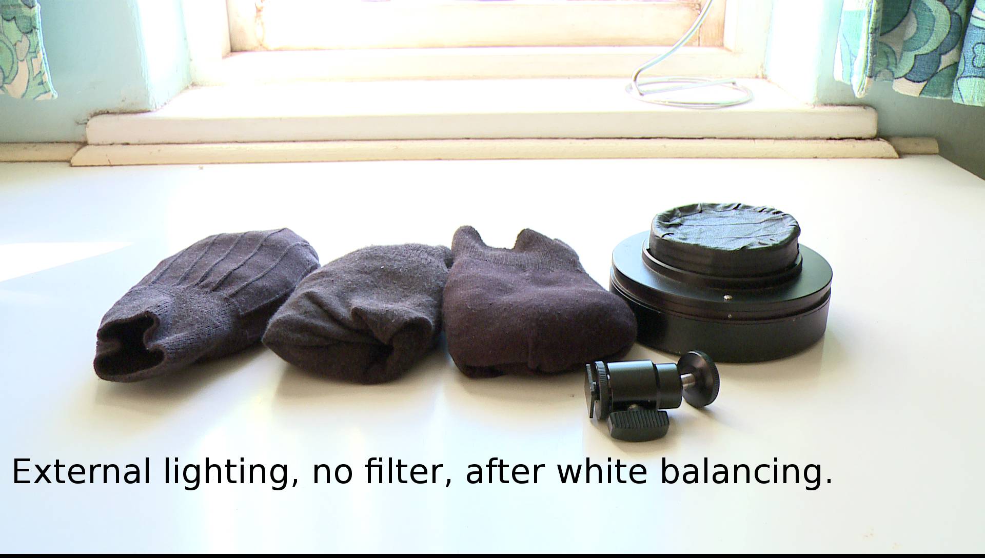

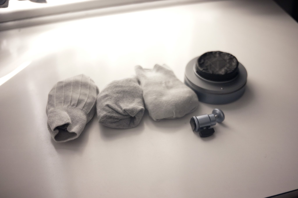

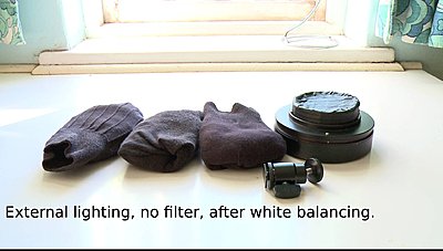

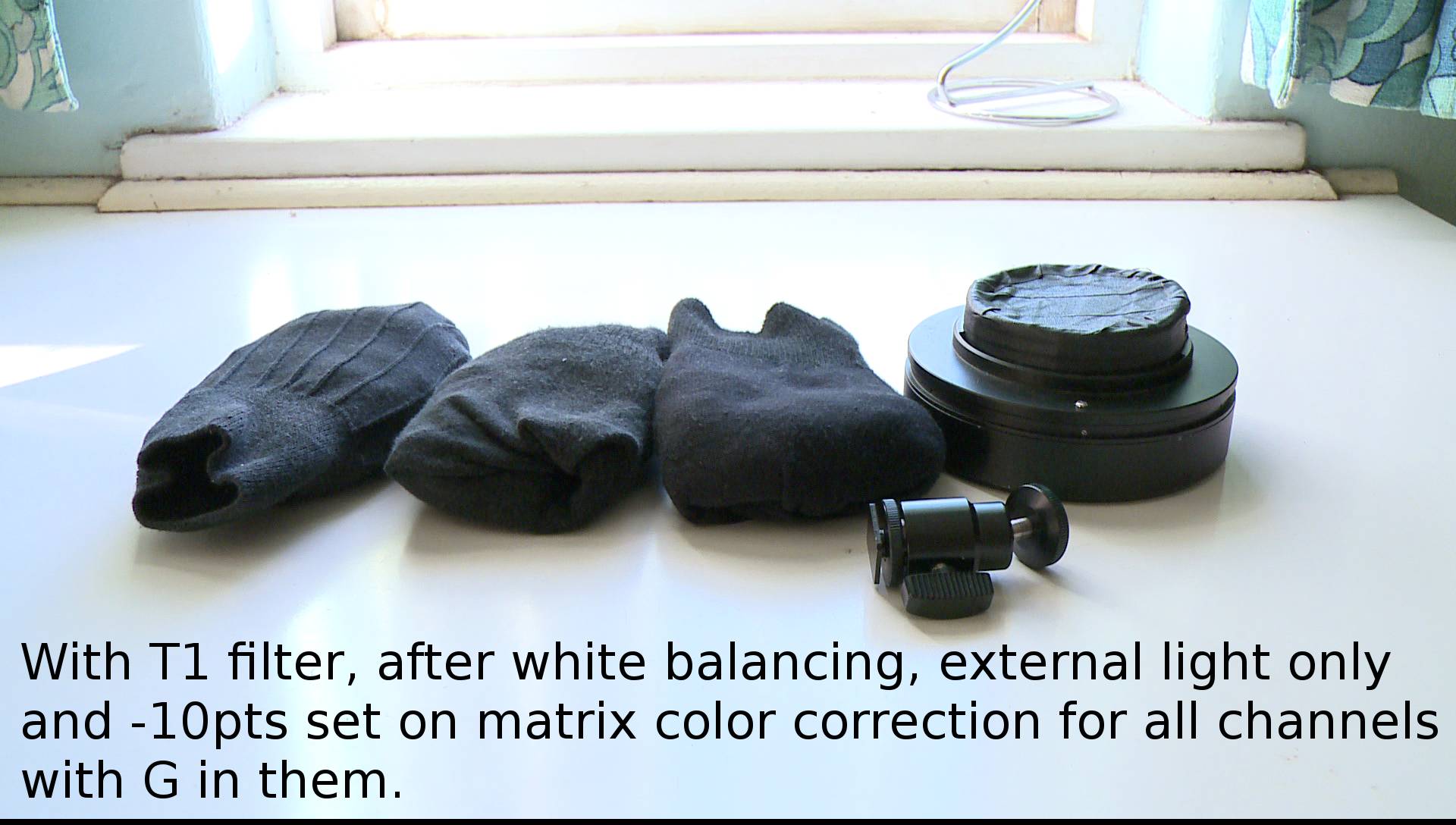

I shot some samples... and fluffed one of them up (the one wb'ed for outdoors but shot under tungsten lighting).
The unlabeled image in black and white is Infrared only... shot using a modified DSLR (has no IR-cut filter) plus a Tiffen 87 IR-only filter. The only *true* black in the image is the cover on the one lens adapter.
All the socks look black to the human eye.
The problem seems to get worse with an increase in gain.
Tiffen T1 - I am impressed-00ir.jpg   Tiffen T1 - I am impressed-01-sunlight-no-filter-after-wb.jpg
Tiffen T1 - I am impressed-03labeledfilterpluswbplusneg10pts.jpg   Tiffen T1 - I am impressed-05thewayitreallylooks.jpg
Last edited by Aaron Scheiner; July 1st, 2010 at 01:35 PM. Reason: Removed image with no white balance as it's unfair to the filter.

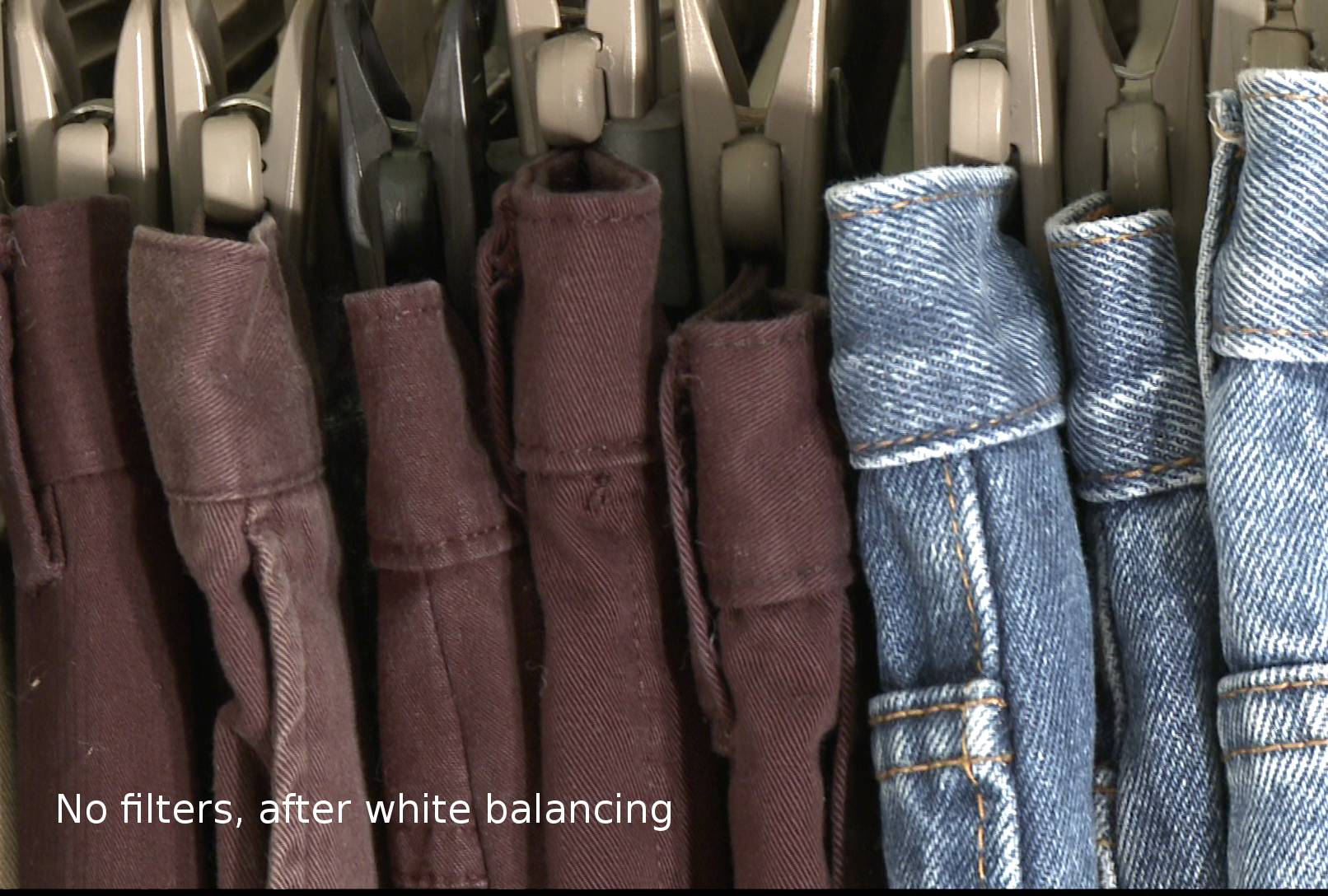

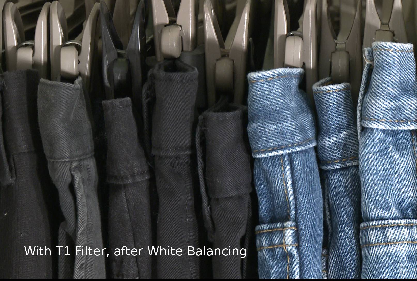

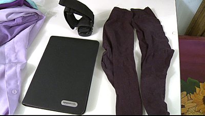

Every tool has it's purpose... I think the filter should only be used when there's severe IR contamination... like in a theatre. It may not be that useful outdoors, although IR can also cause green leaves to look brown on plants. If you notice it, use it. We're going to be shooting a stage production very soon with about 7 seven cameras... that'll allow me to test the effectiveness of the filter in a stage scenario.
I seem to have made a mistake earlier about white balance being only red/blue... white balancing does seem to reduce the green tint quite a bit.
-edit-
Below is an example of where the filter will help... both shots were taken under Tungsten lighting (Redhead) and white balanced. They're just normal black cotton trousers. Synthetic materials are particularly bad...
Tiffen T1 - I am impressed-not1.jpg   Tiffen T1 - I am impressed-witht1afterwb02.jpg
Last edited by Aaron Scheiner; July 1st, 2010 at 01:30 PM. Reason: Added bit about plants and every tool having a specific purpose... although some tools surpass their purpose,like the 5D MKII
