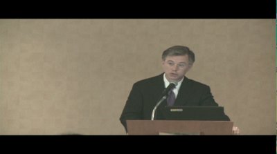

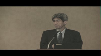

Real world example T1 IR/No T1 IR ...
these are 2 different conferences ... both speakers are wearing black suits ... the No T1 IR filter was shot before I got the T1 and the other after. There were no complaints about the brown suit so I can say I skated on that one but it made me get that filter. The second example is with the T1 IR filter and lighting in both cases were hotel conference room tungsten lights ... T1 IR had a small spot I provided for the speaker ... 5600 K LED spot to counter balance the house lights.

examples ...
Now, these aren't perfect examples with a identical set-up but they are real world shoots. I have consistently added 5600 K spots to counter hotel lighting to speakers and find that you can control, a bit, what the camera records. Both speakers showed up as brown suits ... hence, I added the filter on the one example.
p.s. just goes to show you that these high rollers are all wearing synthetic suits!

examples ...
Originally Posted by Anthony Nalli View Post
No examples attached in the 2nd one either (thx for updating the 1st).
Since they're not the same image and from different perspectives (and possibly different lighting) I'm not exactly sure what to look at to compare. I DO notice, however, a fading in the image with the filter on... that may perhaps be a little greenish.
The situations were completely different ... but both set-ups were tungsten hotel lighting! You can nit-pick all day long on this or that difference ... I don't care. I'm providing you with examples that I have shot so that you can see the difference in real event shoots. I would love a filter that removes the IR contamination completely without any other aspect of the image being effected ... I await the day that happens!

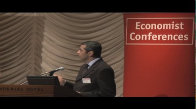

2nd example ...
this example is from the same shoot as the first T1 IR filter example with the same basic problem re: synthetic black suit. Now, I have to say the background wall on that shoot had a similar tint as skin ... I like more contrast but you cannot control these situations and have to do the best you can ...

I think the shot without the filter looks better in comparison. Odd, as I've been burned as well by blacks going muddy brown. Just the light and contrast is better in the first. Bad choice of examples if you're pro filter I think.
