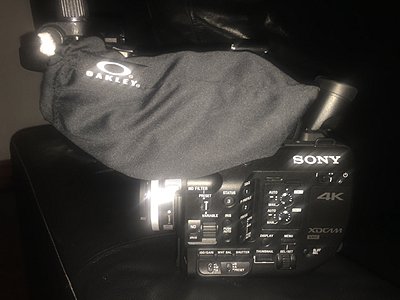

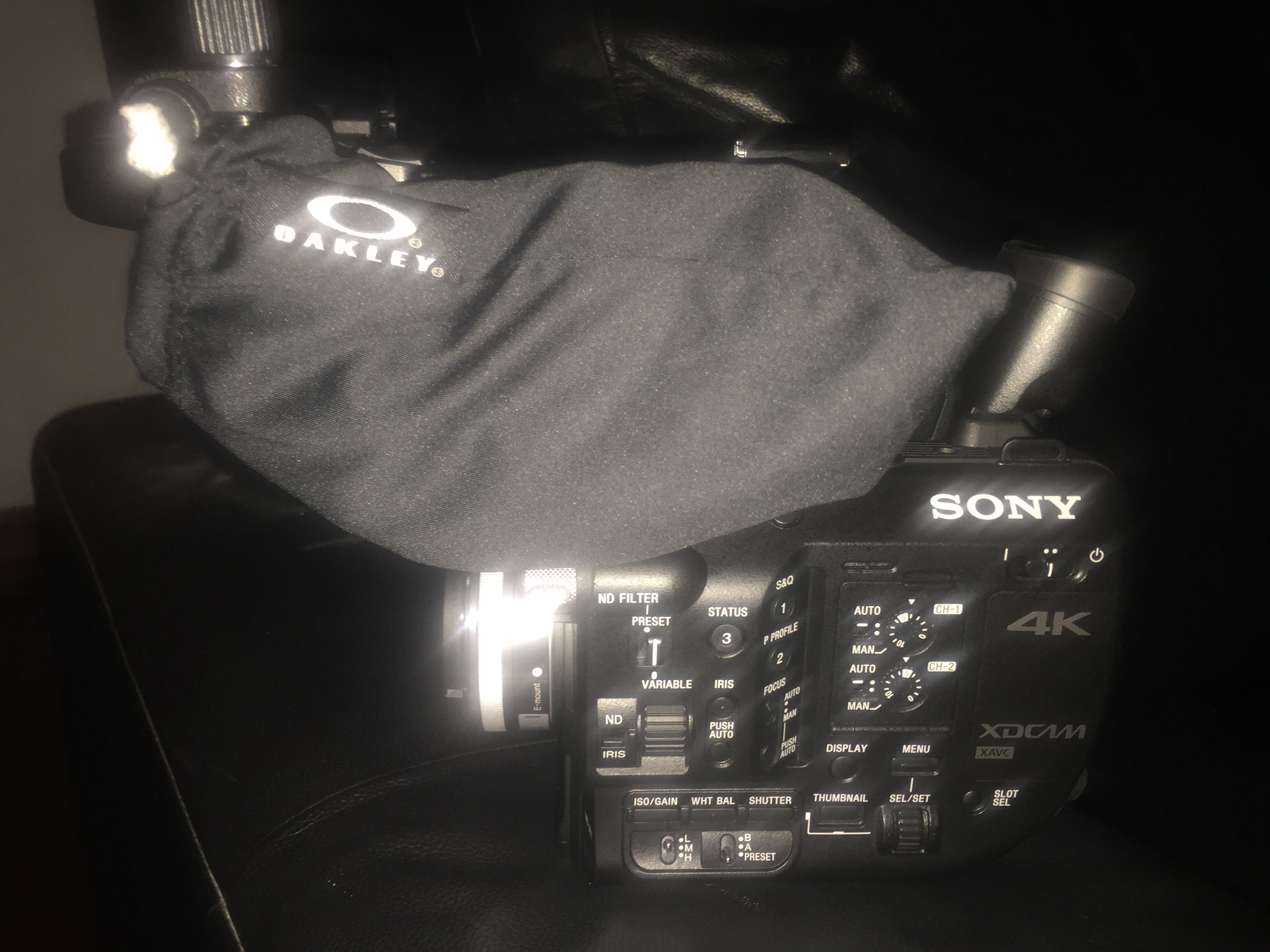

Packing my FS5 in a Pelican 1510 (the airline rollaboard one) for my first flight this week. Everything fits well, but the LCD monitor is a bit of a wildcard. In my FS100 it folded into the unit and was thus difficult to damage. However on the FS5 it has no built-in safe place, and even removed I'm not sure what to do with it. Any suggestions?
Mike Watson is offline   Reply With Quote
Old January 24th, 2016, 09:12 PM   #162
Location: Houston, Texas
Posts: 753
Re: Sony PXW-FS5 - Initial User Impressions
I use my sunglass sleeve to protect the LCD

Wrap it in a small bubble wrap pouch
I do the same thing, would be easy to pack away without the LCD attached but that connection just doesn't seem like something I want to disconnect and re connect daily.
