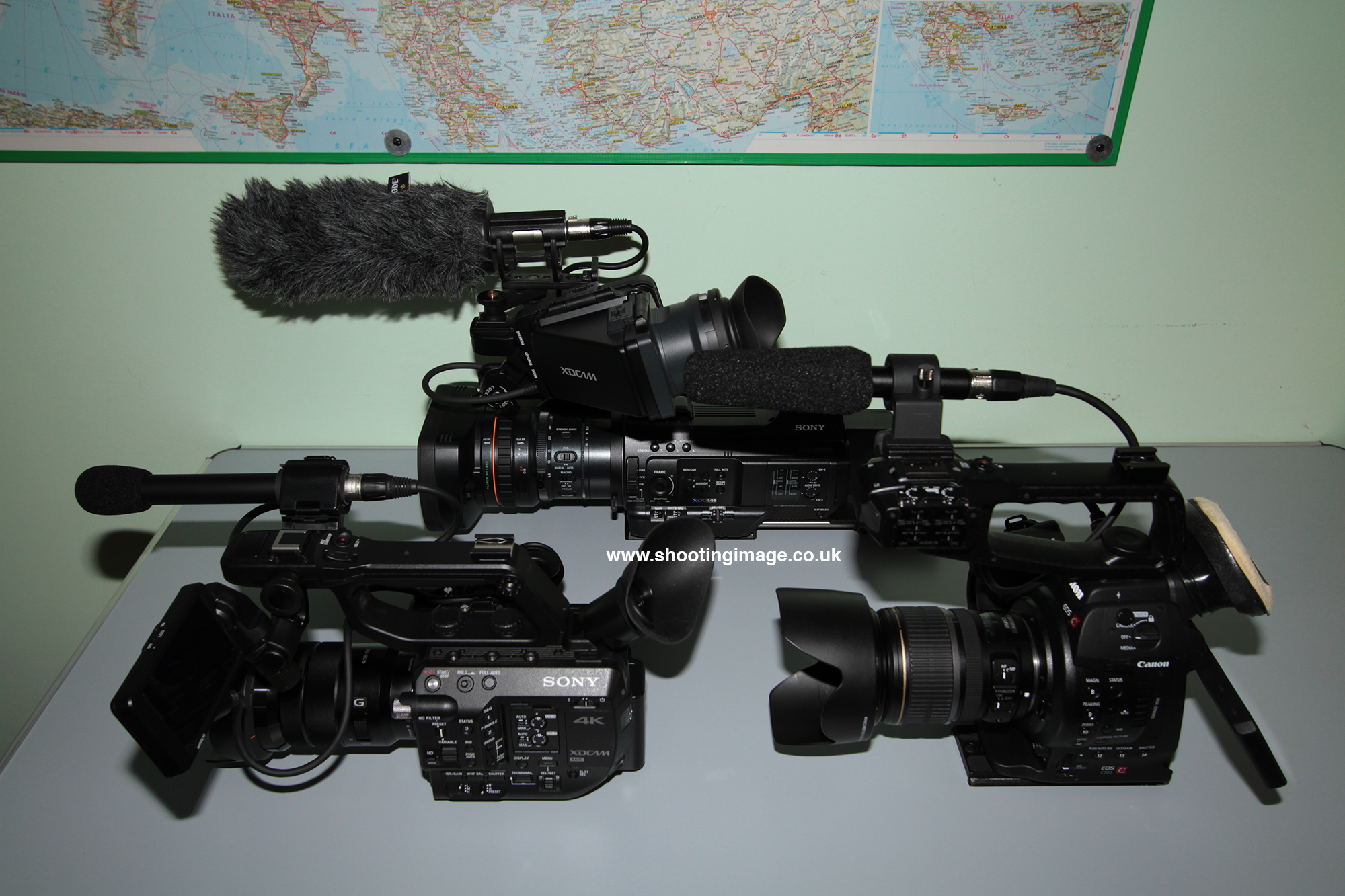

For now I'll just post a snap of the FS5, C100 and PMW-300 side by side to give you an impression of the (lack of) bulk of the FS5. For sure, the ergonomics are better than the C100 so assuming everything else lives up to expectations this one's going to be a winner.

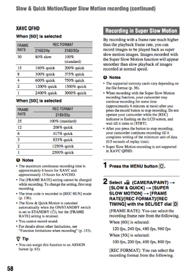

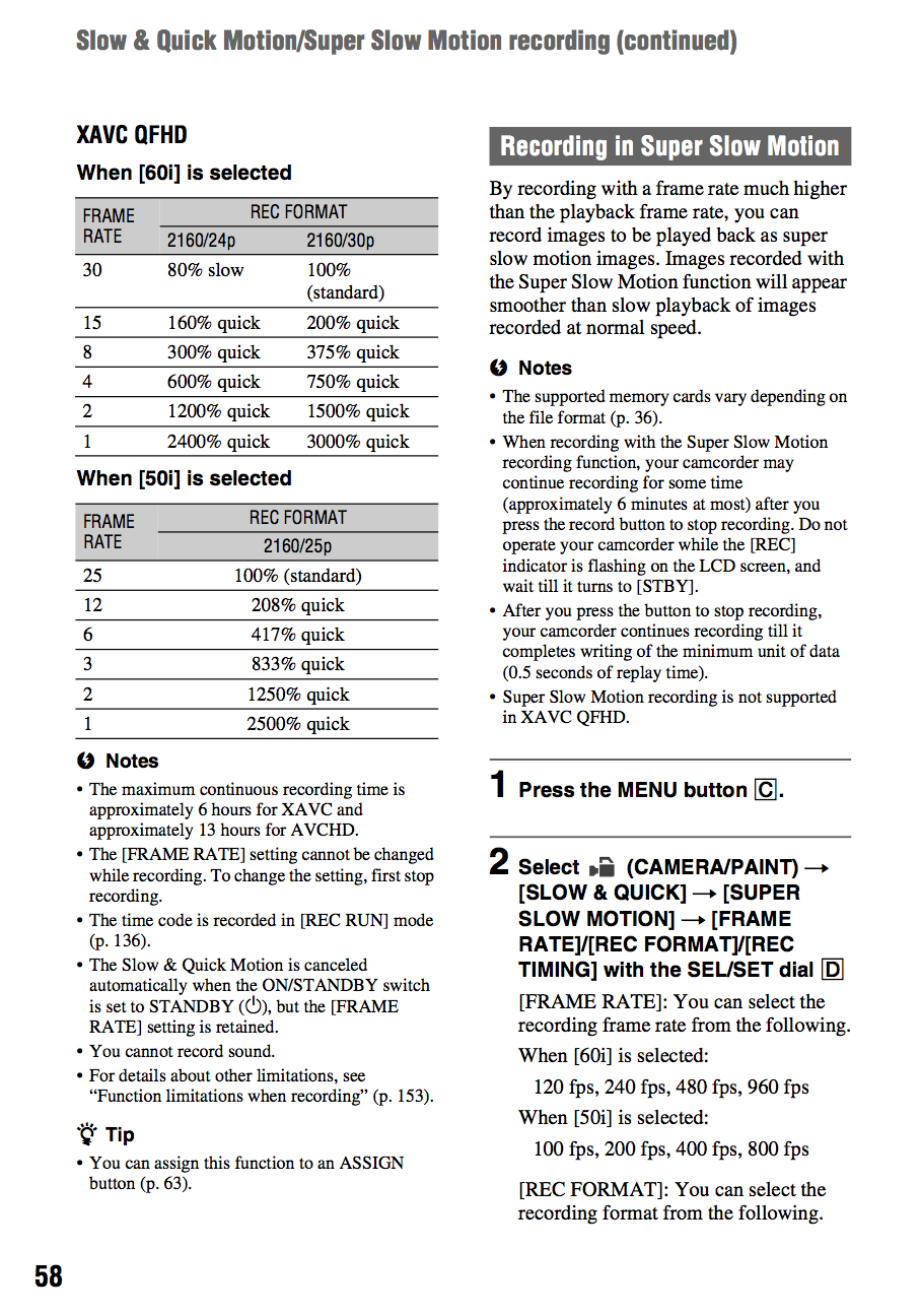

Can anyone confirm the file format of 120fps mode? Is it saved as 60i?
Or better yet, post a file of a few seconds of footage.

Have not had time to test that yet - but I think the high frame rate bursts are indeed saved in a 50/60i wrapper...I wonder what did the FS700 use? (Note: it's not clear, at least to me, from my quick read of the manual via the link above - screen shot of page 58 also attached - I will try and find time to test this later this week).
One other thing I noticed that I forgot to mention in my opening post. It seems a bit strange that the grill for the handle's stereo microphones is on the TOP surface. Seems an ideal place to capture the operators breathing! Wonder why they are not more front facing (like on my C100 and PMW-300 - not that I rely on in-built microphones much, although the C100's handle mics are surprisingly good).

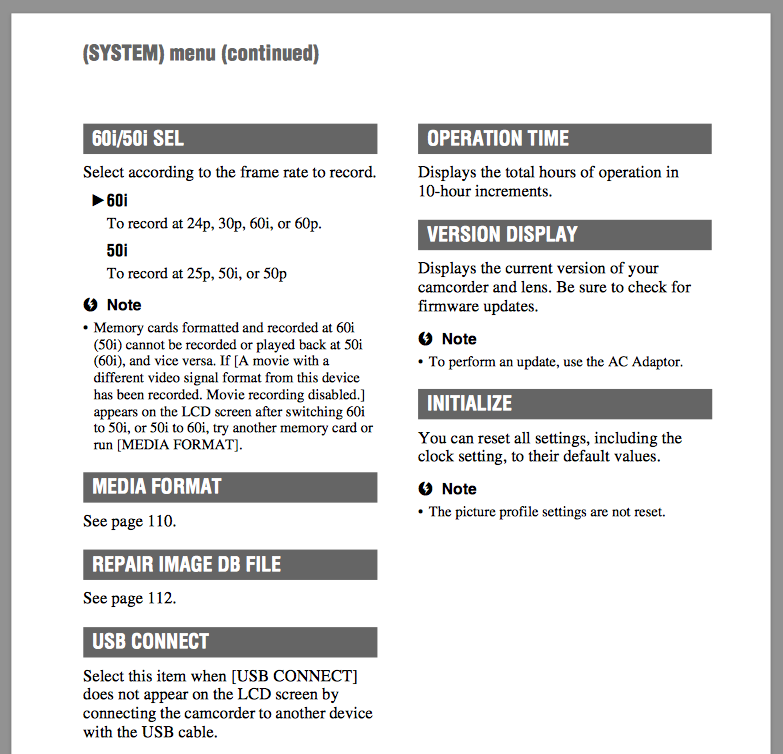

In the manual, I feel like Sony uses the terms "60i" and "50i" in place of NTSC and PAL. Check out page 141:

Nate,
Let's hope that's the case. I would like to see a HFR sample file just to be sure. If they aren't saving it as 50i/60i, then I would hope it's saved at the actual frame rate it's recorded at; 120p, 240p, etc. But that is not how the FS7 does it. On the FS7 you choose 24p, 30p or 60p (NTSC) and that's what your 120p recording gets rolled into. (Note: I couldn't download the manual nor even open the single page shot Andy posted. Slow connection here I guess...)

Just got in from filming and had a VERY quick play around with my FS5 set at 200 fps (nothing elaborate, just me waving it around at my studio monitors!)...I have a cat but he don't move too fast!
Dumped the card contents onto a G-RAID Studio R and imported it into CC2014 (running on my new Mac Pro, with Mavericks OS).
Premier Pro displayed it no problems in the timeline. I tried looking at 'Media Properties' but still can't tell if it's interlaced or progressive...
One thing I will say is that the HFR options need a lot more light for correct exposure. Also, since it's dark here in the UK right now I had the lights on - and of course (as expected) you get some flickering in the footage which looks horrible - the flickering that is! When I get time I need to investigate what kind of lighting I might need for commercial work at HFR in indoor, lit environments.

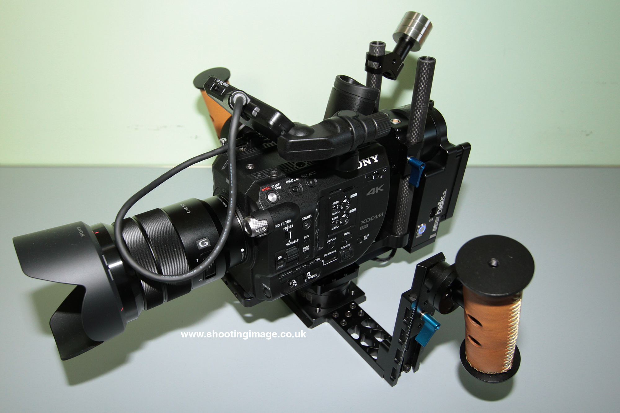

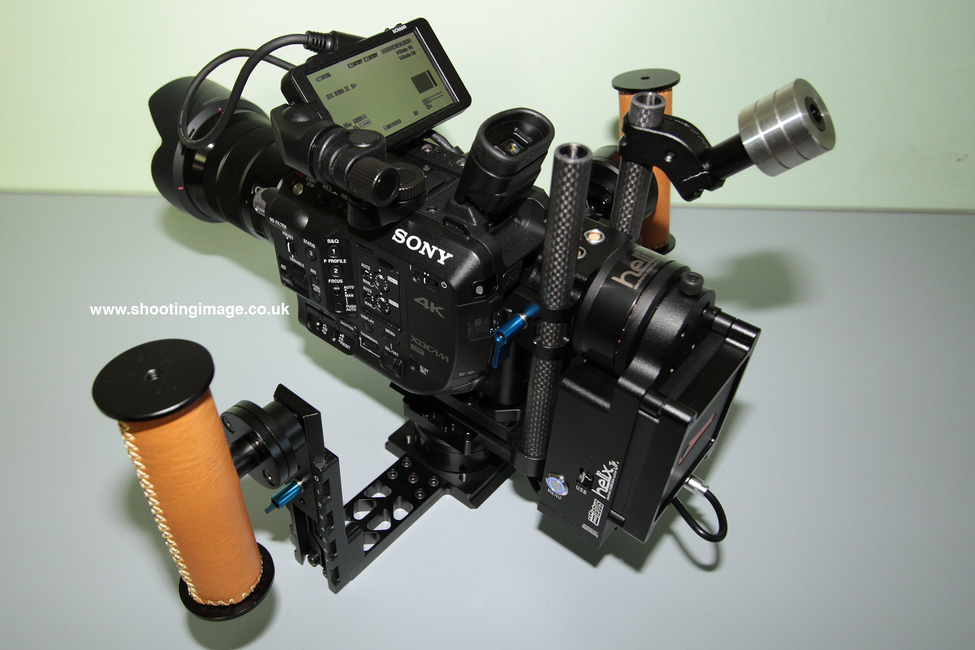

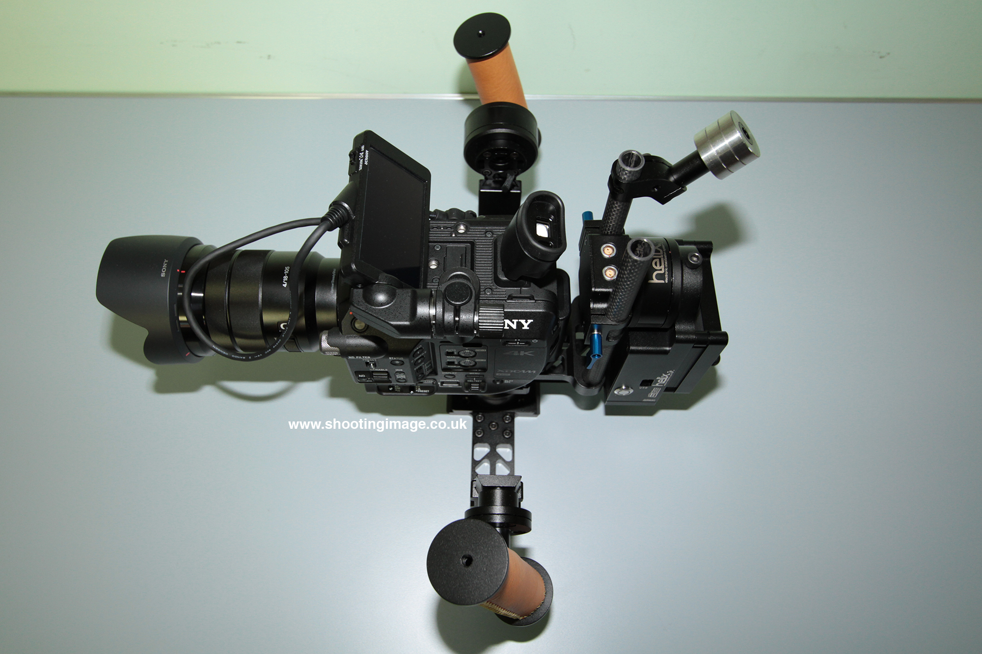

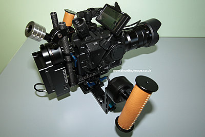

Had a spare hour before a client visits the Studio this morning so I whipped the Sony FS5's top handle and side grip off and put it on my new Letus Helix Jr.
Managed to balance it very quickly - will need a little work using the iOS App to get the Letus settings "just right" (via the Letus WiFi link) but I'm mighty impressed by just how light and usable this rig's going to be for even extended periods. Very happy about this!
Took some quick snaps to share the joy!

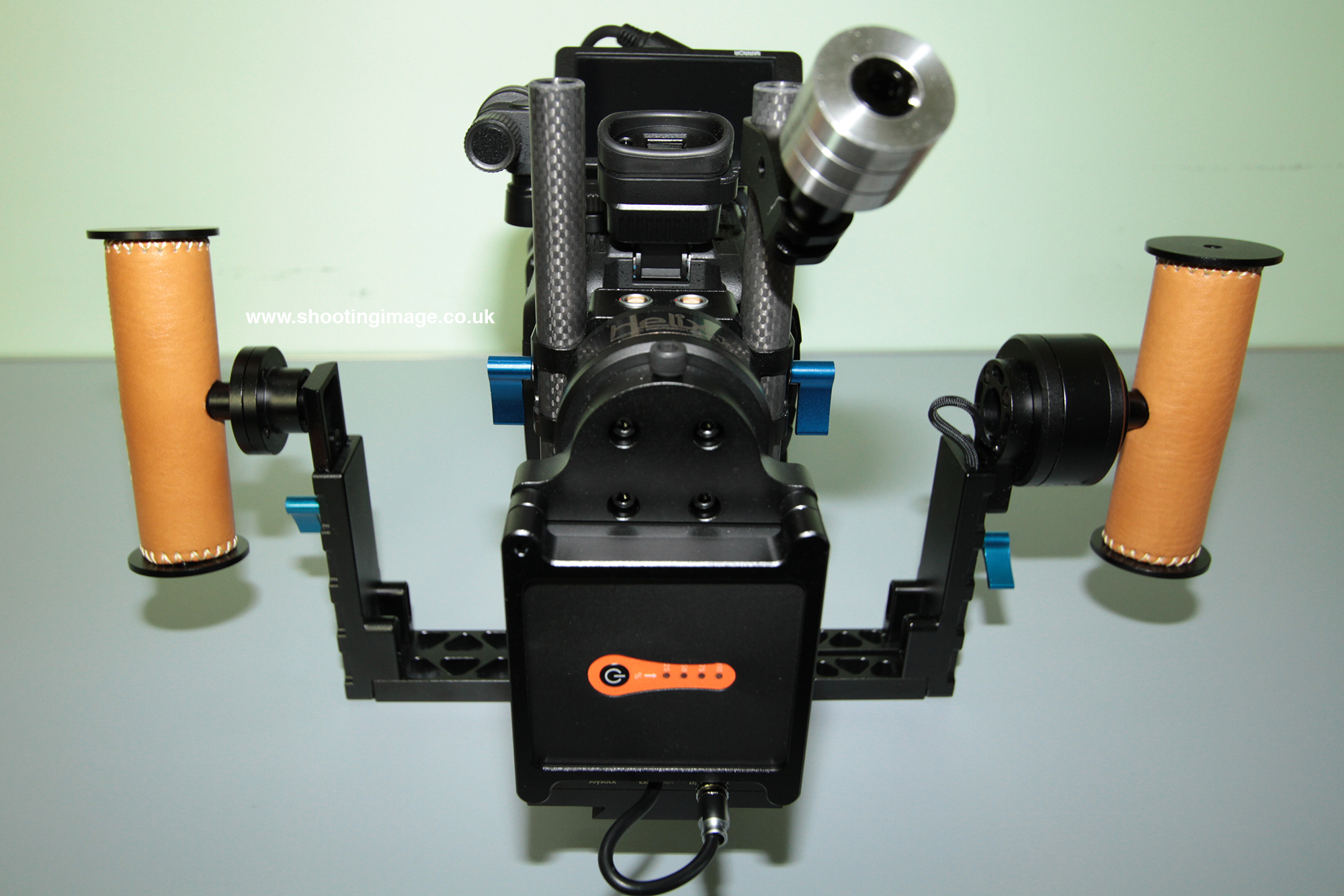

And a couple more snaps - thought it would be useful to show both the top and back views of the set-up.
