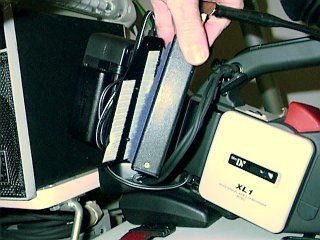

While getting aquainted with and integrating the XL1 into our ENG rotation we were pleased to find that we could still use our Lectrosonic 185 series wireless microphone systems. They have performed faithfully in varied and extreme conditions of use for nearly eight years and we didn't know initially if we could surface mount them to the XL1.
Hopefully you can see how we did this in the photos. It's fairly obvious. I would reccomend a larger single piece of velcro be attached to the MA-100 rather than the two strips here. There are some protruding screws but they posed no problems as far as making good contact with the receivers velcro material.
It's a bit of a tricky maneuver but is workable. You need to watch the door covering the rear A/V connections. Close it half way. Apply Velcro to the Battery Plate and make sure the XLR connector is farthest from the camera body.
We shoot in Stereo 1+2 mode using Stereo 1 for natural sound and channels 1 and 2 of Stereo 2 for two discreet wireless channels of audio. So far the audio has been of very high quality. I perfer to use the on board auto limiter as it is very subtle and dosen't pump or breathe and seems to provide protection from extreme transients.
