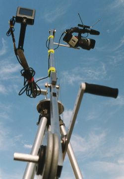

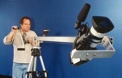

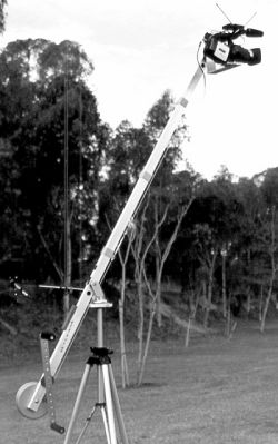

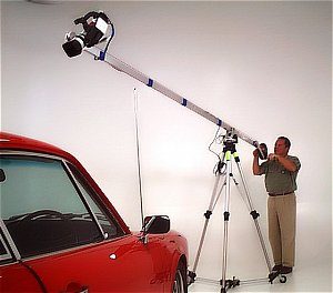

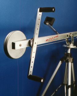

Constructed of aircraft-quality aluminum box tubing, the SkyCrane is really two booms in one. The primary component, which is the control end of the boom including the counterweights, operating handles and tripod mount, can function on its own as a short jib arm a couple feet in length. However, with the supplied extensions, the SkyCrane also becomes a full-grown camera boom, easily hitting altitudes of twelve feet or more depending on tripod height (any higher and you'll need a pilot's license). The standard extension is three feet long, making the entire boom length from the tripod mount about five feet in length. Jones also offers optional four and five foot extensions, giving the SkyCrane some serious "reach."

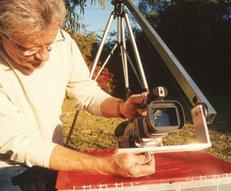

The SkyCrane requires a fairly substantial tripod, and Jones recommends the Bogen 3061 or heavier. The control end of the boom mounts directly to the tripod itself and rotates very smoothly in both vertical and horizontal axes on precision sealed ball bearings. The camera mounting bracket also rotates through the vertical axis, and is controlled by a drive cable over a set of pulleys and a handle at the operating end. The camera head can spin 360 degrees and the amount of initial camera head tilt is easily adjustable. Drive cables are included for both the short jib arm and the longer extension, and the camera mounting bracket can be removed and remounted in minutes with a crescent wrench.
The amount of counterweights that must be hung on the control end to balance the entire boom assembly depends on the weight of the camera and the length of the boom extension. The counterweight mount is on a sliding arm at the back of the control end, allowing finely tuned weight adjustments. A distinct advantage of this arrangement is the ability to barely trim out the counterweight just slightly, so that you can start a shot high and let gravity do the work for you… resulting in a slow, smooth, sweeping camera move. To save shipping expenses and unnecessary costs to the user, Jones suggests using readily available weightlifting discs for SkyCrane counterweights.

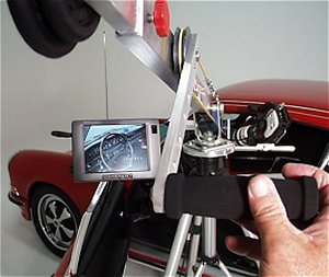

Among a number of other SkyCrane accessories, a bracket which can support an LCD monitor mounts to the tripod head itself, staying in a comfortable, fixed viewing position while the boom itself is in motion. Once you've had fun flying a camcorder on the SkyCrane and inventing new angles to shoot from, you'll be looking for excuses to use it whenever you can.

There are some other excellent booms out there on the market that would stack up nicely against the SkyCrane, but they are more costly and certainly cannot compare in quality of material and construction. The SkyCrane is fabricated from finest materials available, individually assembled using 6061-T6 aircraft-quality aluminum heavy walled rectangular box tubing, anodized aluminum drive pulleys, precision sealed ball bearings, stainless steel carrier bolts and fasteners.
In using the heavier video cameras, camera weight is not the only issue. It's a combination of boom, camera, accessory and counter weights combined, which can add up quickly. With the counter balance being roughly three to one and a camera weighing ten pounds, you need thirty pounds of counter weight. The one real requirement here is a substantial tripod to mount the boom on,and we recommend the Bogen model 3061.
There are but a few booms that have the capabilities of the SkyCrane. Being cable driven, it has the ability to rotate the camera mount 360 degrees horizontally.
The SkyCrane incorporates its own integrated ballbearing tripod head. We also offer an optional universal LCD monitor mount, that attaches to the tripod head. This allows the boom operator full view of the monitor while panning or booming up and down. The distinct cable drive lever is multifunctional and is designed for comfort and ease of use by the operator.
