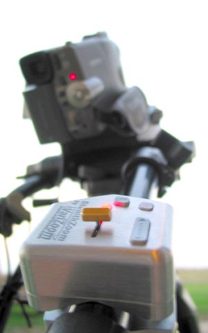

Stealth is small, compact, and highly portable.Then along came VariZoom Lens Controls, based in Austin, Texas. While its product line catered primarily to the professional market, VariZoom recognized the impact of DV and developed a series of zoom and focus controllers which work perfectly with all Sony and Canon DV (and Sony Digital8) camcorders. These devices have significantly improved the DV production world by accomplishing two very important things... first, by providing smooth, accurate, consistent control of zoom, focus and other functions, and second, by getting your hands off of the camera while shooting. Thus, I've become a huge fan of VariZoom's product line and I'm pleased to tell you about their newest controller, the VZ Stealth.

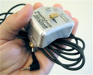

The VZ Stealth is much smaller than other VariZoom controllers, which is the whole point of the product. It's only 50mm wide and 45mm long, and 25mm tall from the tripod mounting groove trough to the tip of the zoom lever. The two mounting bolts are 25mm long and are spaced 40mm apart. The cable appears to be close to six feet long. While most other VariZoom controllers come with a handle, the Stealth is so small, it fits in the palm of your hand... and your tripod pan handle becomes the handle for the Stealth.

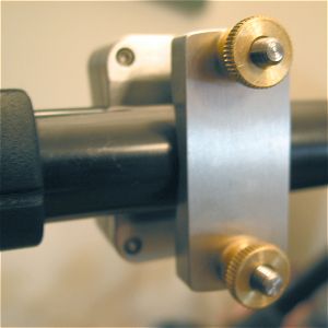

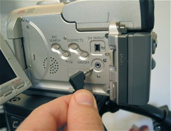

Underneath Stealth... the mounting clamp with brass knurled nuts.Stealth clamps to your tripod pan handle, shoulder support, camera stabilizer or just about anything else via two finely threaded mounting studs with knurled brass nuts. Stealth's bottom base is V-notched, creating a groove to accomodate the round tubes of common tripod pan handles. The cable extends from the nose of the controller, and plugs into the Control-L jack found on all Sony and all Canon DV, Digital8 and Hi8 camcorders.

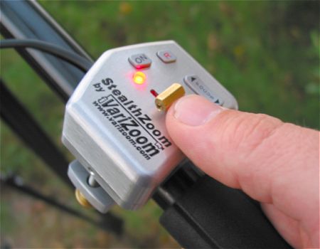

Once Stealth is connected, you now have remote control of zoom, focus, wake-up from standby and record start/pause. A red indicator light confirms that you're recording, and flashes when camera battery power is failing or when you're nearing the end of a tape. Some other VariZoom controllers are a little more fully featured, such as the VZ Pro-L, but Stealth's primary feature is its small size. If this is of utmost concern to you, then Stealth fills the bill. VariZoom has several different controllers for DV camcorders; choosing one just depends on your specific shooting requirements and ergonomic preferences.
I get a very slow zoom by lightly pushing the zoom lever from behind.

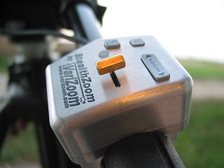

VariZoom controllers plug into the Control-L jack, found on all Sony and all Canon DV camcorders.Beyond the compact wedge shape of the body, the first thing you notice about Stealth is the brass throttle-style zoom toggle lever on top of the controller. Push it forward to zoom in, backward to zoom out. A spring returns the toggle to the center full-stop position. There are five zoom speeds in each direction. Barely pushing it forward (and I find it easier to do this with the tip my thumb just behind the lever) moves the zoom at the slowest speed, which is indeed a very nice, slow crawl. A little more pressure finds the middle speeds, and pushing the lever all the way forward (or backward) achieves the fastest zoom speed. Other VariZoom controllers offer a speed dial for "set and forget" zooming at particular, discreet speeds. Stealth's small form factor doesn't allow for that; if you need this particular feature then VariZoom has a few different controller models to suit your purposes.
Stealth will work fine with any Sony or Canon camcorder, but is best suited for anyone on a budget and needing a small controller.I really like the position of the record start/pause button -- it's out of the way to the upper right of the controller face, where it's not going to be hit accidentally when zooming. It's still conveniently placed, but you're less likely to touch it when you don't mean to. There's also an "on" button to wake up the camera from its standby mode.
The focus control rocker is located to the right of the zoom lever. Just make sure your camcorder is switched to manual focus mode, and the focus rocker will allow you to shift the focal plane of the image, either pulling it closer to the camera or pushing it further away. The shift in focus is slow enough that you can see how it's changing and stop it when you need to.
