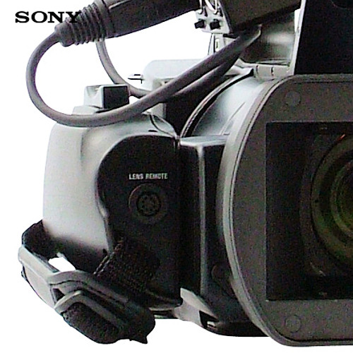

Remote Lens Control on the PDW-EX1
Many thanks to Tim Polster for pointing this out.
This is a screen cap from the EX1 camera rotation located at:
http://assets.sonybiz.net/Flash/XDCA..._ex/index.html
See attached photo (click to see it big).

By the way that is NOT the standard 8-pin connector commonly used for Fujinon broadcast video lenses.

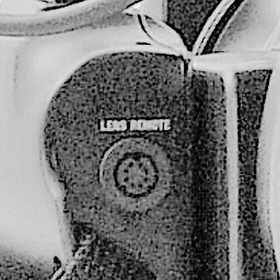

Personally I think the image is too dark and low res to make that call just yet.
I will agree though that this connection does not seem to stick out of the chassis like the 8pins connectors stick out of lens.

Upon looking at a fuji lens I have, I believe Chris is correct, this is not a normal 8 pin connection.
The connector on my fuji lens here has 7 holes in a circle with one hole in the center.
The photo of the XDCAM EX has 8 holes in a circle.

Your right, this puts the nail in the coffin it is a standard 8 pin connector.
On ya Sony, Not 8 pin or standard LANC..
Then try this one.
I think I'm counting eight pins, but I still don't believe it's the standard 8-pin connector found on all Fujinon and Canon broadcast video lenses (almost all; Fuji used a 12-pin connector for awhile). For one thing, the standard 8-pin connector screws on, and I don't see any threads here. It looks like a simple friction push jack. We'll know more pretty soon of course, but my bet is that this is a proprietary connector.
