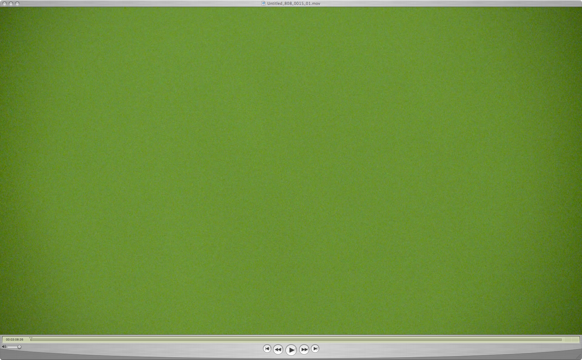

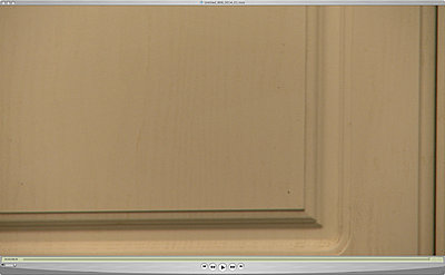

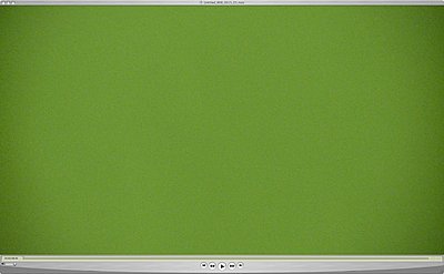

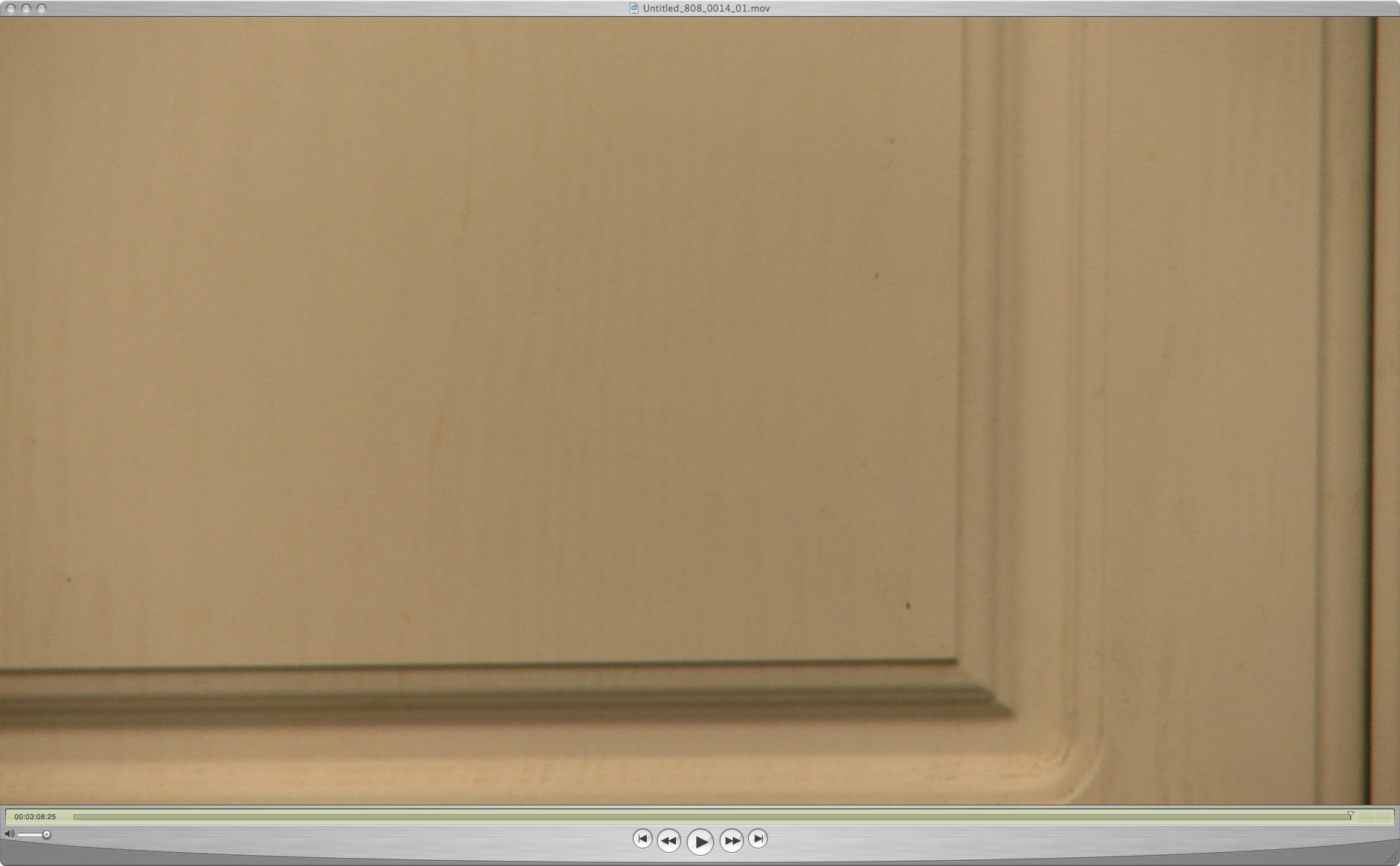

Test1 is kitchen cabinet. Not quite flat white but you can see the corners look good.
Test2 is my green screen. You can see vignetting but not of the "corner crop" variety others show. There does seem to be a bit more on the right but the picture wasn't flat lit.

I checked the above in Final Cut Pro. I then opened the shots in Quicktime Full frame size on my 23" Apple Cinema Display and did the screen grab. Don't have an HD video monitor yet.

Craig, I take you slowly zoomed through full wide to tele when looking for the vignetting. I'm sure you heard it's been seen with wide open aperture and focal length between 8 to 25mm
If this is your worst case, it looks good to me.
Picture 2, what was the focal length and aperture set at?

F1.9, 8mm. Camera mounted on tripod and hand zoomed through so I could stop at various points with some precision.
Green screen shot was just lit with a china ball we had on the ceiling so I know it's not evenly lit.
I'm going to do more testing though but like I say if it's this hard to find. . .
