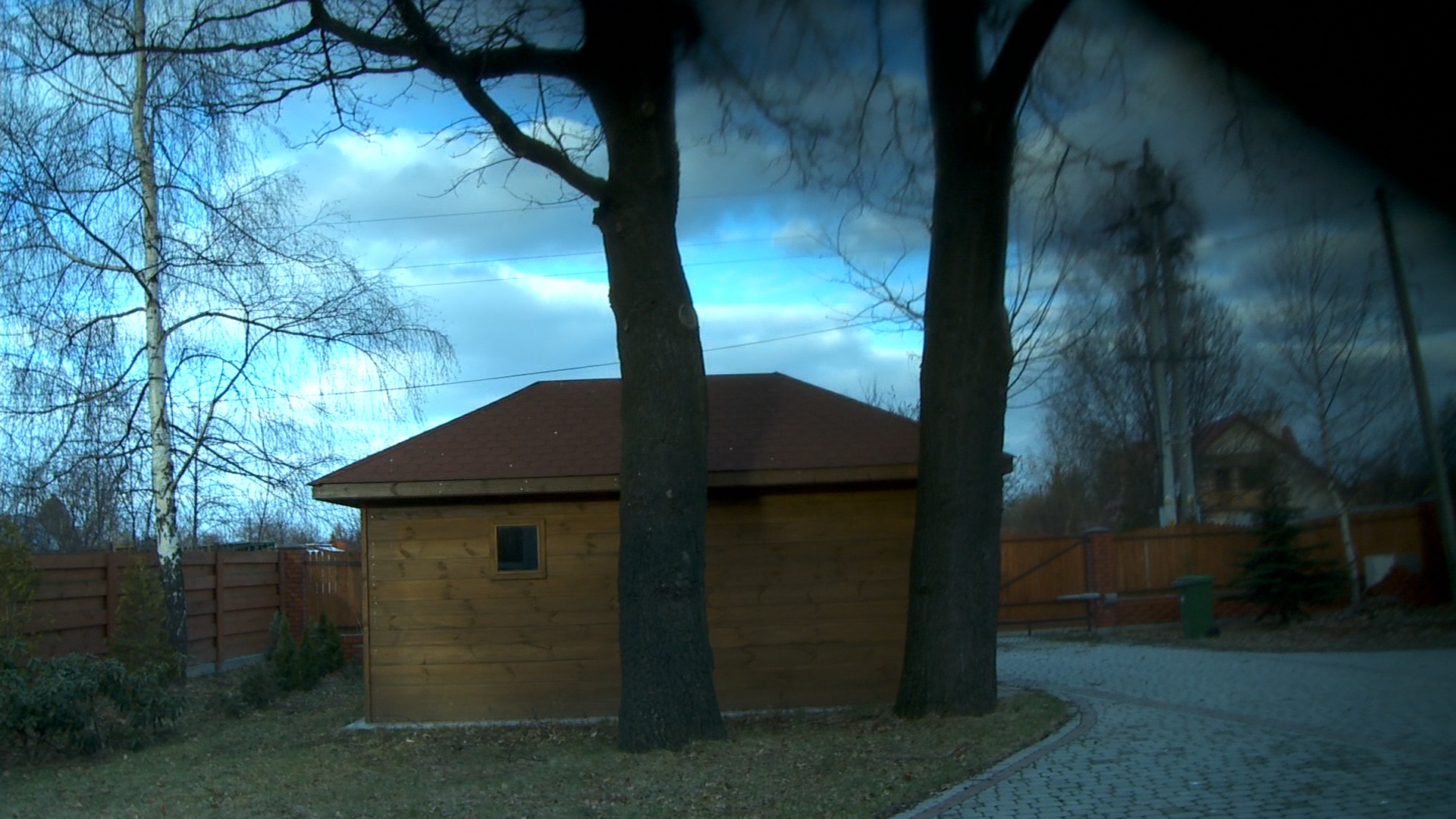

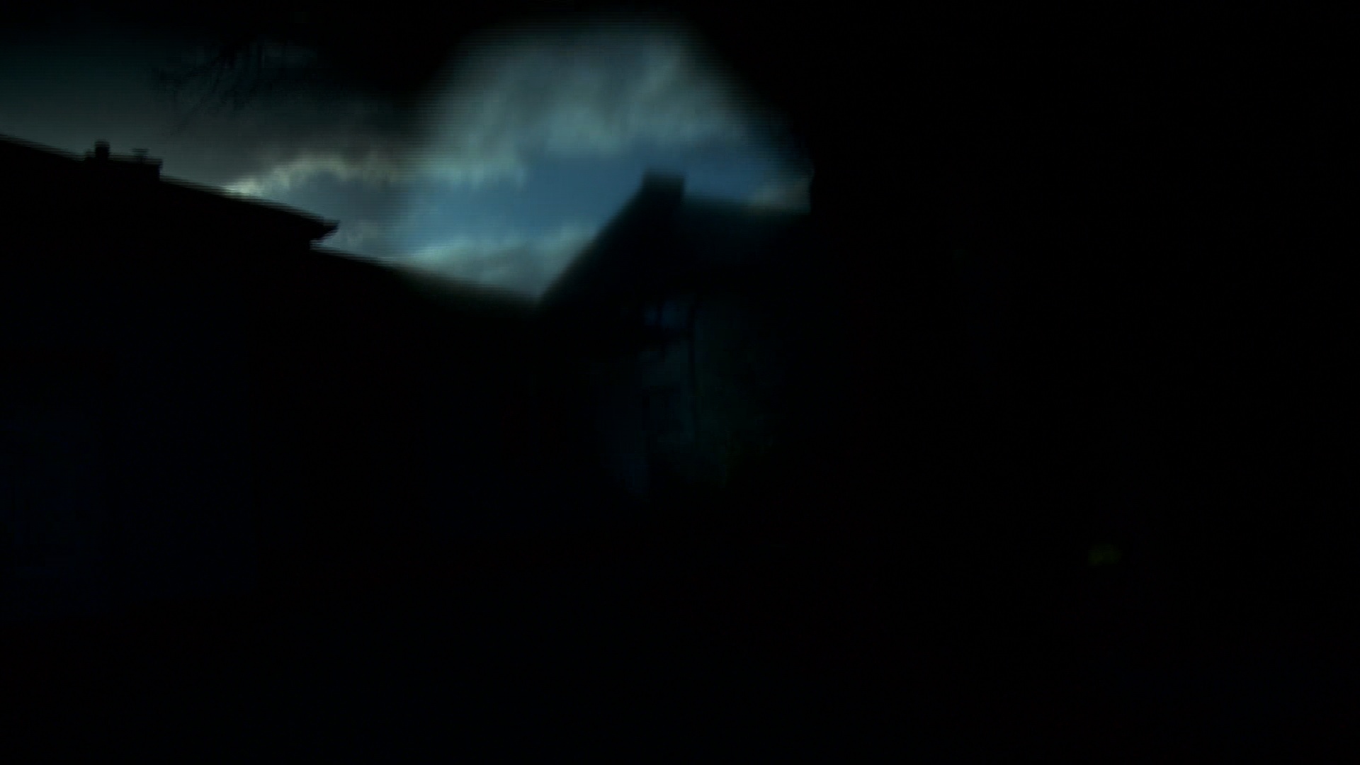

Has anyone noticed how the ND filter mechanism may stay in an in-between position, or how it opens/closes? I wonder if the "optical path alignment" wasn't in fact ND filter mechanism adjustment... My lens never shows any trace of vignetting as described by early adopters, but here is what I spotted today:

OMG! It's the mother of all vignettes returned with a vengeance!!!! ;)

Imagine if Vin Diesel was that big in frame.

Wow Piotr, you're "bad luck to a hunting dog!"
Does this happen everytime you use your ND filters?
I've never seen this...
Ive seen this happen on my camera once, but you just flick the ND off/on and its gone. It stays in between the modes and i think that causes it as Piotr says. I sure was afraid that now its broken when it happened!
