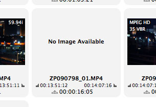

Sure. I was using a MxR adapter, with a Transcend 16GB class 6 card.
Everything seemed to go normally with the shoot, we were doing several on-cameras with talent. Later that evening, I went to download all the cards to two separate LaCie Rugged drives (one for backup) which I then deliver to the client. Everything downloaded perfectly using Clip Browser (version 2, CRC enabled). I then decided to look at some of the takes in File Transfer (because it's a better interface for viewing) and when I tried to bring that particular BPAV folder into File Transfer, it would display a dialog box saying something about that one clip was not recognized. There was no thumbnail image for it in File Transfer either. (I can't remember the exact wording, but I still have that card and can replicate it again). I tried several times to import the files into File Transfer from both drives, and got the same result every time with that one clip. I then tried a third drive, (another LaCie rugged, this time a 7200rpm field edit drive) and tried to import it into FCP, but no go.
The weird thing is the clip played perfectly in Clip Browser. The good thing was that it wasn't a 'good' take, so no big deal.... but it sure could have been a keeper, in which case I would have had some explaining to do.
Anyone have any ideas? I'll try to replicate it today before I erase that card, so I can get the exact wording of the dialog box....

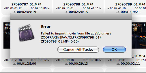

Here are the error messages I got when trying to import that one clip. I believe I have the latest version of XDCam File Transfer, but I'll double-check.
I got these errors directly from the card, so that rules out Clip Browser..... the problem must be either something weird happened with that single clip, or with File Transfer.

I would NOT use XDCAM Transfer directly on the cards. If the file is damaged you've damaged your master. Copy to hard drive FIRST with ClipBrowser.
If you aren't backing up those BPAV you're walking into an accident waiting to happen . . . or maybe it has already for you.
I'm seeing an issue to XDCAM Transfer 2.9 in which it takes a while for the image to appear and be playable. It's as if there's a slow import/thumbnail buffer. If I wait a short bit it'll eventually work.

Derek,
Did you ever try to copy the bad clip to another card in the other slot? Perhaps that would make it a new clip with it's own BPAV folder.

Turn the camera on in Media mode(not camera). Look to see if you see all of the thumbnails displayed on the lcd screen. Select the "bad" clip and click on it using the joystick or the thumbwheel. One of the menu options that will pop up will be "copy clip."
Select that option and then it will give you a larger window that says "copy clip A>B" (actually it says A arrow B, but I don't have an arrow on my keyboard). Push execute and you're done. Of course you need to have a card in the B slot before you do this. Then try clip browser with the new clip.
