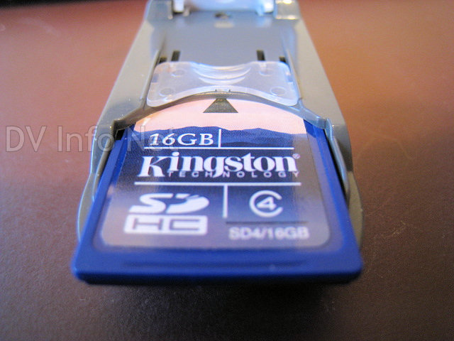

What if it didn't have an open slot at the end (like a traditional adapter), but instead it's an Express card shell that you could open up, and install whatever size SDHC card you want inside of it? That way you could upgrade the card capacity easily... or remove it, whenever you need to... the adapter is still a separate piece, but a bit more secure without an open slot... thoughts?
Fine by me.
In fact, it is even better than some other adapters that employ push in - push out mechanism for the cards. Those pose problems since pushing on the card while the combo is inserted into EX1 would dismount the card but may produce EX1 communication error with the combo.
Chris's adapter would not have such problem.
Now, define "install" please :)
Alex Raskin is offline   Reply With Quote
Old December 7th, 2008, 03:37 PM   #1273
Posts: 27,382
Just an idea for having the best of both worlds... Express card memory where you can change out the memory yourself, and that memory module happens to be an SDHC card... if it's easier just to have a traditional adapter with an open slot then so be it, but I thought a fully enclosed shell might have some appeal.

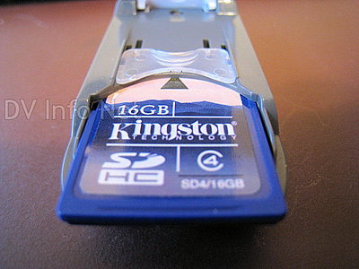

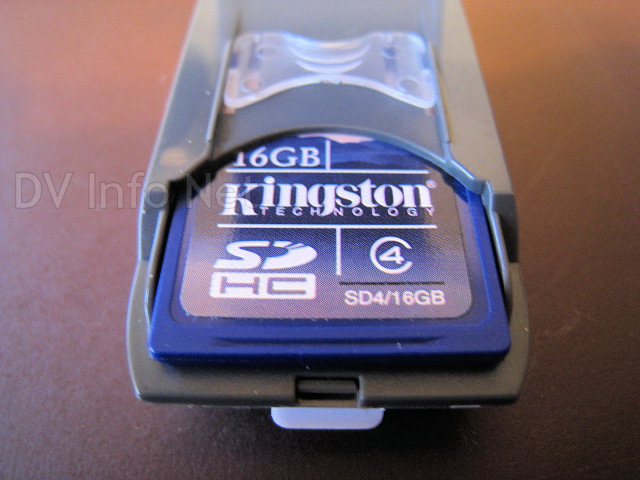

It would be dead easy... I have a Kingston MobileMate USB card reader that fully encloses an SDHC card. Flip the lid open, and you slide the card in. There's a plastic thumb-push thingy that pushes it back out again -- see pics below (click for larger versions) showing the card fully inserted, and pushed out for removal. I was thinking the Express card shell could be made up in a similar way.
