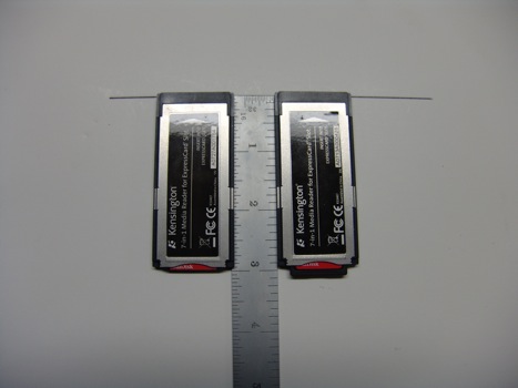

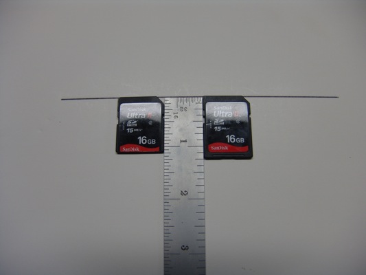

After viewing the individual who was kind enough to post his video on how to ( Cut ) a Ultra 2 SDHC card in order for you to close your EX-1 door, i took it upon myself to do the same.
But with a little twist. Instead of physically cutting the card, i took it and ground off the exses plastic on with my bench grinder.
Now i have 2 cards i can still easily remove from my Kensington adapter AND close my EX-1 door.
I have to tell everyone here. This was so simple it amazed me. Took me all of 5 minutes to do 2 cards.
Tested the cards up to 50fps. Zero problems. I will post pic,s shortly.

Left photo is side by side comparison of modified and unmodified cards.
Right photo is side by side comparison of modified card in Kensington adapter and unmodified card in Kensington adapter.
Card was modified using a bench grinder.
Now my EX-1 door closes. JOY!

Don't try this at home kids this video was done by a trained professional Card shaver...lol
I think I will wait on the Delkins although it want have any effect on the SanDisk card it’s all plastic from the back end to the logo.
