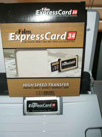

Delkin ExpressCard 34
Originally Posted by Brian Rhodes View Post
Originally Posted by Rob Fiedler View Post
I believe this is other Delkin Card.
Thats the pic from the box same pic is on the version one and version two box you will have to look at the actual card.
Hi Brian. Just to confirm. Here is a shot of the box and the enclosed card. This Delkin card (with no logo) seems to work. The Sandisk extreme snaps in flush and the door on the EX1 closes. The number on the box for the Delkin efilmExpressCard34 is DDEXP34-6in1-1
I got mine from Adorama at 34.95
Thanks for all the great info on this forum
Rob Fiedler is offline   Reply With Quote
Old December 1st, 2008, 05:14 PM   #1164
Location: Gilbert, AZ
Posts: 1,896
Be careful on ordering the Delkin expresscard.
It has been reported that it appears the card that works is actually the older card.
The newer card has the logo DD which does NOT work.

The door closes on the EX1 with the "correct" Delkin card.
