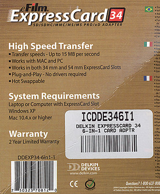

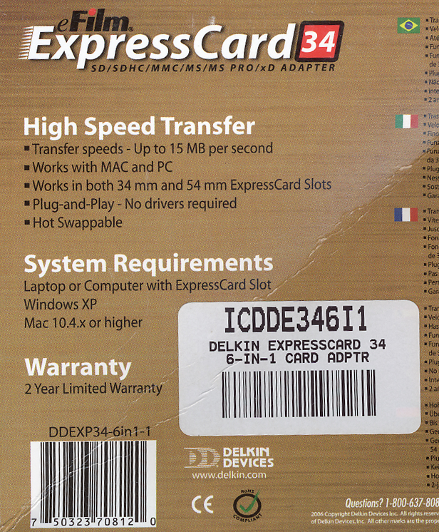

You can't go by the picture on the packaging. They may use the same packaging for both. You have to see the actual card inside. The correct card has "e-film" on it, not the "DD" logo. Here's a scan of the back of the packaging for the correct card - note the product number.
Ronn Kilby is offline   Reply With Quote
