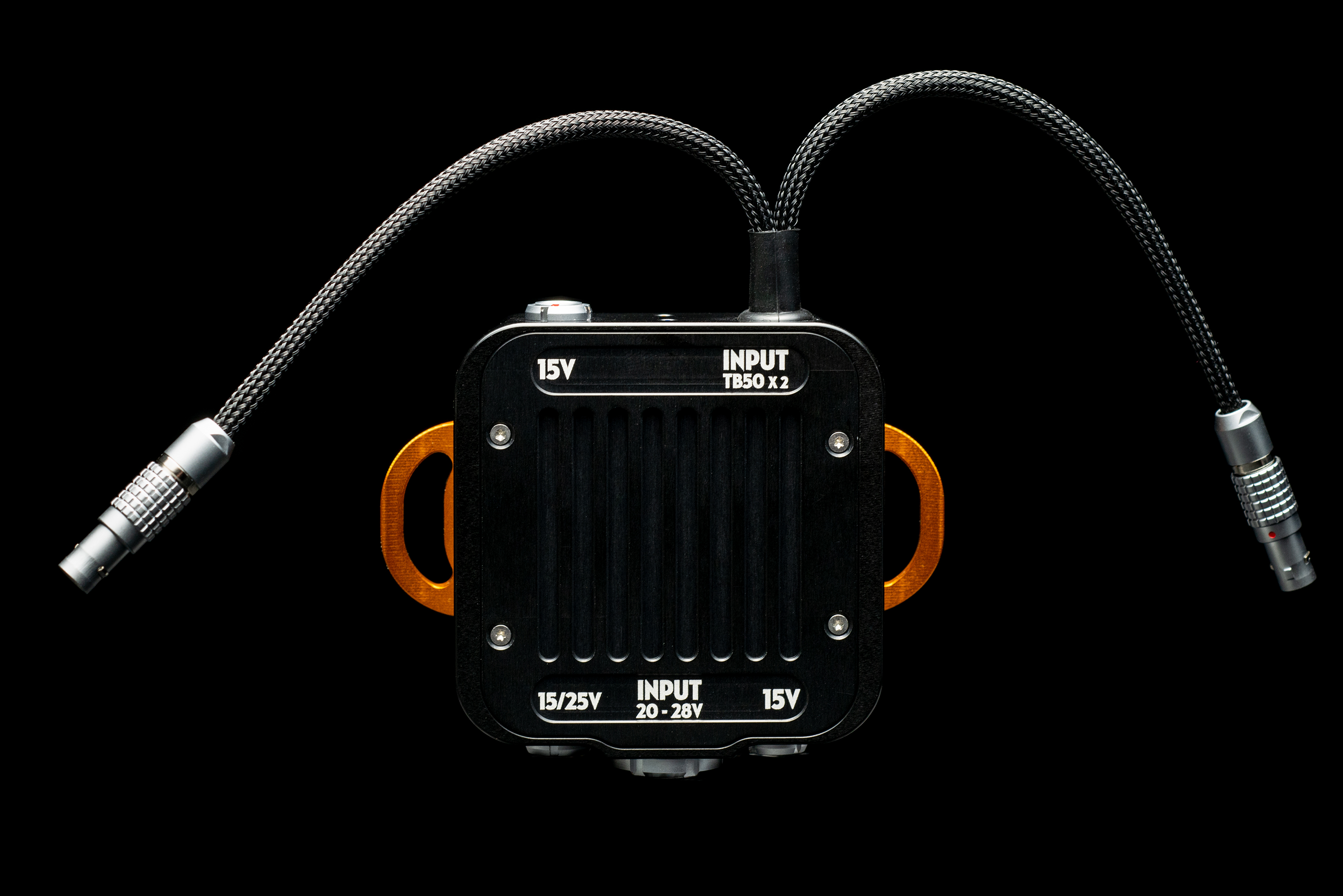

Introducing the TB50 Hammerhead: Dual Smart Battery Adapter
tb50_Hammerhead_ignite_digi_4
The Hammerhead is a first of its kind, featuring 15V and dual voltage 15V/20-25V outputs giving users the ability to power any high draw camera setup. USB-C (PD) and USB-A (QC) outputs have also been integrated for charging laptops, phones & other accessories on set or in transit. Powered by DJI’s intelligent TB50 batteries, each battery is travel friendly (97.58Wh each) and can be hot-swapped on the Hammerhead. You can also use the 20-28V DC input to power the whole system from the 28V output of a VCLX block battery or 24V power supply.
Key Features:
  • Simultaneous 15V and 20-25V Lemo power outputs.
  • 2 x 2 pin Lemo Outputs: Regulated 15V up to 100W total.

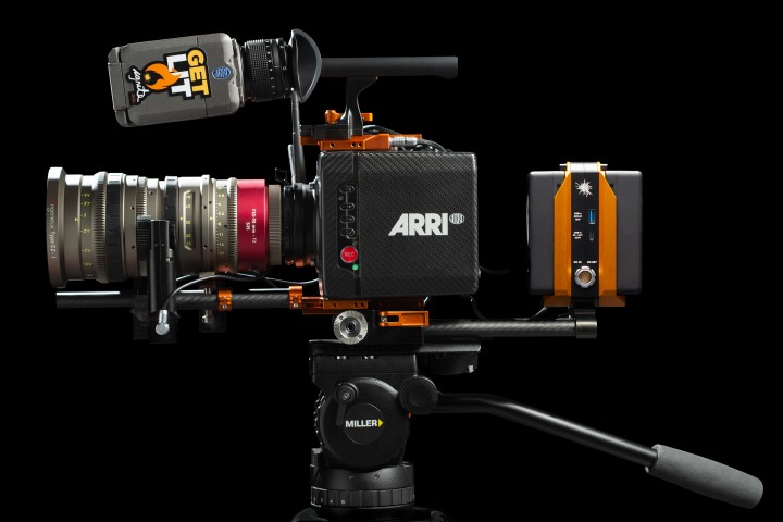

  • 2 x 3 pin Lemo Outputs (not Fischer): regulated 15V & unregulated 20-25V on different pins, designed to be used for powering cameras. Ignite Digi camera cables are wired to give the camera the correct voltage: 15V for RED DSMC2 and 20-25V for Alexa Mini/Mini LF.

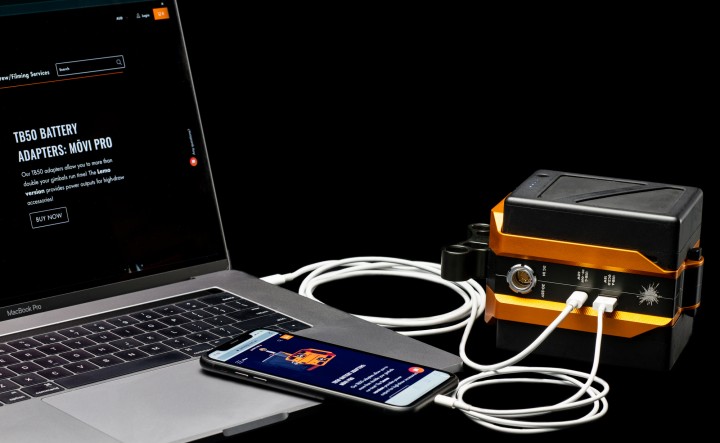

  • 1 x USB-C PD Output up to 60W for powering/charging your laptop, phone, cameras like the Panasonic S1H & accessories such as Sound Devices MixPre II.
  • 1 x USB-A 3.1 (QC 3.0) Output up to 18W for charging your phone and accessories when travelling or on set.
  • Powering the TB50 Hammerhead with 2 x TB50 batteries = 195 watt-hours (Wh) total. This will power a RED DSMC2 or Alexa Mini with accessories for 2.5 – 3 hours.
  • Batteries are hot swappable: you can keep everything powered during TB50 battery changes and when plugging in/out VCLX batteries or power supply on the 8 pin DC input.
  • Compatible for air travel with each TB50 battery under <100Wh.
  • TB50 intelligent batteries are 97.58Wh each, 195Wh per pair.
  • Designed, manufactured and assembled in Australia by Ignite Digi.
  • 1 x 8 pin Lemo INPUT socket: 20-28V DC input. eg.: from VCLX block battery (3 pin XLR 28V) or a 24V power supply.

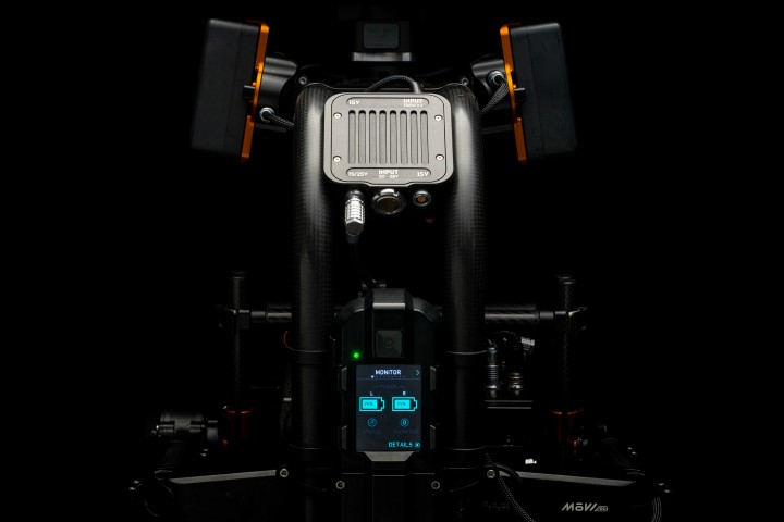

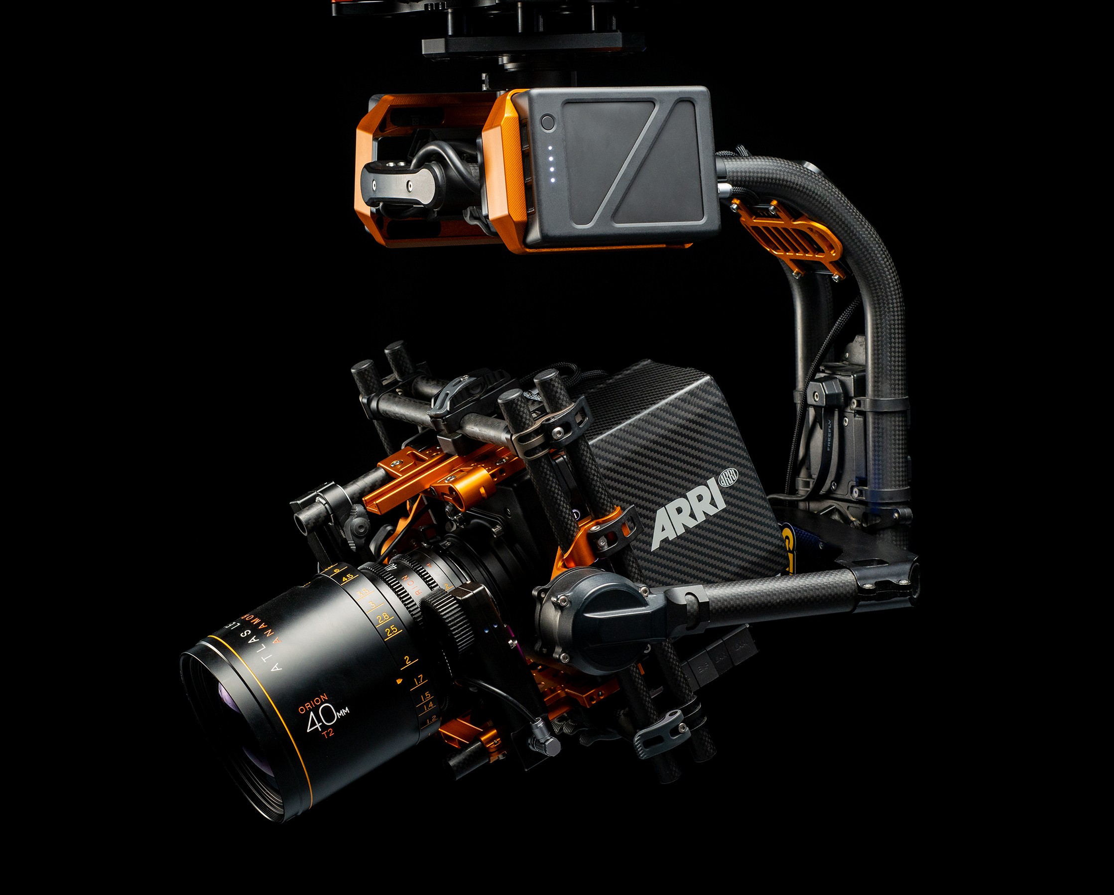

The Power Expansion Pack has been released as an upgrade extension to Ignite Digi’s TB50 Adapters for MōVI Pro. Ignite Digi’s TB50 Adapters double the run time of the MōVI Pro gimbal, with the new Expansion Pack taking power from the TB50 adapters 20-25V Lemo outputs. Positioned on the gimbal’s spine, the Power Expansion pack provides MōVI Pro users with a range of additional outputs and will power any camera & accessory package users could possibly run on the gimbal.
Key Features:
  • 1 x 3 pin Lemo Output (not Fischer): regulated 15V & unregulated 20-25V on different pins, designed to be used for powering cameras. 3 pin camera cable included: wired to give the camera the correct voltage: 15V for RED DSMC2 and 20-25V for Alexa Mini/Mini LF.
  • 1 x 8 pin Lemo socket: 20-28V DC input. eg.: from VCLX block battery (3-pin XLR 28V) or a 24V power supply.
  • Lightweight design: 280 g (9.8oz) including the 3 pin feed cable.
