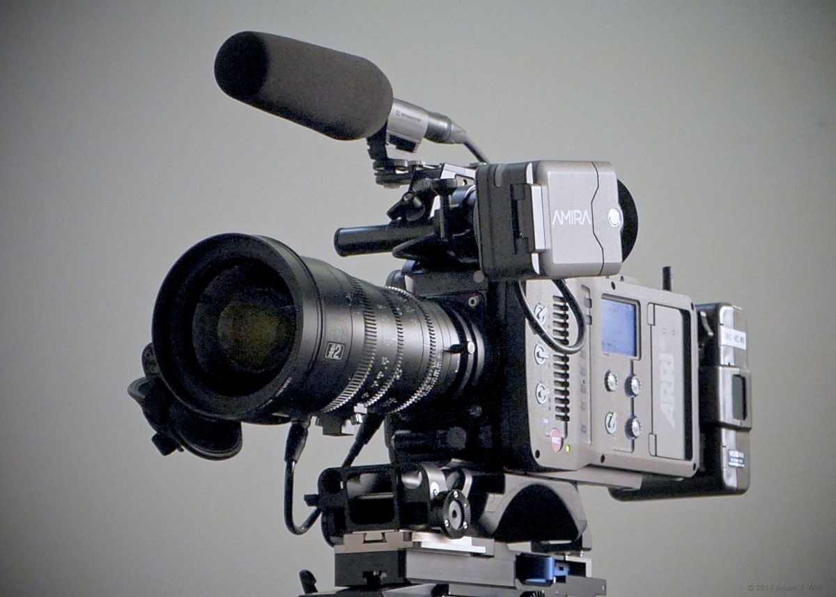

Last Wednesday, Videofax in San Francisco hosted Arri’s Snehal Patel, who showed off Amira, “the new documentary-style camera” with the heart of an Alexa.
Arri Amira with Cabrio 19-90mm. Click any image for a larger version.

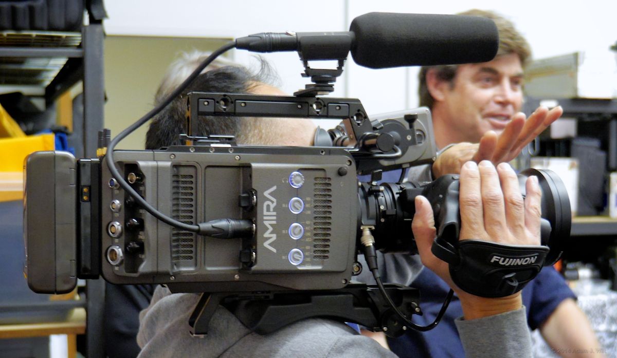

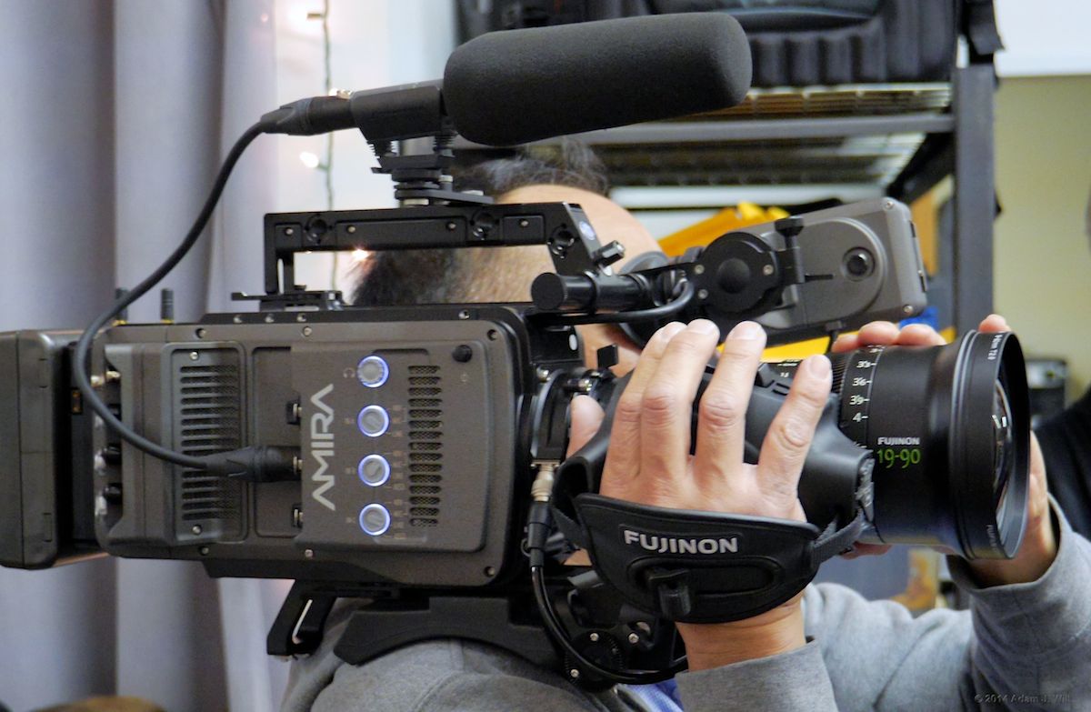

Amira is a tasty package: backlit physical switches and controls, so it’s tactile like a broadcast cam, though the switches don’t replicate broadcast-cam layouts. Audio setup on the right side, operational controls on the left side, so it’s optimized for a shooter to use unassisted.
Operator's side view
Operator’s side view

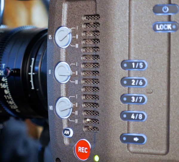

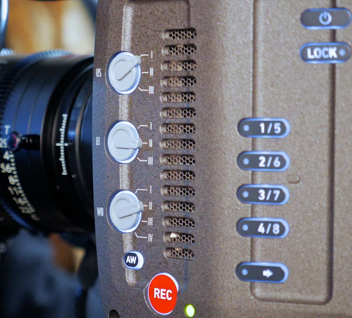

Front switches: US (?), EI, and WB, plus Auto.

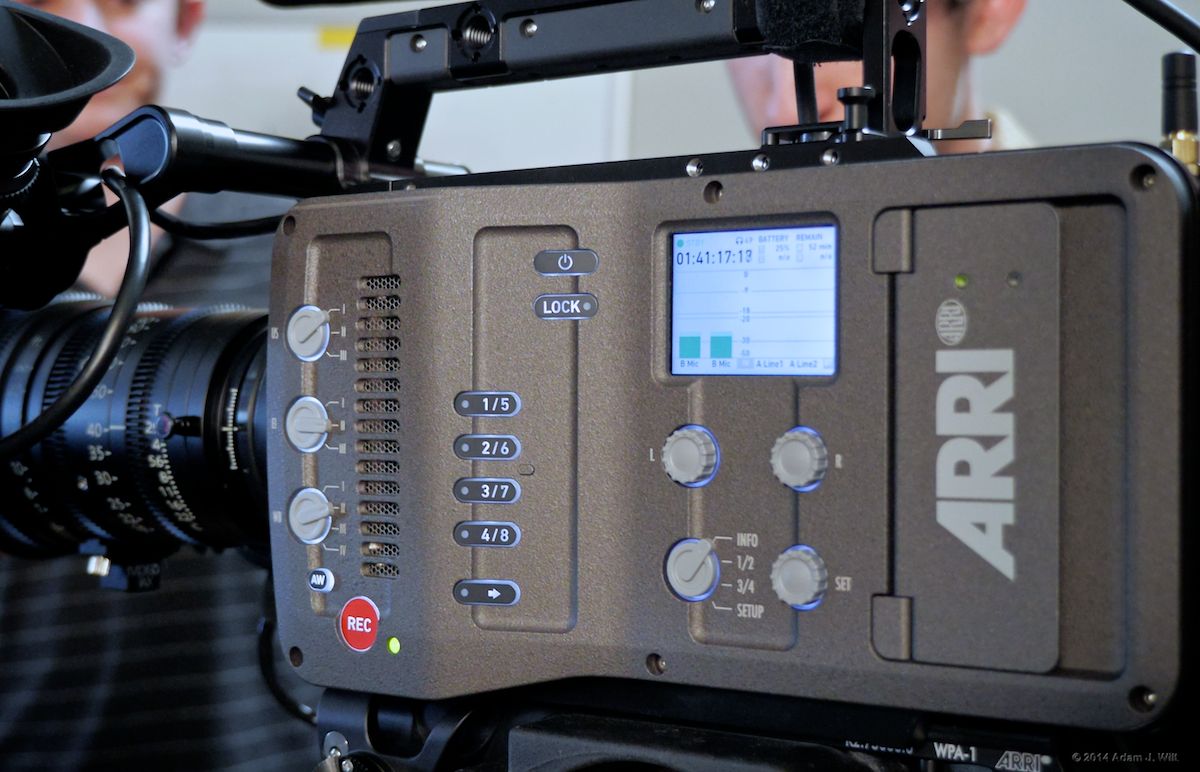

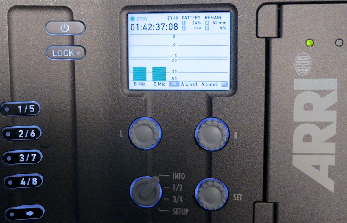

Operator-side menu panel and audio controls.
Operator-side menu panel and controls.

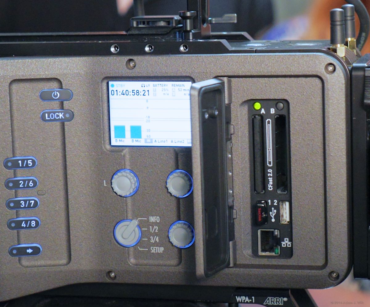

CFast card slots, plus 2 USB ports and Ethernet.

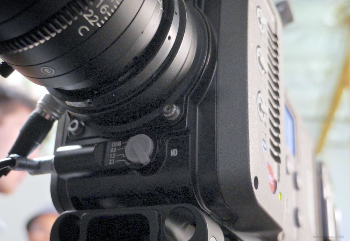

ND filter switch.
ND filter switch.

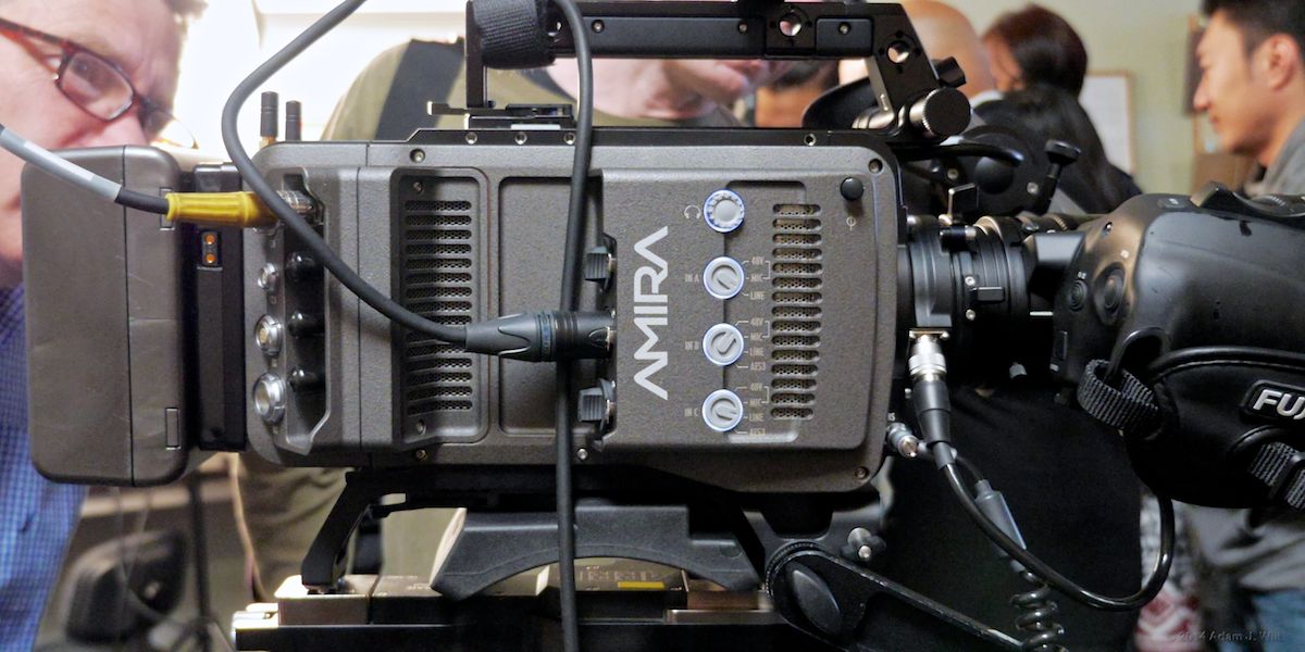

Audio-setup controls and connectors: two 3-pin XLRs plus one 5-pin XLR. Video I/O at the back.

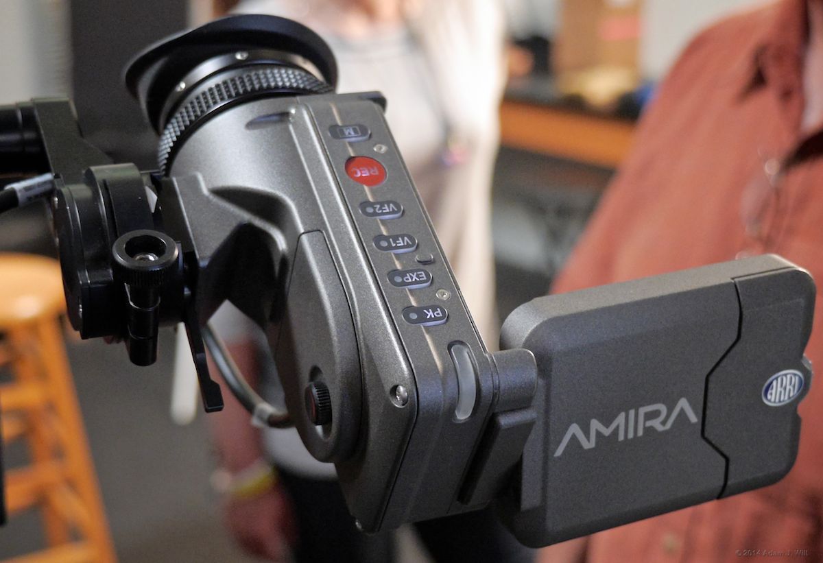

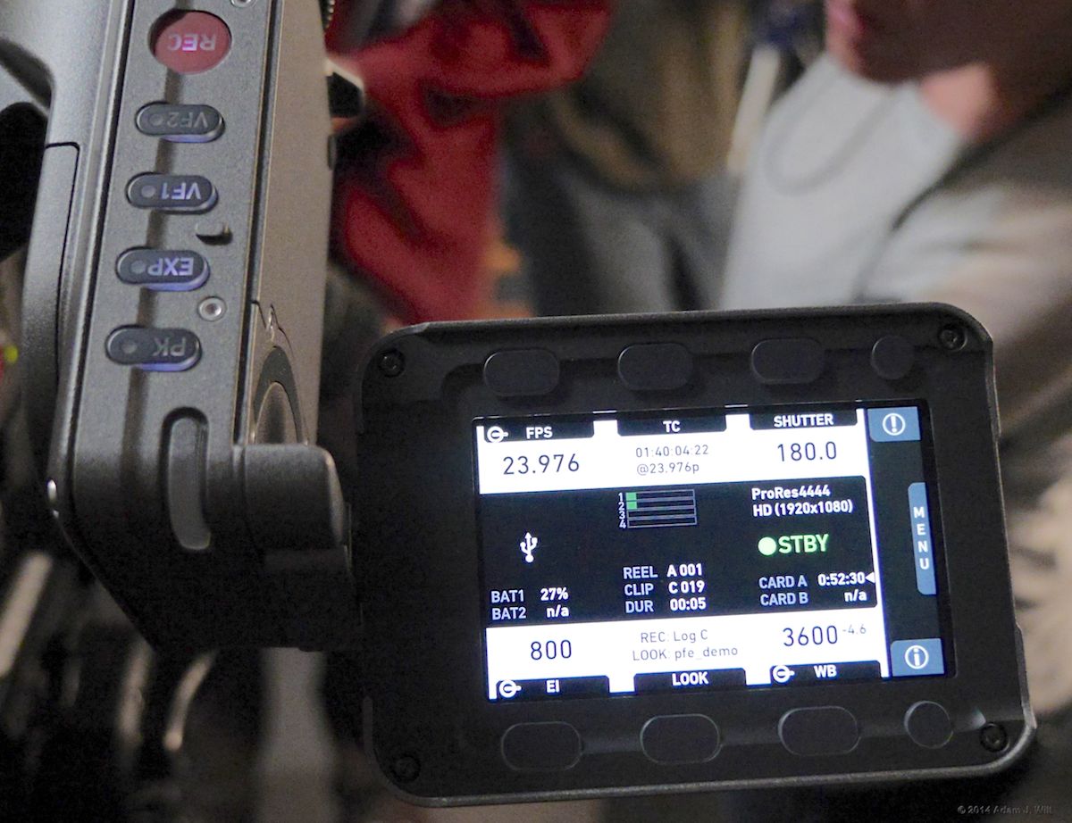

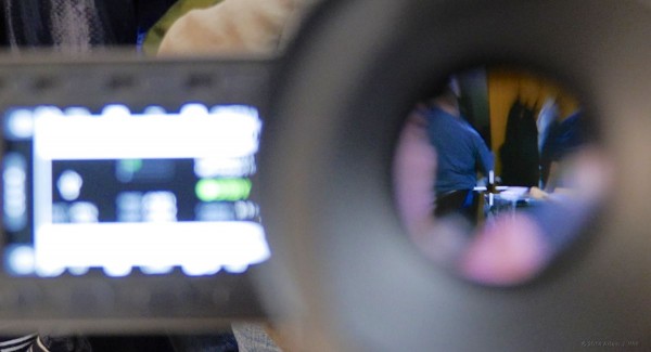

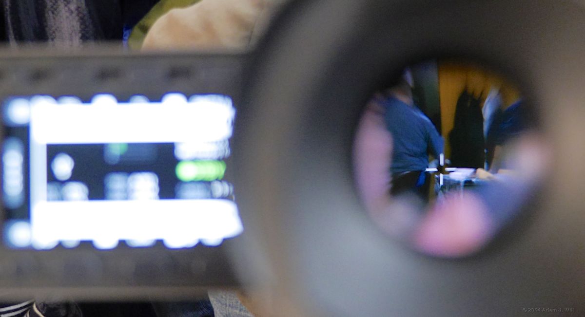

Excellent OLED EVF with flip-out LCD panel, configurable as either a menu display or a picture display, and with both backlit buttons and a side-mounted selector wheel for controls. This EVF/LCD panel assemblage allows full setup and control by the operator while the camera is resting on the shoulder, for a streamlined, uninterrupted workflow.
Amira EVF/LCD with LCD flipped open.
LCD can be flipped around, folded back against EVF either open or closed.
LCD can be flipped around. Note the buttons above, below screen.
With an eye to the EVF, the LCD keeps camera menus available at a glance.
Selector wheel complements buttons for full shoulder-mounted control.

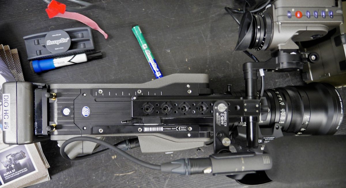

EVF mounts to top handle, which can slide back and forth a few inches. The shoulder pad also slides back and forth a few inches. Unlock both, and the camera/lens package can move while keeping EVF and shoulder pad in the same place, making for very flexible and wide-ranging balance adjustments. Videofax had the 19-90mm Cabrio on it and it balanced perfectly with room to spare; a 24-290mm Optimo would be a challenge (grin) but any sensible handheld lens should balance up without issues.

Compared to Alexa: no 4×3, no raw, no mirror shutter. Lighter (11 lbs for body, pad, handle, and EVF), and about half the power draw. Records on CFast cards instead of SxS. ProRes only.
Still, like the F55 in the ENG build-up kit, it’s a hefty heifer on the shoulder. One comment: “looks like an SR3, feels like a BL3.”
