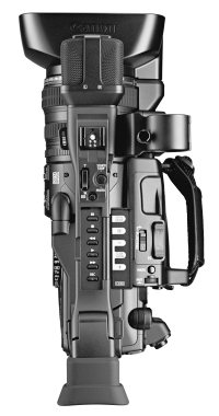

Is this an XH A1 or an XH G1? See where the pro BNC jacks go, down at the lower right... this is an XH G1.

Like its big brother XL H1, the new XH G1 provides uncompressed SD and HD video output at 1.485Gbps over SDI (Serial Digital Interface), as well as GenLock input and Time Code input and output. The XH G1 is equipped with a single switchable BNC jack for Time Code, compared to the XL H1 which has two BNC jacks for Time Code.

The XH A1 is in every way identical to the XH G1, except the A1 does not have the SDI, Genlock or Time Code BNC jacks that are on the G1. This and the price are the only differences between the two cameras. The XH A1 will sell for $3999. The XH G1 will sell for $6999. Both camcorders ship in Q4 2006, around October and November.
The only difference between the XH A1 and the XH G1, besides the price… the XH G1 (right) has the professional BNC jack cluster with SDI output, GenLock input and Time Code input and output. The XH A1 does not.
