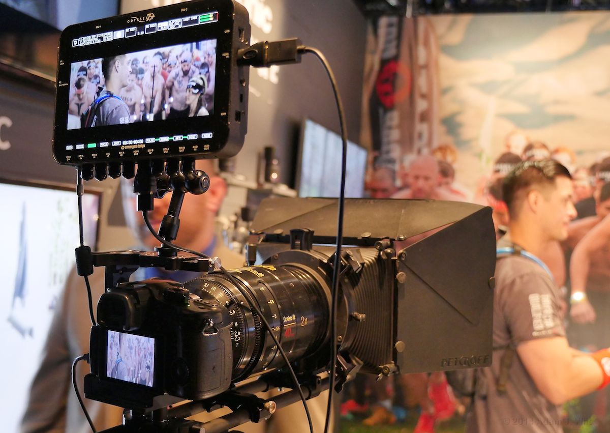

GH4 with a Cooke 2x anamorphic prime and Odyssey 7Q+ monitor/recorder on the Panasonic stand at NAB
Sadly, the camera will not “desqueeze” the anamorphic image in its EVF or on its monitor — the internal processing is already being pushed to the limit — but Convergent Design has announced desqueezing in an upcoming Odyssey 7Q+ update; the demo unit on the GH4 also fed the desqueezed image to a separate monitor.

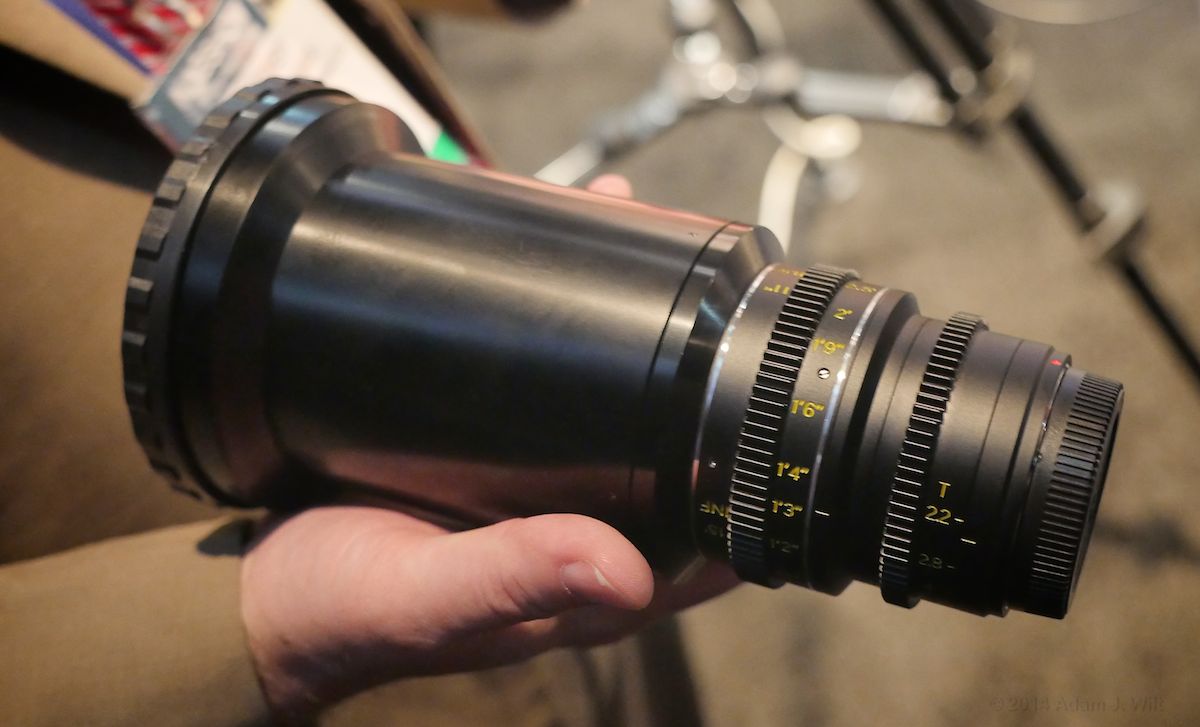

By a fortunate coincidence, Veydra announced the development of 2x anamorphic primes in MFT mount, starting with a 25mm, of which this is an early mockup:
Veydra 25mm 2x anamorphic prime (mockup)
Veydra anamorphics will cost under $5000 each, rather less than the Cooke in image above!

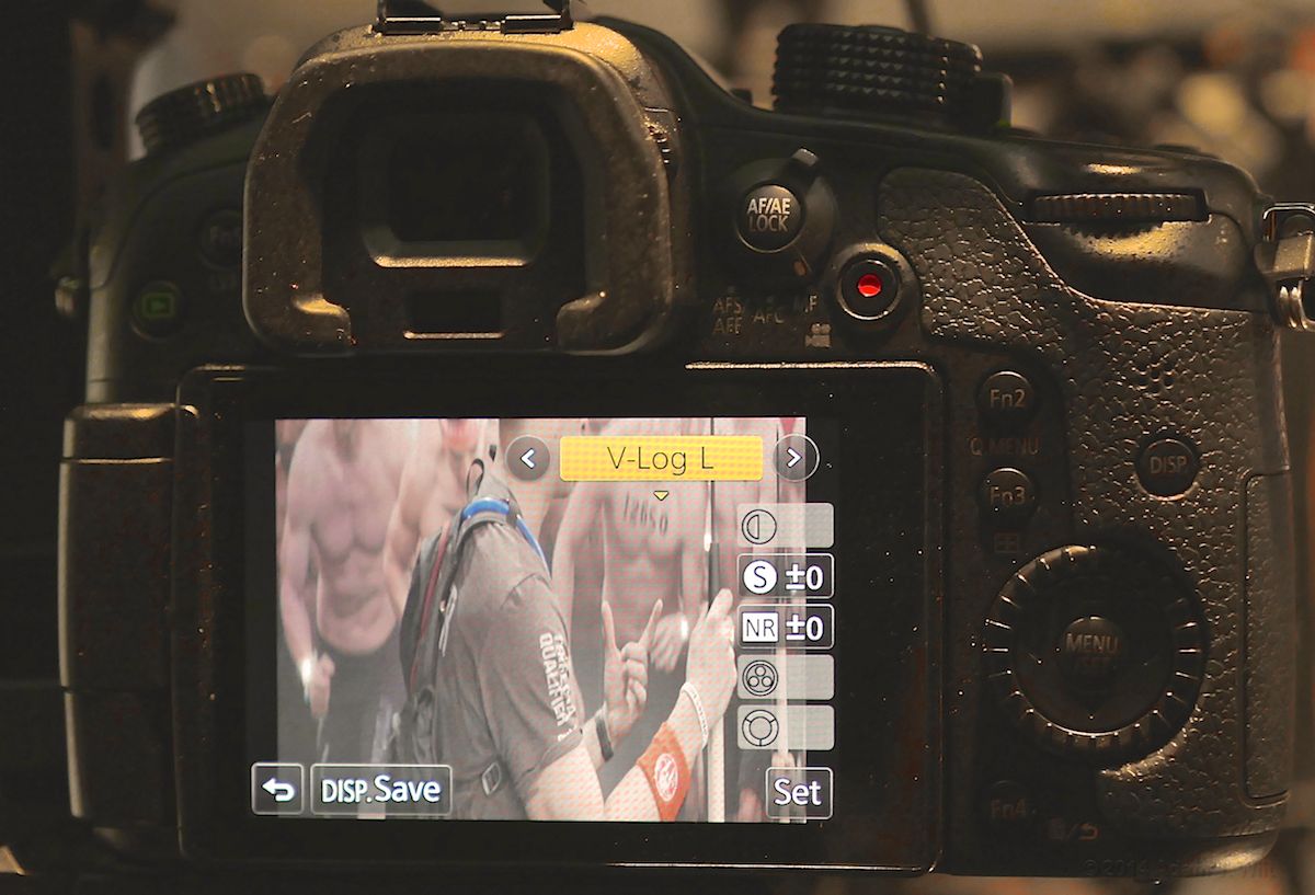

Also shown: V-Log gamma. This won’t be in the next release, but in a subsequent one later this year. It is claimed that V-Log will extend the dynamic range of the GH4 by 2 stops, and improve the look of highlight handling considerably.

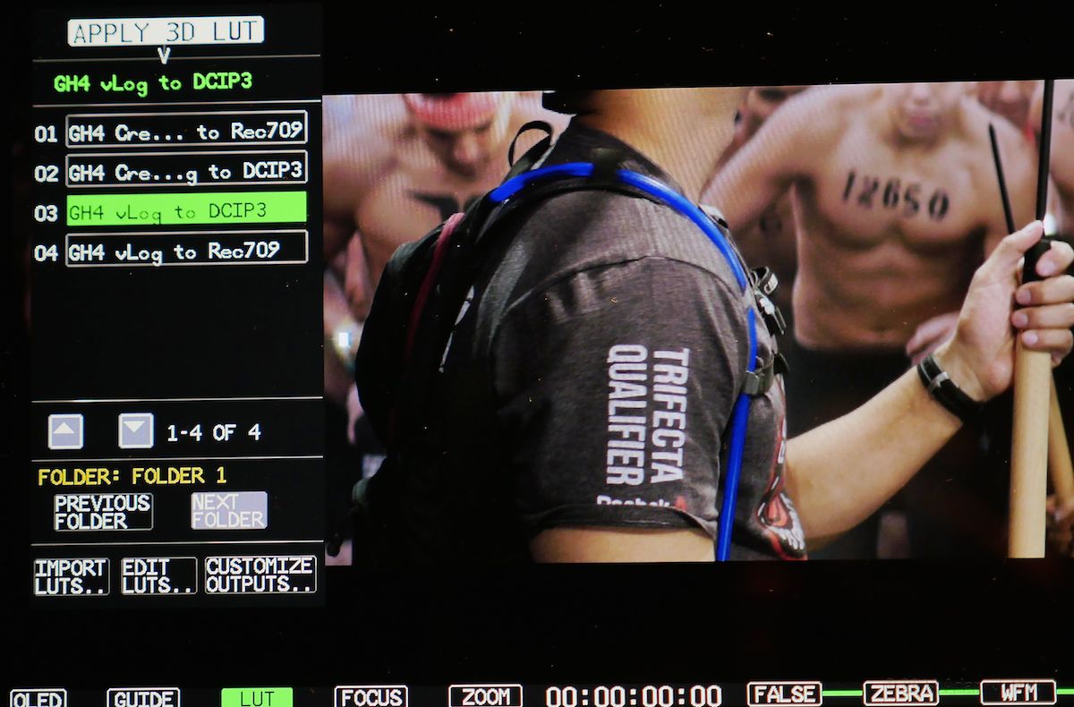

The Odyssey 7Q+ will offer LUT support as well as de-squeeze:
