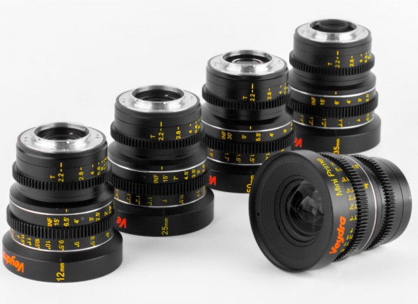

On Tuesday night, a Kickstarter project showed up in my Twitter feed: Veydra Micro 4/3 Cinema Lenses. Veydra lenses (12mm, 16mm, 25mm, 35mm, and 50mm; micro 4/3‘s counterparts to 18mm-85mm primes on Super35mm sensors) will all feature
- Resolution that exceeds 4K
- Cinema 0.8 module focus and iris gears
- Consistent front 80mm outside diameter & 77mm filter threading
- Similar lengths and gear positions for quick lens changes
- Constant T2.2 apertures
- Plated brass mounts for durability.

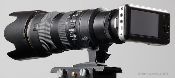

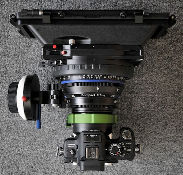

Ryan Avery: I am an active user of Twitter, which I use to keep in touch with lots of filmmakers around the world. Every week I would see people posting images of their BMPCC cameras with all kinds of gear and these HUGE lenses strapped to them via an adapter. I decided there had to be a better way, and purpose built lenses appropriate to the camera size came to mind. I like to think we are solving a problem most didn’t even know they had.

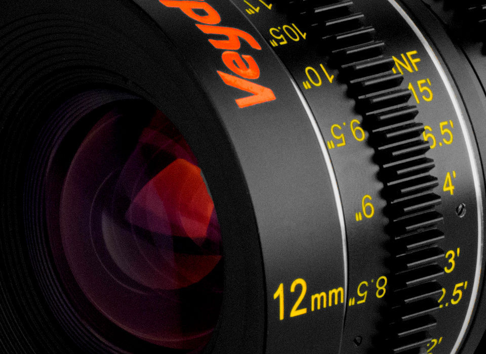

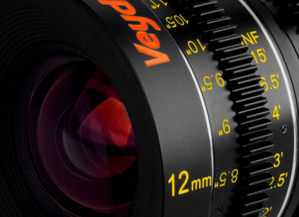

Ryan Avery: Yes, but they serve a purpose. We added the small chrome V channels there for a reason. Every camera has a slightly different flange focal depth, which would have been nearly impossible to design for perfect focus marks every time. We added the chrome V channel there so people can paint in their own exact marks for their camera if they choose. If a customer doesn’t want to do that, then they can just use the wider witness marks we provide on the lens barrel.

Also note that these lenses feature adjustable back focus via removing a couple screws on the focus scale and you can slide the infinity mark to your camera’s flange focal depth. I believe that is a first in cinema lens design and will overcome the the varied mount manufacturing tolerances of many cameras.
