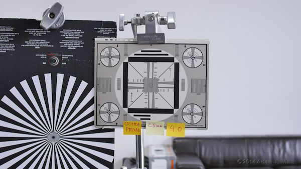

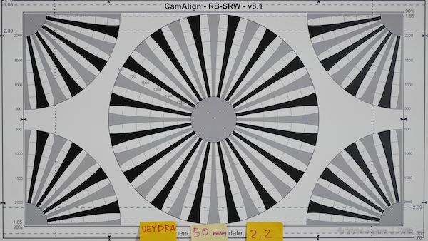

TV chart tests at Chater Camera: for each nominal focal length (16, 25, 35, 50), a TV chart was framed to fill half the screen horizontally & vertically, using the Veydra lens of that focal length. All other lenses at or near that focal length were shot from that same distance, so chart size and angle of view will vary slightly. The GH4 was set on “Natural” picture style with sharpness at -2. Lumix 12-35mm used for 16, 25, 35mm; 35-100mm only used for 50mm. Aperture sequences: wide open, 2.2, 2.8, 4, 5.6, as appropriate (no full sequence on the GH4 / Rokinon 24mm combo: aside from T1.5, images were all blurry; focus was obviously incorrect). Exposed using natural (and variable) light, so exact exposures and colors can’t be compared.
What to look for: compare lenses wide-open; compare lenses at similar f/ or T-stops. See how the angle of view at any distance varies between lenses of the same or similar marked focal lengths.

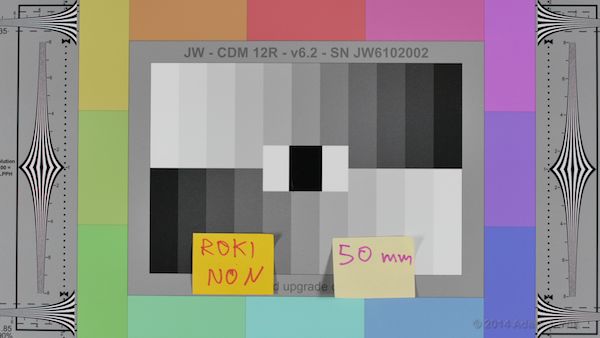

V3-P1030747
ChromaDuMonde shots all captured at f/4 or T4, constant (theoretically identical) exposures on all lenses. Fixed white balance set using Veydra 50mm under fixed lighting (Kino-flo 5600K tubes with over an hour’s warm-up). Lumix 12-35mm used for 16, 25, 35mm; 35-100mm only used for 50mm. No attempt made to replicate framing: I tried to make the color patches fill the screen vertically but didn’t aim to perfectly frame the shots.
What to look for: differences in color rendering and exposure from one lens to the next.

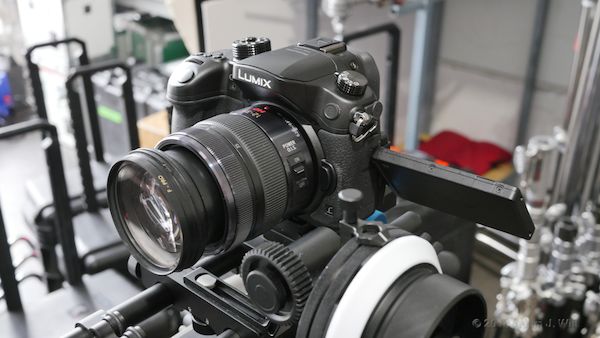

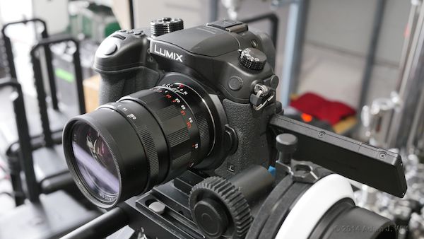

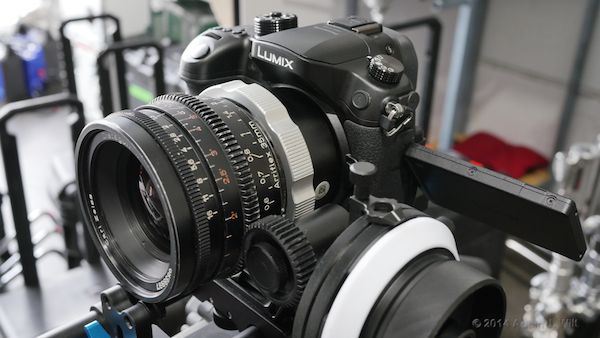

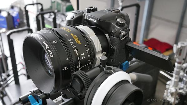

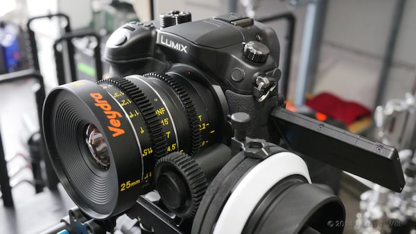

And here’s a visual comparison of the 24 & 25mm lenses I used in these tests:
V3-P1030643

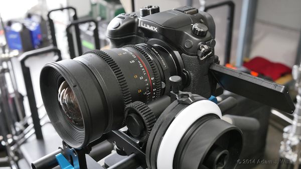

Arri/Zeiss Ultra Prime 24mm T1.9
V3-P1030644
Arri/Zeiss Super Speed 25mm T1.3
V3-P1030645
Veydra Mini Prime 25mm T2.2
V3-P1030646
Voightlander Nokton 25mm f/0.95
V3-P1030647
Samyang/Rokinon Cine DS 24mm T1.5
V3-P1030648
Panasonic Lumix 12-35mm f/2.8
Normally I’d wait to post all this gumpf until I had a proper article ready, but I wanted to get this up for those trying to decide about getting in on the Kickstarter deal, now over, alas. You can still place pre-orders at the normal price with a small deposit at either Duclos Lenses (for the 5-lens set) or Hot Rod Cameras (4- or 5-lens set), or order directly from the Veydra website.
