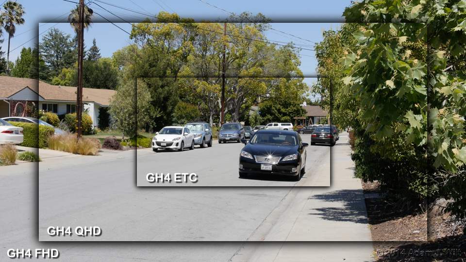

The GH4 uses a 4×3 CMOS sensor, 17.3mm wide, with 4608 x 3456 photosites. It has four video modes:
- FHD shoots 1920 x 1080 using the entire sensor width, binning and/or skipping and/or filtering the data down by some other method. The pix from this mode look very much like pix from the GH3’s FHD mode: not-quite-full-HD quality, with slight aliasing visible; yet still pretty much the best full-sensor spatial quality available in a stills/motion hybrid short of the Canon 1D C. Crop factor compared to Super35mm: about 1.44x.
- ETC (Extended Tele-Conversion) is a center-crop, pixel-for-pixel 1920 x 1080 mode, also seen on older GH series cameras. Less aliasing, but a much smaller sensor area (7.21mm wide, between Super8 and 16mm size, with a crop factor of 3.45x), and more likely to show noise at high gains.
- QHD, Quad HD (Panasonic calls this 4K), is a pixel-for-pixel 3840 x 2160 center-crop mode, 14.42mm wide, for a crop factor of 1.73x: a bit bigger than Super16mm’s 12.5mm-wide frame.
- True 4K (Panasonic calls this C4K) is a pixel-for-pixel 4096 x 2160 (17:9 aspect ratio) center-crop mode, 15.38mm wide, for a crop factor of 1.62x. C4K is only available when the camera’s system frequency is 24.00Hz. In terms of image quality, it’s exactly the same as QHD, only with a few more pixels stuck on either side.
(The camera also has 1280×720 and 640×480 modes when recording MP4 clips, but these legacy sizes aren’t available in the other formats, and I haven’t tested them.)

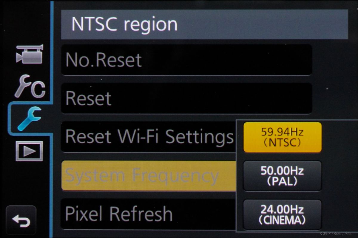

The camera offers a choice of three system frequencies:
“NTSC” mode allows frame rates of 24p, 30p, and 60p (actually 23.976p, 29.97p, and 59.94p), and both 1920 x 1080 and 3840 x 2160 frame sizes (though QHD is limited to 24 and 30fps). “PAL” offers 25 and 50 fps settings at the same frame sizes (QHD at 25fps only). “CINEMA” offers both HD and QHD sizes plus “C4K”, 4096 x 2160, at 24.00fps for all sizes.
The camera must be power-cycled when system frequency is changed. Also, the camera cannot play back clips shot at a different system frequency (or even delete them, it seems), though it will show you the poster frames for such clips. I mixed ‘n’ matched “NTSC” clips in multiple sizes and frame rates with “CINEMA” clips in both QHD and C4K on the same card, and had no problems aside from the “foreign frequency” playback and deletion issues.

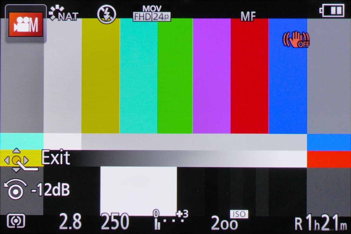

The GH4 allows ISO settings from 200 to 6400, or gain settings from -6dB to +24dB if you prefer. ISO 400 lines up with 0dB, from which I infer that the camera’s nominal sensitivity is ISO 400. However, shooting at 200 doesn’t appear to sacrifice any highlight headroom, so 200 appears to be an optimal setting: lowest noise without loss of latitude.

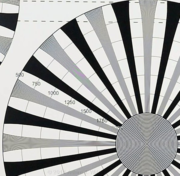

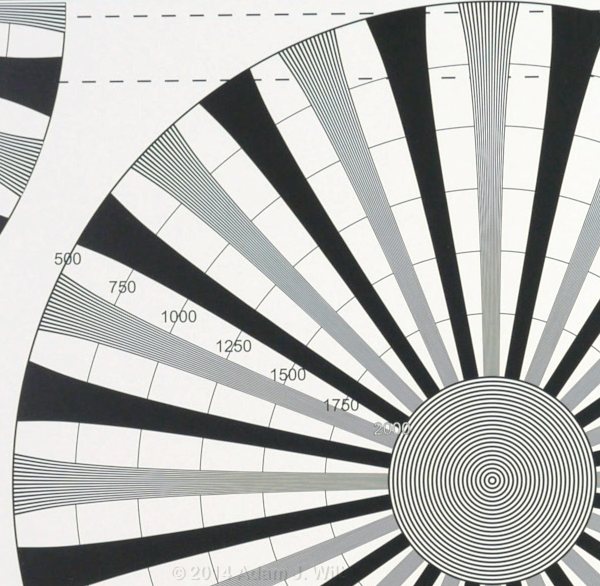

Let’s look at the resolution from the three standard shooting modes: FHD, ETC, and 4K. All were shot with default sharpening (e.g., 0, more than none (-5), but half as much as the camera’s eye-searing +5 maximum):
This looks pretty much like a GH3’s FHD image: around 675-700 TVl/ph or so, aliasing sets in. Chroma moiré is present, but at a low enough level that it’s not normally a problem. FHD images look sharp, but fine details or repeating patterns – fences, grilles, woven fabrics, roof shingles or brickwork seen from afar – will sometimes show a bit of coarseness and aliasing.

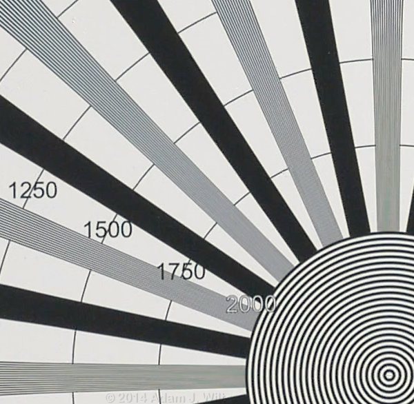

ETC mode looks like, well, any decent 1920 x 1080 Bayer-mask camera with a slightly under-aggressive optical low-pass filter: aliasing comes in around 800 TVl/ph, but at a low level.

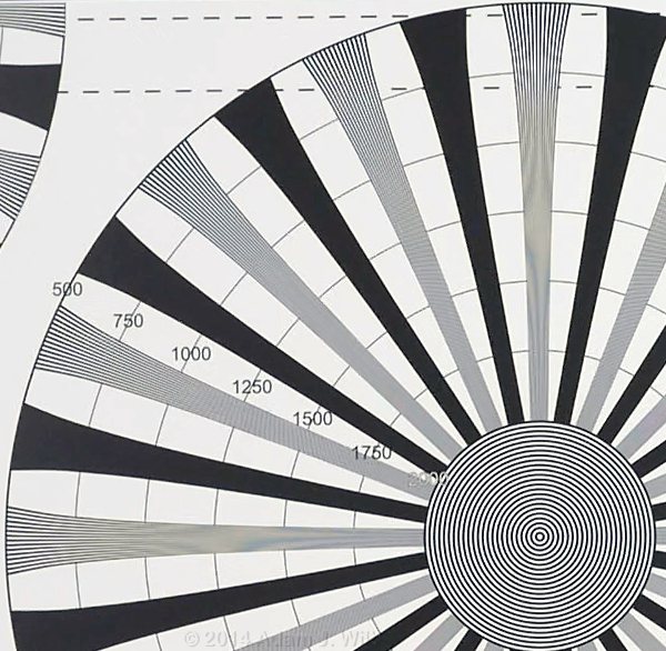

At QHD, the image is twice as big, and so the 1:1 extract is twice as zoomed in. As expected, the pix start falling apart at around 1600 TVl/ph, as it’s a pixel-for-pixel mode like ETC.
Tests shot at C4K (4096 x 2160 instead of 3840 x 2160) look exactly the same as the QHD shots.
Now the fun part: take that QHD image and drop it into a 1080p timeline. I used FCPX, but you can do the same in the NLE of your choice:
Yes, there’s still some slight high-frequency aliasing, but the resolution extends cleanly to 1080 TVl/ph – the Nyquist limit for 1080p – and look how cleanly the circles render, compared to either the FHD or ETC versions.

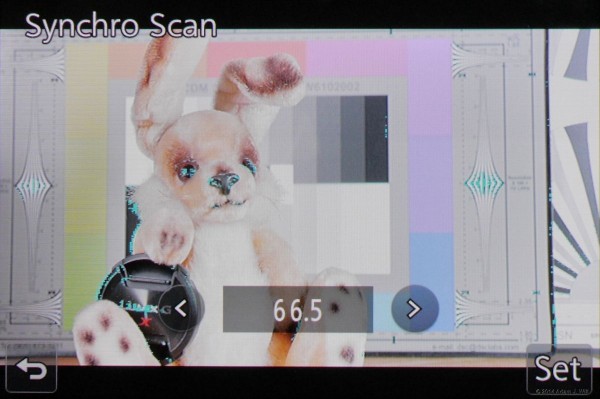

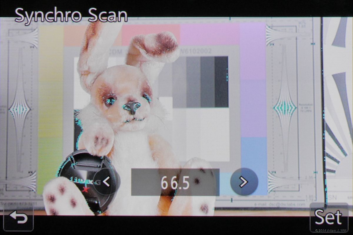

Rolling Shutter
Rolling shutter, a.k.a. jellocam, is a perennial problem with most CMOS cameras, and the GH4 is no exception. Fortunately, the readout time – the time it takes to read a frame from top to bottom – is reasonably quick; in the worst case (4K) the GH4 is as “bad” as a Canon 5D Mk II recording a mere HD signal.
FHD: 1/76 sec.
HFR: 1/113 sec.
ETC: 1/94 sec.
QHD: 1/45 sec.
4K: 1/46 sec.
C4K: 1/45 sec.
Except as noted, all speeds were determined by averaging measured jello on at least three samples of fast pans, at system frequency 59.94 Hz. All measurements for a given setup agreed within +/- 10%, with that error bar due to imprecision in measurement (I held a ruler up to my MacBook’s screen and measured only to millimeter-level accuracy) and to variance in pan rate from frame to frame. “HFR” means frame rates faster than 60 fps; “4K” means QHD @ system frequency 24.00 Hz; and “C4K” is 4096 x 2160 @ 24.00 Hz.

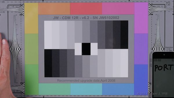

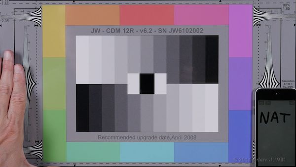

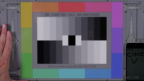

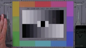

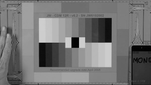

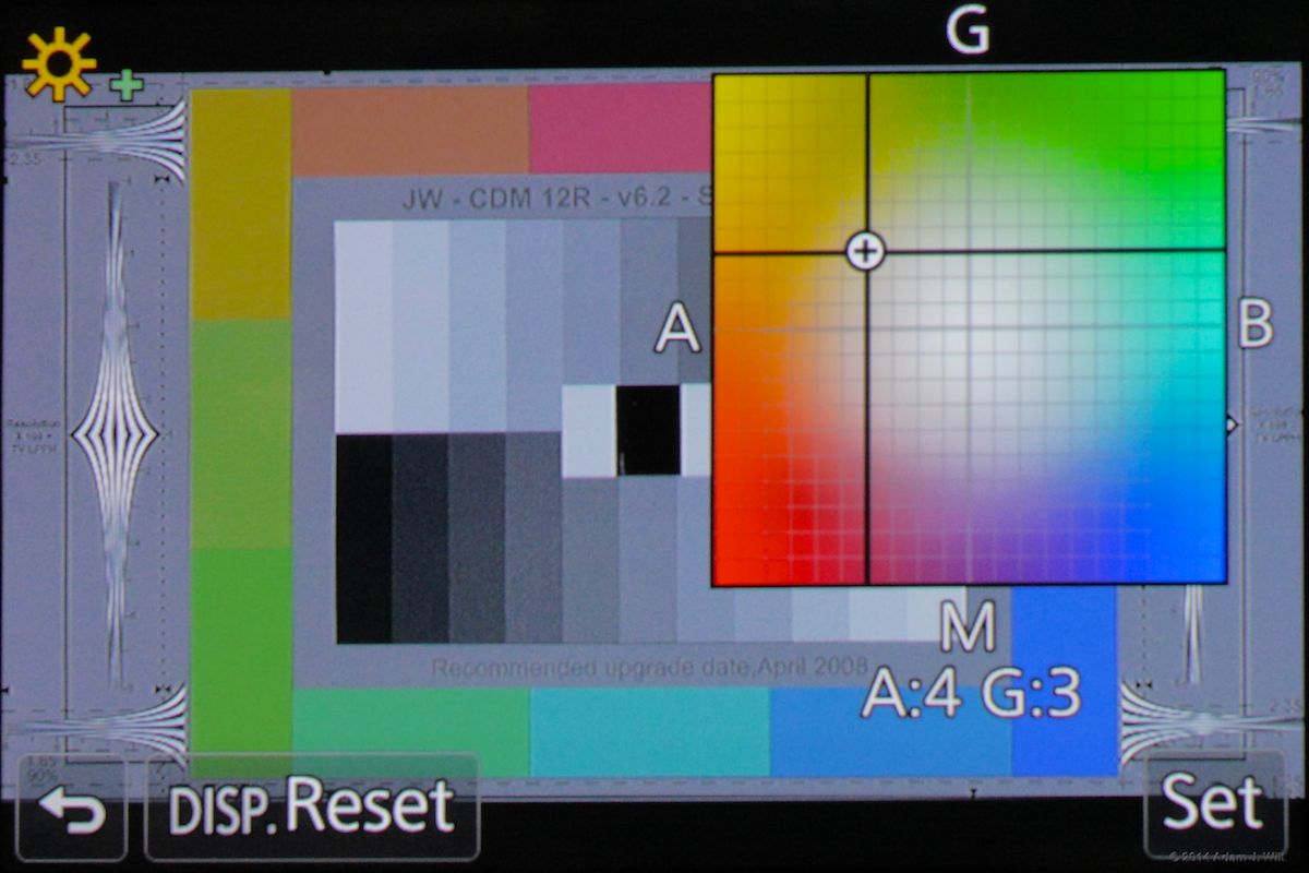

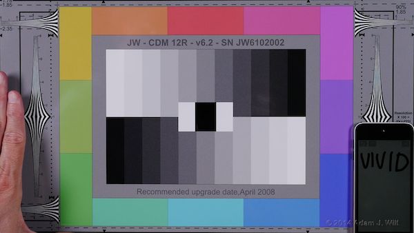

You can use any of several white balance presets, auto white balance, or dial in the color balance in degrees Kelvin. All settings allow fine-tuning in both amber/blue and green/magenta axes:

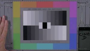

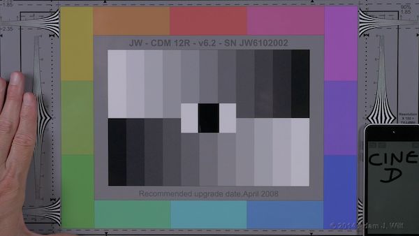

The camera has a raft of built-in looks, most of them familiar to users of other GH-series cameras, and two – Cine D and Cine V – that will gladden the hearts of DVX and HVX-series users. Here are most of ’em, with default parameters (no added image tweaks):
The good news is that all these looks are clean; none appear to show any untoward reaction to overexposure (in particular, the nasty, nuclear secondaries evident in the AF100’s Cine settings are nowhere to be found here). Going two stops over on any of the looks leads to, well, brighter pictures:
Push it futher and things will clip, but the clipping is relatively benign, with minimal veering of skintones to jaundiced yellow or skies to a bilious, atomic cyan; colors pretty much stay true to hue until they blow to featureless white. The GH4 is no Alexa, but for a camera with no knee control per se and no log curves, it’s sweet – and for a $1700 camera, it’s hard to beat.

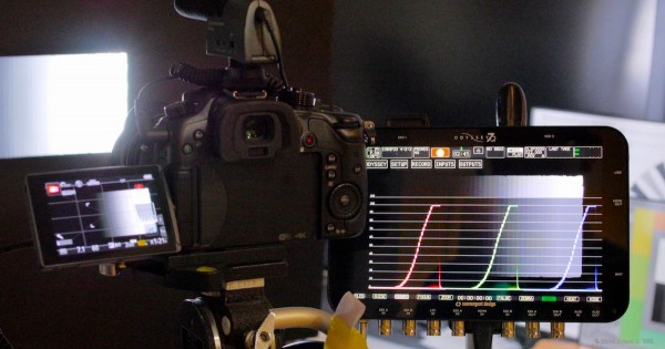

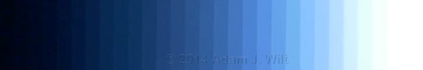

Here’s another test: the 13-stop Stouffer exposure wedge, driven into overexposure with a 6500K backlight but with the camera set to 3200K white balance:
The step wedges are 1/3 stop apart. Yes, in the last stop before clipping you’ll see a drift towards cyan, but it’s relatively mild and desaturated.
One surprise was how little highlight handling varied between looks: all of them clipped at exactly the same point, and all of them showed very similar color performance up to the clipping level. With earlier Panasonics, I had a clear preference for Cine V if overexposed skintones were the priority; on the Canon C300 I favor EOS STD as the look that holds up best if overexposed. On the GH4, all the looks acquit themselves equally well in this respect (aside from monochrome, which shows absolutely zero hue distortion, grin); I’d say pick the look you like the best, fiddle with its parameters to taste, and be done with it.
Consider: these are all Panasonic looks: they spring from a natural, unforced color rendering that many people find both realistic and pleasing. It’s hard to go seriously wrong with any of them.
In dynamic range testing, I was able to pull about 10 stops out of the picture, measured as the range from clipping down to the point where I could no longer see a clean division between 1/3-stop steps on the Stouffer wedge, when messing with gamma and black level in FCPX. [Update 14 June: I tested again with a DSC Labs Xyla chart, and found 11 stops or better in all looks. Details in a follow-up article later this month.] Some looks (Vivid; Cine V) showed nearly a stop less in the shadows. Without mucking about in FCPX, just looking at the raw clips, I saw anywhere from 6 1/3 stops (Vivid, Cine V) to 7 1/3 stops (Cine D) between clipping and the level where a Stouffer step merged with undifferentiated, inky black. So one way to look at it is that the GH4 has about 7 stops free and clear, and about 10 if you push it. Depending on your tolerance for noise in the shadows, you may choose to rate the camera anywhere in that range.

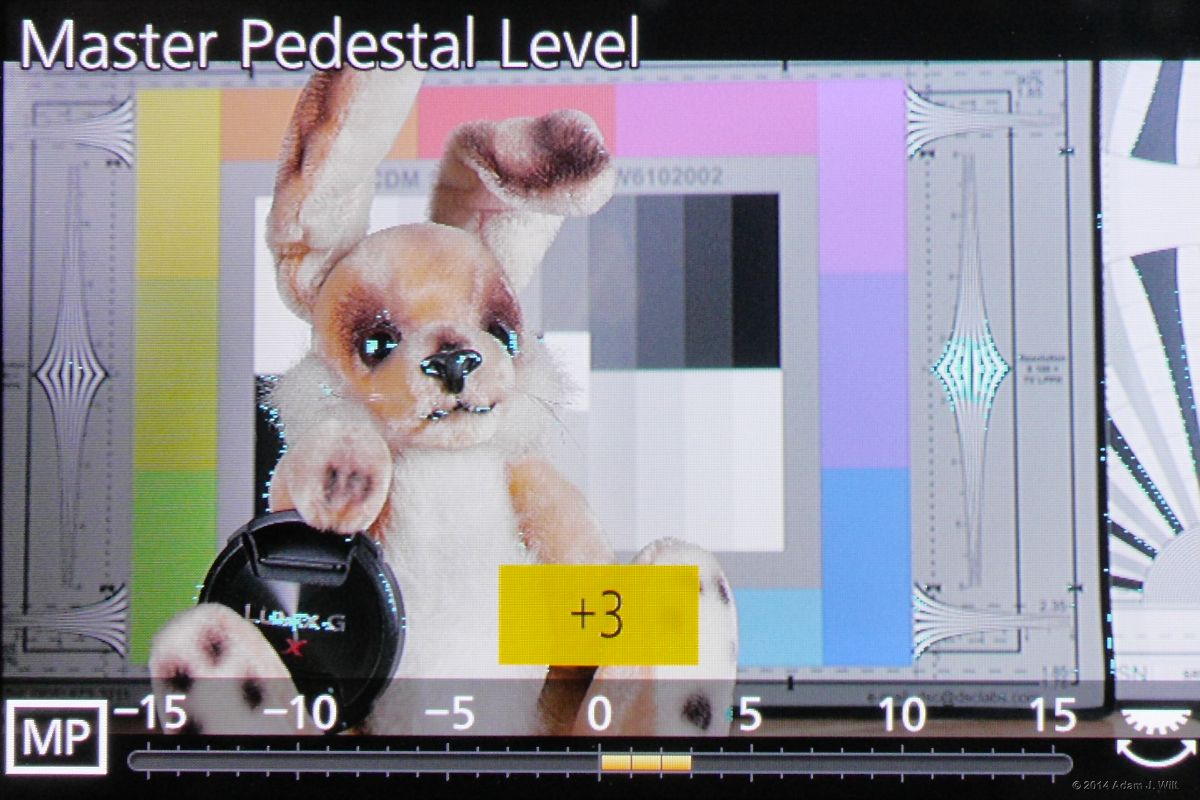

Mind you, the GH4 has all manner of tweaks: contrast, sharpness, master pedestal, and “highlights and shadows”, so these are only first-pass observations. It may be possible to coax more out of the shadows, and/or get even cleaner rolloff into overexposure… or it may not, of course. Panasonic seems to have done a very good job of optimizing defaults and ironing out kinks in the tonal curves; I wouldn’t be surprised to find I can do little to improve on the camera’s default setup.

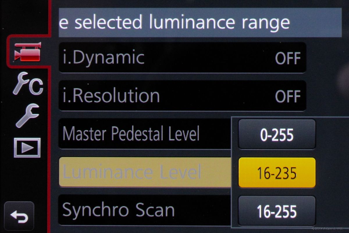

The data range in the files is settable to full-range, legal-range, or extended legal range (16-255):
This value also affects the HDMI output; I found that settings other than 16-235 clipped one or both ends of the tonal scale on pix sent out HDMI.

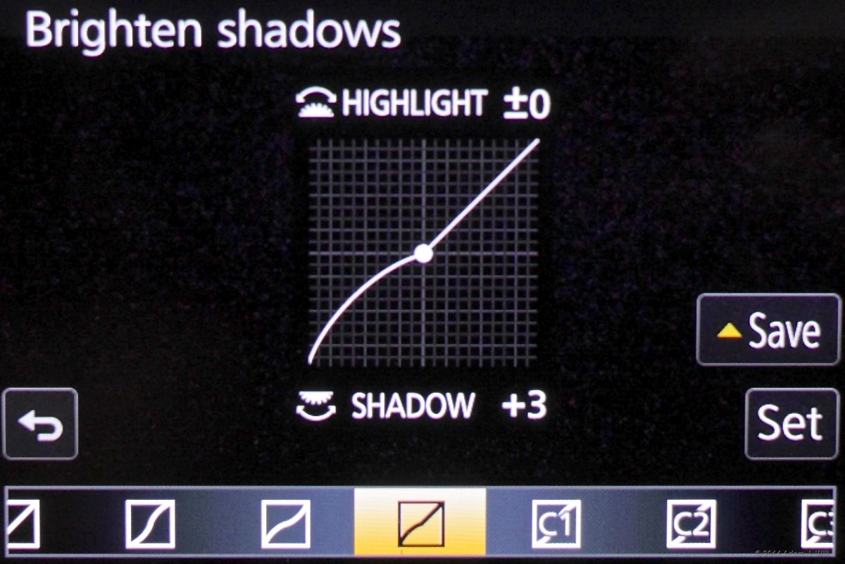

You can use the Highlights and Shadows menu to adjust the tone curve, varying the gamma (as it were) of the upper and lower halves of the tonal scale separately:
Presets are listed across the bottom; you can adjust any one and use it directly, or save it to one of three custom presets for later use.
