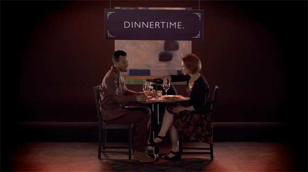

(1) The restaurant set. For some reason I always think of red in relation to restaurants. This might be because so many restaurants light their interiors with dim warm light, or lamps with red shades, or paint their walls red. It’s been shown that red not only stimulates the adrenal glands, making us hungrier, but it also makes us lose track of time–although I’m sure this has nothing to do with why we see red so often in restaurant interiors.
I had the choice of using red fill or red backlight. Red fill can make faces look ruddy, so I opted for red backlight instead. We had the choice of making it bright red or slight red, and in the end we opted for subtlety and mixed the red lights with white to desaturate them.

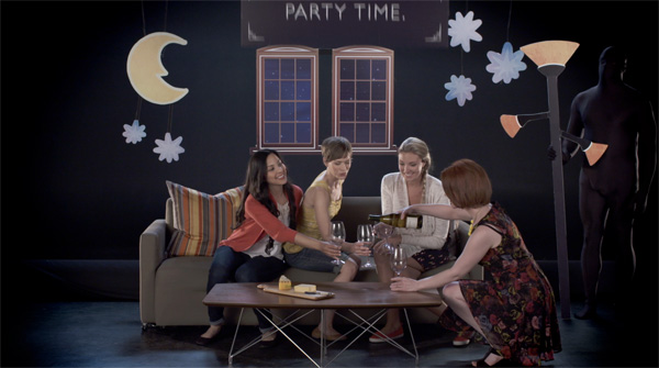

(2) The party set. Ian asked that the lighting be motivated by moonlight through the window, which to me said blue backlight and normal-colored fill.

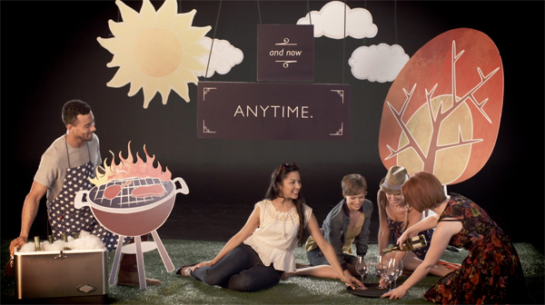

(3) The daylight BBQ set. Ian wanted a sunset look, and I toyed with the idea of making the backlight warm, but sometimes orange backlight looks more weird than sunny. Instead I opted to keep the backlight neutral and color the fill light, as if neutral sunlight were reflecting off warm straw or dirt. Colored fill can be subtle yet very convincing as shadows are rarely a neutral color: they are always illuminated by bounce light from some nearby object or surface that is rarely a perfectly flat white, and shadow color can act as a powerful trigger for mood.

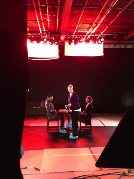

To make all this work I asked my regular gaffer, Alan Steinheimer, to build a backlight arrangement that was controlled by dimmers and would offer me the most flexibility possible. We arranged clusters of three lights across the back wall and left one light in each cluster white while gelling the others blue and red respectively. Having a white light as part of each cluster meant that I could either use the red or blue lights alone or, if the color was too intense, mix in some white light to reduce the overall color saturation.

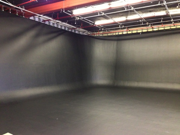

The trick was that the stage was going to be painted completely black, and although I asked for matte black paint I knew that paint is almost never free of shine. I expected all of my backlights to be visible as reflections in the surface of the floor.
Starting with a blank black stage is every DP’s dream. Sort of.
I also wanted my backlight to wrap around the actors. For these reasons I asked my lighting/grip crew to bounce the backlights into two 4’x8’ pieces of foam core suspended from the ceiling at the back of the set. By blending these point sources into a large wide bounce source their reflection in the floor looked more like a wash instead of individual light sources, and the backlight wrapped nicely around the actors’ faces and reflected beautifully in their hair.
Best boy electric Ernie Kunze rigs my “wall of backlight.”
The front fill was provided by a 12’x12’ clay coat bounce to the left of camera and a smaller 8’x8’ clay coat bounce to the right. The 8’x8’ was lit only with white light and remained at a fairly consistent level of brightness while the 12’x12’ to the left was lit by either a white open-face 2K or a 2K gelled with full CTO and ⅛ minus green. (My experience has shown that CTO can tip over into yellow-green depending on the camera and the colorimetry so I automatically add a little bit of minus green gel to pull it back from that green edge.)

On the left are my two 2Ks, one with CTO and 1/8 minus green for the BBQ scene’s warm bounce fill and one clean for the other scenes. To the left and right of frame you can see the 2K fresnel scratch lights at the back of the set. The soft box overhead is a backlight for the final product shot.
