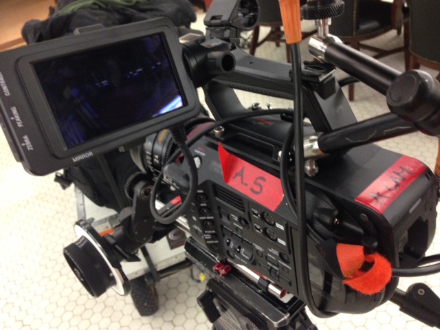

IMG_3788
One of my regular clients likes shooting with Canon C300s: they’re small, cheap and great for doc-style shooting, which is what we do for one particular corporate client. This time, though, the client asked for slow motion, and while the C300 will shoot 60fps it only does so at 720p. As this project is to be shown on a large screen at a huge company event our minimum shooting resolution was 1080p.

I love this camera for handheld work. It weighs a smidge more than an F5 but it takes small EX3-sized Sony batteries instead of bricks, which reduces weight considerably. This project required both handheld and Movi work and the FS7 was the lightest professional camera available that could capture high speed.
While we had third party handheld support for the camera, along with an EasyRig for use with the Movi, I found I never used more than the Sony-supplied shoulder pad and handgrip. This may have been due to the fact that I didn’t use an external monitor, relying instead on Sony’s stock LCD display. We used a round metal clip-on lens shade instead of a matte box with our Zeiss Ultraprime lenses. I also eschewed a follow focus, opting instead to simply grab the lens barrel. This made the camera extremely lightweight and easy to shoot with for long periods of time.
The FS7 is a little heavier on its right side, and I’d heard reports that it pulled to the right in handheld use, but I never found this to be the case.
